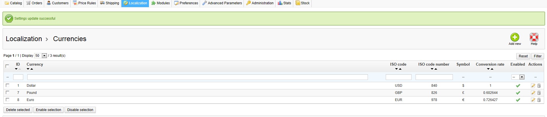

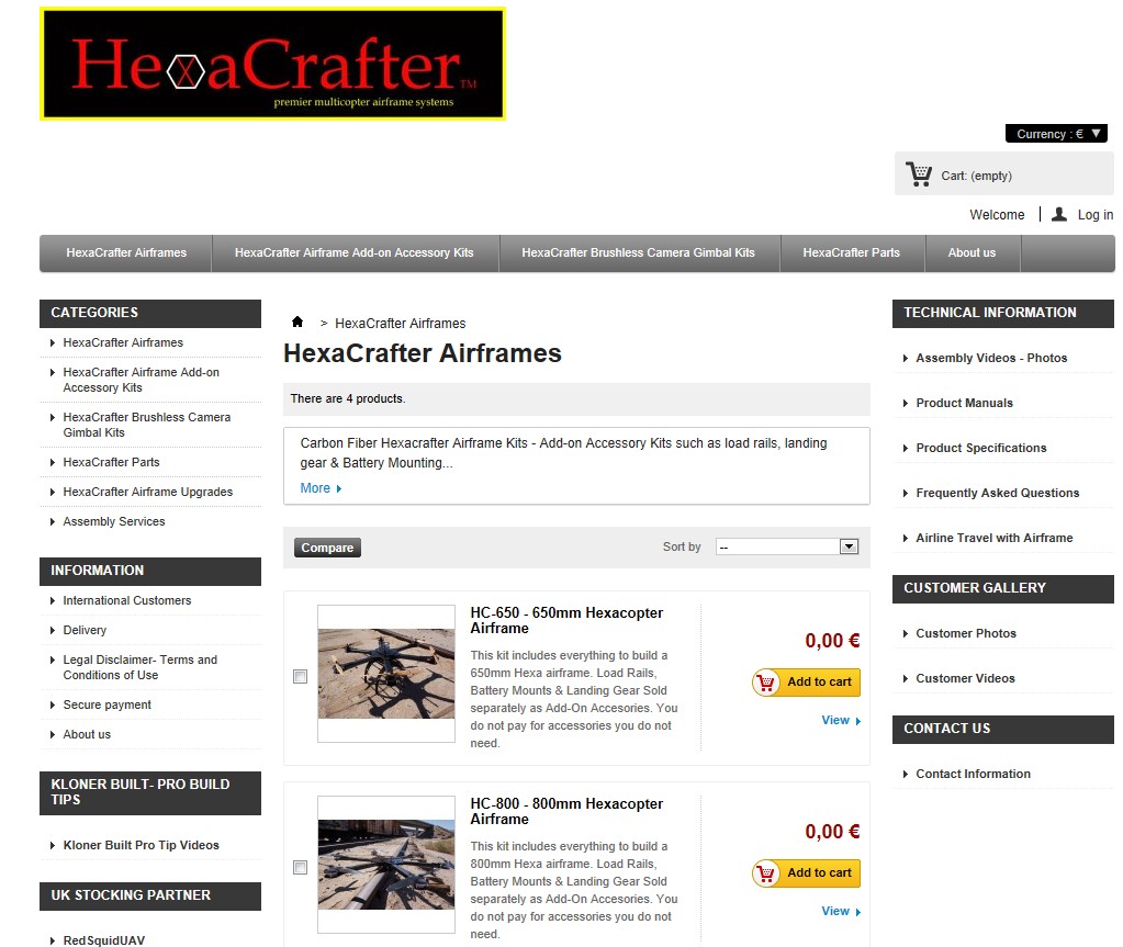

Hexacrafter Posted April 3, 2014 Share Posted April 3, 2014 My shop is set up with USD as default currency. I wish to also display GBP and Euro. I add the new currency as the non-default currency and all seems to be in order, they even show an exchange rate in the Localization> Currencies. When you go to the shop and look at the GBP or Euro price it shows 0.00.I manually set non default currency and the rate of .60. BUT when you go back into the edit currency, the currency still shows 0.0000 even though it was set to .60 and displays .60 in the main currency window. I think this is the BUG.... it is displaying on the website 0.00 as it is using the rate in the currency edit window (0.0000) as opposed to currency rate displayed in the main currency window.For now I have had to disable the GBP currency until I can get to to display the correct pricing (Not 0.00) on my website Any help would be greatly appreciated. Link to comment Share on other sites More sharing options...

Hexacrafter Posted April 3, 2014 Author Share Posted April 3, 2014 ElPatron commented: weird, when I look at your currency screen, it shows conversion, but when I edit the currency, it then shows 0.00. for now I would turn off gbp/euro until trouble shooting completed. but it would seem there is an issue with the mysql table. again, weird, but not same as auto/manual update creating 0.00 because it does show in your loc/currency... Link to comment Share on other sites More sharing options...

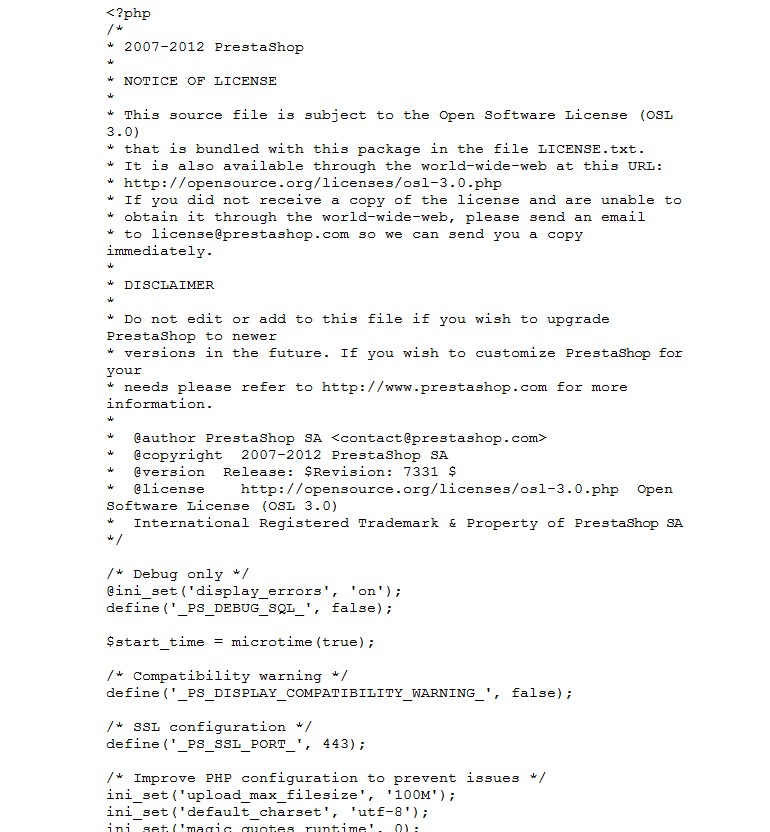

PrestaHeroes.com Posted April 3, 2014 Share Posted April 3, 2014 turn on errors then in back office update the exchange rate manuall, and save if no error click 'update currencies' also visit the front office and switch currencies. we are hoping there is an error that will help resolve, but i think most likely error will appear in back office. if you need help turning on errors: http://www.prestashop.com/forums/topic/224525-how-to-turn-on-error-reporting-for-debug-information/ Link to comment Share on other sites More sharing options...
Hexacrafter Posted April 3, 2014 Author Share Posted April 3, 2014 I have turned on the errors. Updated manually.... Updated automatically with "update currencies" I saw no errors when doing either in the front house or back of house..... You still have access....you can check for yourself. Please advise when you want me to turn off the error reporting. Link to comment Share on other sites More sharing options...
PrestaHeroes.com Posted April 3, 2014 Share Posted April 3, 2014 turn errors off as I don't have other idea...traveling so have limited access I will monitor and if I think of anything I will post here. Link to comment Share on other sites More sharing options...
