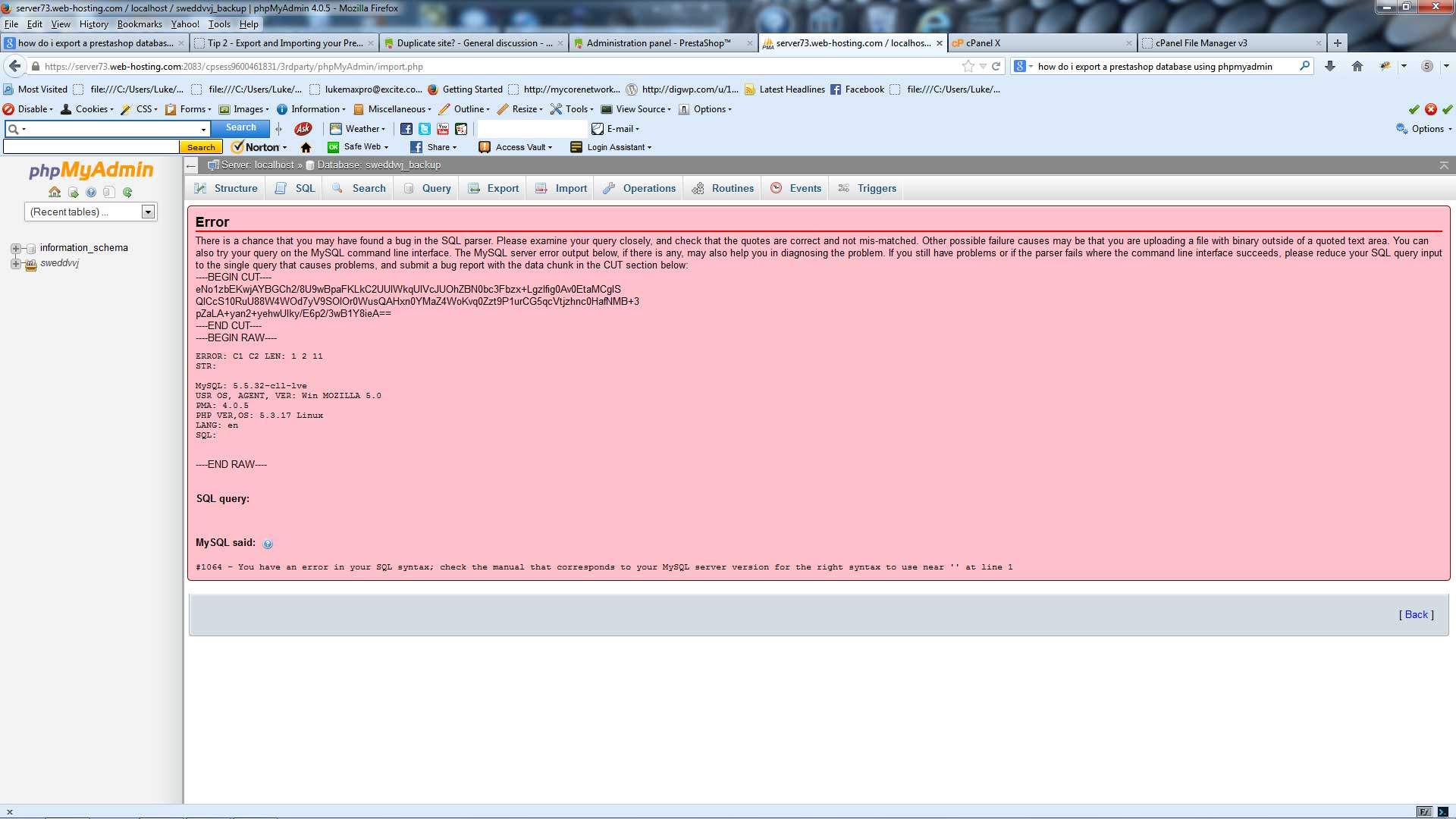

Luke_Urtnowski Posted January 15, 2014 Author Share Posted January 15, 2014 think I hit a stumbling block, followed http://www.howtomakeawebshop.com/tip-2-export-and-importing-your-prestashop-database-using-phpmyadmin/ to duplicate the database, but I get the attached error when I import it. Do you know why? Thanks... Link to comment Share on other sites More sharing options...
