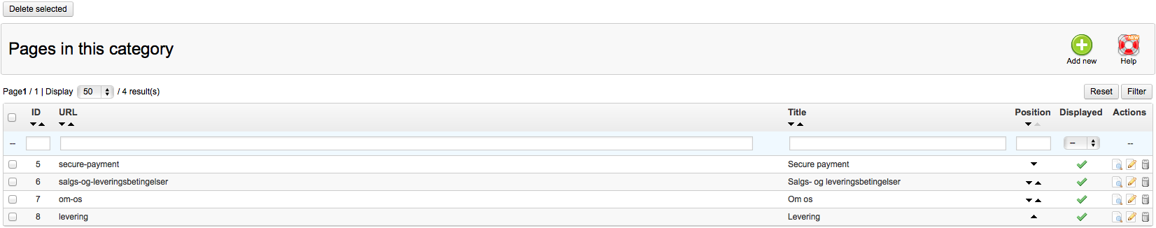

Christian Buch Posted December 2, 2013 Share Posted December 2, 2013 Hello, Running version 1.5.1 and my webshop is here: Link I have a problem when trying to edit or add CMS pages. I simply can't do it. I have CMS pages created long time ago and those are accessible from FO. However, when I click on CMS pages from BO i get a 404 - page not found. So seems like I have problems with my links but I can't find the error. I'm able to create a CMS page but it doesn't show in the front office and when clicking on it from BO it responds with a 404 - page not found. Any help will be highly appreciated. Link to comment Share on other sites More sharing options...
stottycabanas Posted December 2, 2013 Share Posted December 2, 2013 Hi Christian, An observation. In your screenshot, you have 3 icons under the Actions column on the far right. The first of these looks like a 'View' icon, often used when there is another level below the current one. The pages in question don't strike me as ones which would have another level below. My CMS pages work fine in BO and don't have these icons. Do you know why they are there? Also the screenshot only shows part of the page - it might help to see the rest of it with the CMS category/categories. Another thing - on your site, the links to the CMS pages listed in the Information block in the left column do not match the page names in your screenshot - well, 5 & 6 don't match although 7 & 8 do. Are all your translations OK? Don't know if any of that helps or not. Cheers, Dave Link to comment Share on other sites More sharing options...

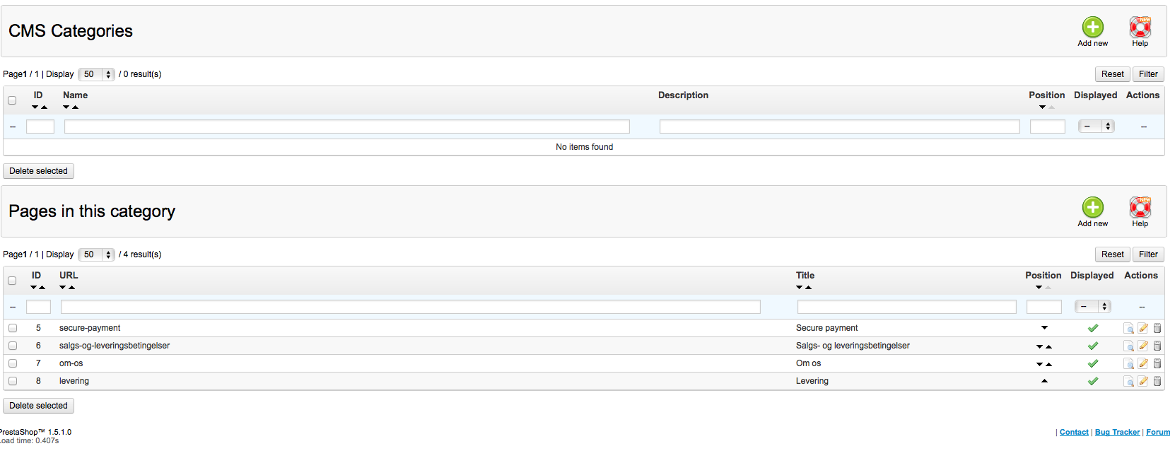

Christian Buch Posted December 3, 2013 Author Share Posted December 3, 2013 Hi Dave Thank you very much. You are absolutely right - that looks a bit odd. There is no deeper layer although there are 3 icons. When I click the 'View' icon it goes directly into the FO and returns with a 404 page not found. Also I can confirm your observations that the CMS pages in the FO doesn't match the links in the BO. I have no idea why? Do you know how I can check the translations for this? I've attached a screenshot with the CMS categories and pages. Link to comment Share on other sites More sharing options...
