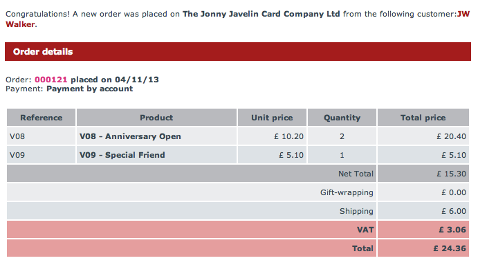

julian walker Posted November 5, 2013 Share Posted November 5, 2013 (edited) Hi El Patron I downloaded your updated mail alerts folder in order to add the tax line to the merchant new order email I am now getting this fault where the the unit price is being altered by the quantity instead of the Total price The Unit Price is £5.10 See below This does not affect the end calculation which is correct Can you help? Thanks Julian Edited November 5, 2013 by julian walker (see edit history) Link to comment Share on other sites More sharing options...
