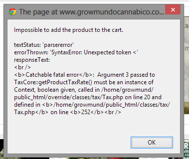

turdi Posted March 25, 2013 Share Posted March 25, 2013 (edited) Hello All, I have a big problem. This problem have been talked quite a few times, but I can't get it to work... I've tryed everything suggested on this forum: 1. Changing shop domain and SSL. First I had it as growmundocannabico.com (in both places, didn't work), changed to www.growmundocannabico.com and still didn't solve the problem. 2. Cleared coockies and all the browser history (firefox), didn't solve the problem. P.D. Doesn't work on other browser's as well. Tested on Chrome and IE10. 3. Tryed modifying .htcacess file, didn't help... P.S. In Firefox the login works, but add to cart doesn't. Here is the shop url: www.growmundocannabico.com I'm lost, please anyone. Help me ! I would give you access to the shop if needed. UPDATE: I have changed define('_PS_MODE_DEV_', false); to define('_PS_MODE_DEV_', true); in config/define.inc.php to show errors. And the result is in attachment. Can anyone explain me in simple why what does it mean and what I should do to fix it??? Because the programing is not my strong side. Edited March 25, 2013 by turdi (see edit history) Link to comment Share on other sites More sharing options...

PrestaHeroes.com Posted March 25, 2013 Share Posted March 25, 2013 for example one search of prestashop Catchable fatal error: Argument 3 passed to TaxCore::getProductTaxRate() shows this http://forge.prestashop.com/browse/PSCFV-5546 1 Link to comment Share on other sites More sharing options...
turdi Posted March 25, 2013 Author Share Posted March 25, 2013 I don't know where did the override came from... Should I delete it? Link to comment Share on other sites More sharing options...
PrestaHeroes.com Posted March 25, 2013 Share Posted March 25, 2013 I don't know where did the override came from... Should I delete it? what is the override you see and what post the code... if you delete make sure to back it up first Link to comment Share on other sites More sharing options...
turdi Posted March 25, 2013 Author Share Posted March 25, 2013 I've deleted the Tax.php file from Override folder and it solved the problem. One more question, I don't want to open new topic. Something strange is happening with the Tax, when nobody is logged in, the taxe is added and everything is ok. But when I log it the tax dissapears, why? 1 Link to comment Share on other sites More sharing options...
