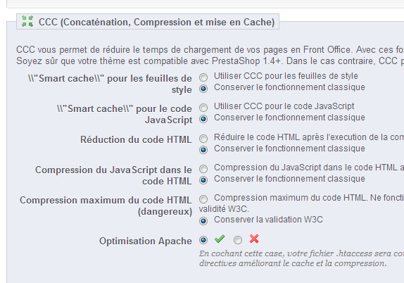

btsconsult Posted March 3, 2013 Share Posted March 3, 2013 Bonjour, Essaie de tout désactiver dans Performances (voir figure ci-dessous) 1 Link to comment Share on other sites More sharing options...
VOLEDA Posted March 3, 2013 Author Share Posted March 3, 2013 Bonjour, Encore un grand merci de ton aide ... J'ai tout désactivé et toujours pareil ... Link to comment Share on other sites More sharing options...
