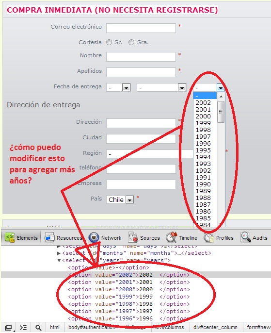

blackdroots Posted September 30, 2012 Share Posted September 30, 2012 Friends, I have searched all installation files and I can not find the solution. The "birthday" that has the fields "day", "month" and "year" I want to use as the delivery date. It turns out that the "year" extends only to 2002. My idea is to add more years to appear today and the years to come. Where I can modify this part? to add the years that I need to appear? It is in the part of "authentication" in the part of "immediate purchase" I'm using the 1.4.8 version of prestashop I attached a screen print clearly explaining what I do. I would appreciate a lot! The site I'm doing what you can see in www.deepdesign.cl/tienda1483 Link to comment Share on other sites More sharing options...
PrestaHeroes.com Posted September 30, 2012 Share Posted September 30, 2012 modify classes/tools.php public static function dateYears() { for ($i = date('Y') - 10; $i >= 1900; $i--) $tab[] = $i; return $tab; } change the -10 to a lower number including -0 1 Link to comment Share on other sites More sharing options...
