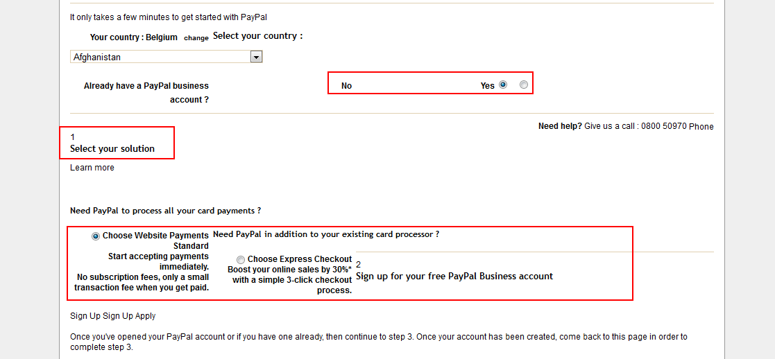

be_tnt Posted July 23, 2012 Share Posted July 23, 2012 (edited) All, I have installed from scratch the prestashop 1.4.8.2. i have enabled few modules like for example Paypal. When I wanted to configure it, I have notice that the layout was quite "not normal" (see attached picture). Looking in firebug, I have noticed many 404 errors like for example for /modules/paypal/js/jquery-1.7.2.min.js. In short for all files located in the paypal module folder, I got a 404. And this is not only for paypal. When I am on the page listing all the modules, I got a 404 for all icons that should be displayed next to each module name. All the "missing" files exists in module folders. Any idea of what could be the cause of this? Thx in advance. Edited July 23, 2012 by be_tnt (see edit history) Link to comment Share on other sites More sharing options...
