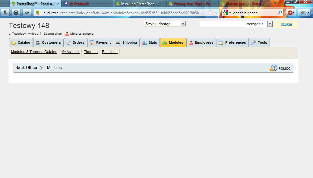

FrankP Posted May 15, 2012 Share Posted May 15, 2012 Just installed for testing and for commiting polish translation version 1.4.8.2 I did not installed anything - it is just raw installation with all modules. When i click Modules tab - modules doesnt appear. See att. Please help! Link to comment Share on other sites More sharing options...
ludo Posted May 15, 2012 Share Posted May 15, 2012 (edited) Hi FrankP I take your question to give you a little tips. Sometimes the "module page " goes into error and displays nothing apart from the header as in your example. In reality one (or more) generates an error that blocks the page. Using FTP and create a directory /modules_tmp and move all the modules in and reload the page module in the backoffice. The page should be normal (but without any module!). Then take several modules and move in /modules and reload the page. If it works is that the module is not guilty in those ... repeat again and again to isolate the module that crashes the page. Edited May 15, 2012 by ludo (see edit history) 1 Link to comment Share on other sites More sharing options...
FrankP Posted May 15, 2012 Author Share Posted May 15, 2012 Yeeeesss... I knew that it had to do with some module, couse when i installed one module in my existing shop - this same happened. I had to remove it then. I just thought that nothing like this could happen when installing "clean" version. Thanks Link to comment Share on other sites More sharing options...
FaTedev Posted May 15, 2012 Share Posted May 15, 2012 it is the "shipwire" module that kills it all, not found out why just yet too busy fixing other things. 1 Link to comment Share on other sites More sharing options...
FrankP Posted May 15, 2012 Author Share Posted May 15, 2012 (edited) Yep, the same by me. Shipwire. Im not a coder so i rather wont be able to fix it. There is 'blocktopmenu' 'blocksocial' 'blocksharefb' in modules folder, but it is empty. Anyone knows sth about it? Edited May 15, 2012 by FrankP (see edit history) Link to comment Share on other sites More sharing options...
bogdan89 Posted May 16, 2012 Share Posted May 16, 2012 To resolve the error you need to go to modules/shipwire/lib and edit ShipwireTracking.php on line 32 and replace require with require_once Link to comment Share on other sites More sharing options...
