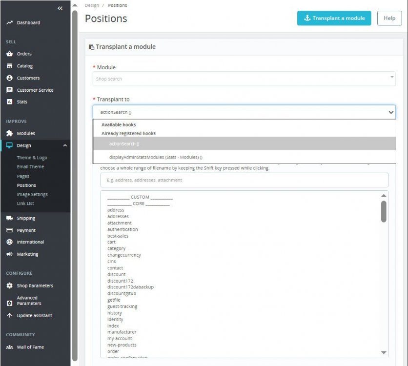

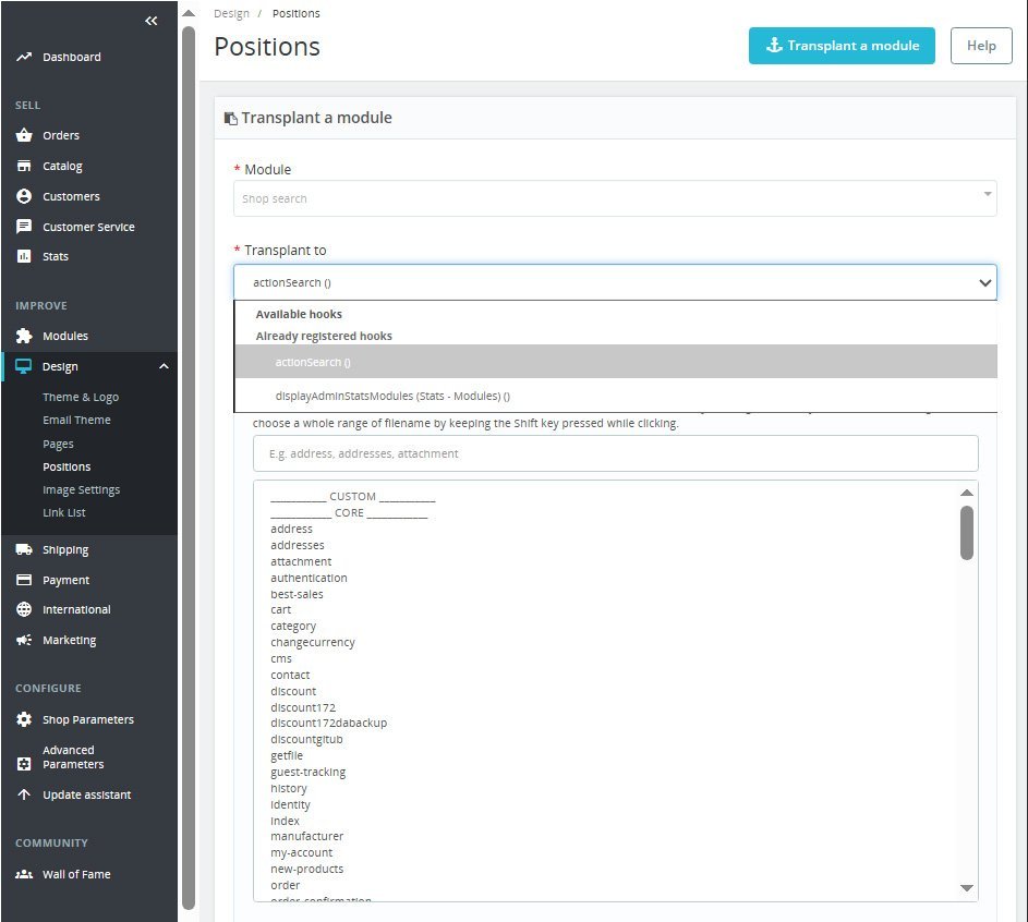

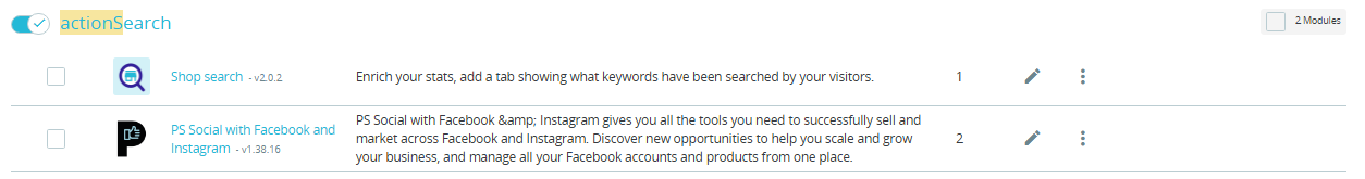

elly63 Posted November 29, 2025 Author Share Posted November 29, 2025 First, thanks for the quick response. Second, I checked the SHOP SEARCH 2.1 module's hooks as you wrote, and - the module is correctly connected to actionSearch. - it cannot be connected to displayHeader, which doesn't appear in the list of available hooks (img 2). Any other ideas? Link to comment Share on other sites More sharing options...

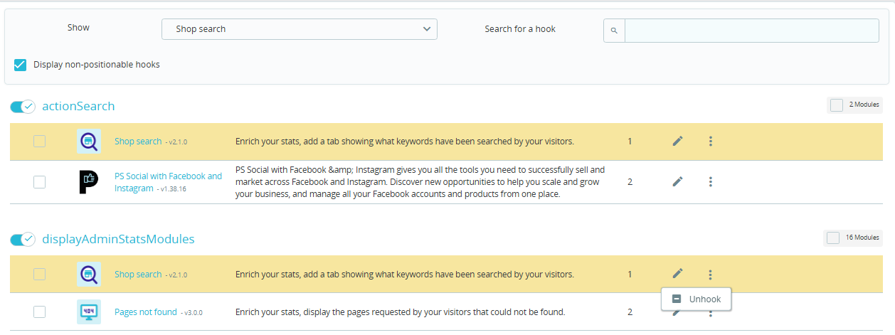

Andrei H Posted December 1, 2025 Share Posted December 1, 2025 Hello, displayHead is not needed. The statssearch module makes use only of the actionSearch and displayAdminStatsModule hooks Some things that you should watch for: 1. Check the `ps_hook` table and make sure that active is set to 1 for actionSearch. You can also add position 1 (to the same row) if it's not already set (SELECT * FROM `ps_hook` WHERE name = 'actionSearch';) 2. Make sure there are no overrides (or direct code changes) for controllers/front/listing/SearchController.php, src/Adapter/Search/SearchProductSearchProvider.php and modules/statssearch/statssearch.php. If there are, you should check the code for them in GitHub and make sure you are not touching the execution of the actionSearch hook 1 Link to comment Share on other sites More sharing options...

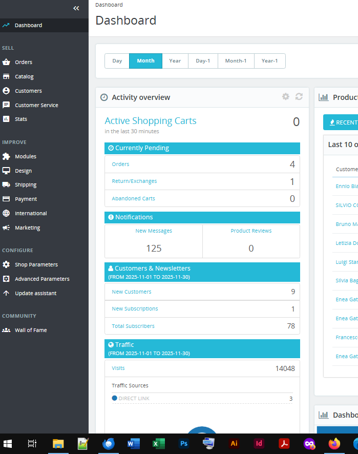

elly63 Posted December 1, 2025 Author Share Posted December 1, 2025 Hi Andrei, To be safe, I downloaded 8.2 from GITHUB and replaced the folders controllers/front/listing/ src/Adapter/Search/ modules/statssearch/ directly on the server. I cleared the cache. I ran a search from the front. But nothing, no writing to the ps_statssearch table. I'm attaching a screenshot of the BO where it seems that online users used to appear in addition to the 'active shopping carts'... maybe the problems are related. thanks Link to comment Share on other sites More sharing options...
elly63 Posted December 1, 2025 Author Share Posted December 1, 2025 (edited) ...`ps_hook` table: active is set to 1 for actionSearch YES ... no overrides ... Edited December 1, 2025 by elly63 (see edit history) Link to comment Share on other sites More sharing options...

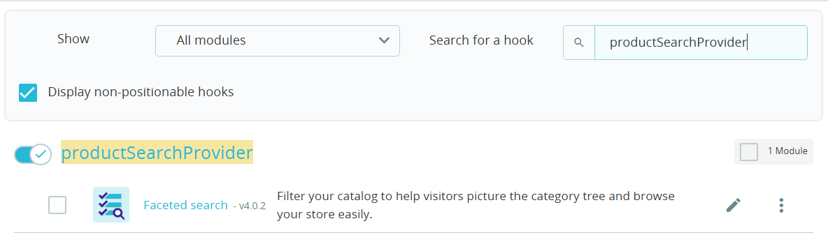

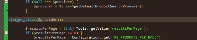

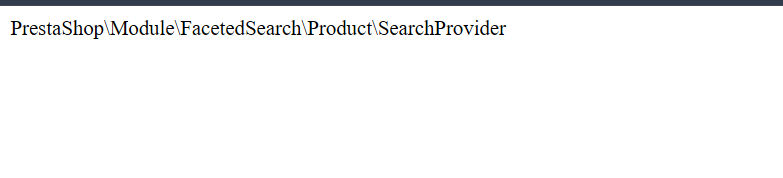

Andrei H Posted December 1, 2025 Share Posted December 1, 2025 Hello, Do you have any custom search modules installed? Or any module that implements the 'productSearchProvider' hook? Can you try the following: go to classes/controller/ProductListingFrontController.php and on line 317, add the following code: die(get_class($provider)); Then try and search something. When redirected to the search page, what are you seeing? Is it PrestaShop\PrestaShop\Adapter\Search\SearchProductSearchProvider? Link to comment Share on other sites More sharing options...
elly63 Posted December 1, 2025 Author Share Posted December 1, 2025 Link to comment Share on other sites More sharing options...
elly63 Posted December 1, 2025 Author Share Posted December 1, 2025 and finally i see this Link to comment Share on other sites More sharing options...
elly63 Posted December 1, 2025 Author Share Posted December 1, 2025 ps in the faceted search module i replace /modules/ps_facetedsearch/src/Hook/ProductSearch.php (line #54) if ($query->getIdCategory()) { with if ($query->getIdCategory() || $query->getSearchString()) { Link to comment Share on other sites More sharing options...
elly63 Posted December 1, 2025 Author Share Posted December 1, 2025 no sorry, the above change was undone with the update to 8.2.3 Link to comment Share on other sites More sharing options...
Andrei H Posted December 1, 2025 Share Posted December 1, 2025 (edited) Hello, Ok, this makes more sense now. In your ps_facetedsearch module's configuration, in the template used, you are most likely having Search (experimental) checked in the Pages using this template: section. The problem seems to be the fact that ps_facetedsearch does not execute the actionSearch hook. If you uncheck that option, the default search class will be used in the search page, and this class does implement the hook, so you should start seeing the search keywords inserted into that table. Edited December 1, 2025 by Andrei H (see edit history) 2 Link to comment Share on other sites More sharing options...

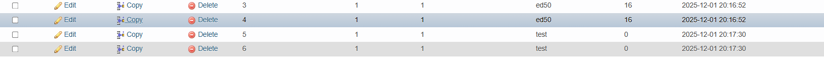

elly63 Posted December 1, 2025 Author Share Posted December 1, 2025 ..it even writes two lines for research now 🙂 it seems he has to make up for lost time 1 Link to comment Share on other sites More sharing options...

elly63 Posted December 1, 2025 Author Share Posted December 1, 2025 a, I understand, it writes lines every time you add text and give it time to preview the results... I type cia, it previews the results under the search bar, then I add "o" and it previews the results again, and it writes both the line with "cia" and "ciao." I don't know if I'm understandable, my English is googleenglish. Tomorrow I'll test with the code you told me and I'll let you know... now I'm exhausted... Link to comment Share on other sites More sharing options...

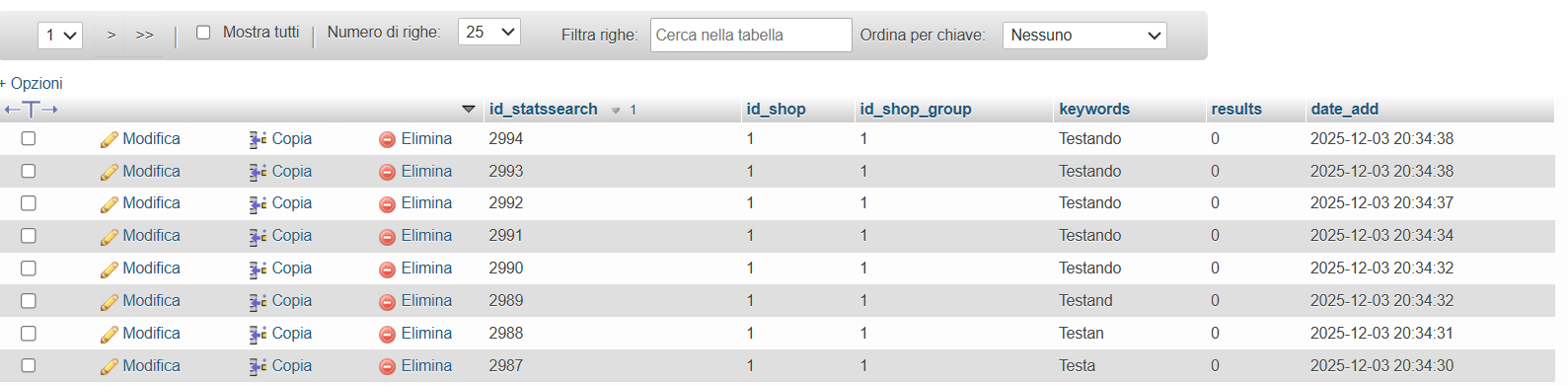

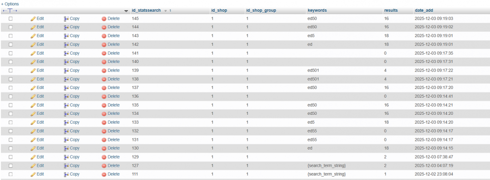

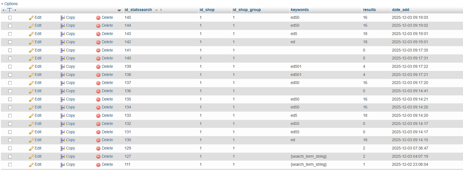

elly63 Posted December 3, 2025 Author Share Posted December 3, 2025 Hi, We've solved the writing problem in the ps_statssearch table, but I have a few considerations: - Between yesterday and today (24 hours), the table was populated with 5,000 rows. - Of these 5,000, after running DELETE FROM yourTableName WHERE yourColumnName IS NULL OR yourColumnName = ''; There are about 80 left. Now I'm trying to -modify statssearch.php with some if statements. -or insert a 'before triggers' statement in mysql so that it doesn't write rows with the keywords "" Link to comment Share on other sites More sharing options...

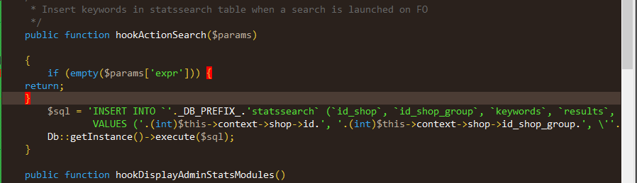

Andrei H Posted December 3, 2025 Share Posted December 3, 2025 Hello, That is weird. I tried added empty spaces in the search input and even search for that, but they are not inserted into the table Does adding the following code at the top of the hookActionSearch method, in statsearch.php, fix the issue? if (empty($params['expr'])) { return; } Link to comment Share on other sites More sharing options...
elly63 Posted December 3, 2025 Author Share Posted December 3, 2025 So, I inserted the code and it seems to work. Below are the images of the insertion and the DB with the blank lines before your change. Now I'll run the site through a bit and see... 👍🤞 Link to comment Share on other sites More sharing options...

elly63 Posted December 4, 2025 Author Share Posted December 4, 2025 Hi, Anyway, the code that writes ps_statssearch to the DB needs to be made smarter. Yesterday I did a search on the site I manage, and when I searched for "testando" in the DB, 8 lines were written in 8 seconds... and thank goodness I included the strlen if on the var ... I'm trying to implement some SQL triggers that will improve the situation... Maybe someone more knowledgeable on GITHUB will be able to make the module smarter... Ciao 😉 Link to comment Share on other sites More sharing options...
