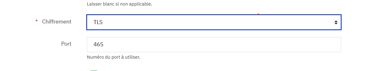

Thanks for the reply, but the thing is that if i put TLS andmake a test in the error I can ee that the url is still beginning with ssl:// as if it was harcoded somewhere and I do not have any module others than the native ones that could cae the issue , and sendmail would just not work anymore so I had to use an external smtp server which is no idea as it shouldall work fine by default but since we swapped to 9 emails stopped working as they should even on a fresh clean install, by default they do not work, and even with external smtp i have to send without encryption otherwise I get same issue, still see ssl:// by default in the error

Maybe you are affected by this bug!?
https://github.com/PrestaShop/PrestaShop/issues/36663
check last comment from hlavtox
Quote
I removed the $isTls forced parameter from the construct in classes/Mail.php and the error disappeared. And it seems to work with port 465 also. I think that the encryption can be removed from settings completely. It will automatically use the correct one depending on the port it seems.
$transport = (new EsmtpTransport( $smtpServer, $smtpPort )) ->setUsername($smtpLogin) ->setPassword($smtpPassword) ;
