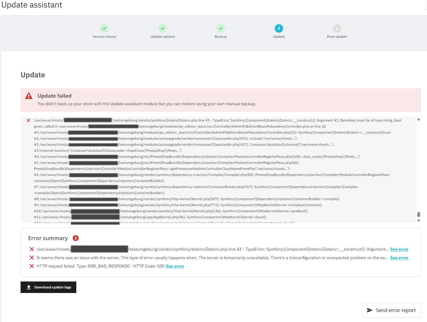

Chris_675 Posted August 25, 2025 Share Posted August 25, 2025 Hello, I received the following error while updating from v8.2.1 to 9.0.0: Quote /var/www/vhosts/%%%/testumgebung/vendor/symfony/dotenv/Dotenv.php line 43 - TypeError: Symfony\Component\Dotenv\Dotenv::__construct(): Argument #1 ($envKey) must be of type string, bool given, called in /var/www/vhosts/%%%/testumgebung/modules/ps_edition_basic/src/Controller/AdminPsEditionBasicPsAcademyController.php on line 32 bool instead of string? can I find and correct envKey? additional: Quote It seems there was an issue with the server. This type of error usually happens when: The server is temporarily unavailable. There's a misconfiguration or unexpected problem on the server. HTTP request failed. Type: ERR_BAD_RESPONSE - HTTP Code: 500 It seems as if the first mistake is the most serious one. The folders and files associated with ‘Dotenv’ are imported for the first time during the update and appear to be a new feature in version 9. My Serverconfig: Serverdaten Serverdaten Linux #1 SMP Thu Jun 1 16:49:27 UTC 2023 x86_64 Version der Server-Software Apache PHP-Version 8.1.19 Speichergrenze 768M max_execution_time: 900 Upload (max. Dateigröße) 256M Datenbank MySQL-Version 8.0.26-16 MySQL-Server 127.0.0.1:3307 Tabellen-Präfix: ps_ MySQL-Engine MySQL MySQL-Treiber DbPDO Shop-Einstellungen PrestaShop-Version 8.2.1 Thanks for following help Link to comment Share on other sites More sharing options...
PrestaHeroes.com Posted August 25, 2025 Share Posted August 25, 2025 (edited) This isn’t a server/env var you need to “fix” — it’s a module incompatibility. below are 3 options What’s happening In PrestaShop 8.x, Symfony’s Dotenv constructor signature was: new Dotenv(false); // bool $usePutenv In PrestaShop 9 (Symfony upgraded), the constructor signature changed to: new Dotenv(string $envKey = 'APP_ENV', string $debugKey = 'APP_DEBUG'); The ps_edition_basic module still calls new Dotenv(false) (old style), so PHP throws: Argument #1 ($envKey) must be of type string, bool given That’s why you get the 500/ERR_BAD_RESPONSE. The Dotenv files being “new in v9” isn’t the issue—the module code is outdated for v9. 1) Disable the offending module Via FTP/SSH: rename the folder to disable it: modules/ps_edition_basic → modules/ps_edition_basic.DISABLED Clear cache Reload BO/FO. If it loads, you’ve confirmed the problem. 2. Patch the module (temporary) If you want to keep it active until there’s an update, edit: modules/ps_edition_basic/src/Controller/AdminPsEditionBasicPsAcademyController.php Around line ~32 you’ll see something like: use Symfony\Component\Dotenv\Dotenv; // ... $dotenv = new Dotenv(false); // old signature → breaks on PS 9 Change to either of these (both OK on Symfony used by PS 9): $dotenv = new Dotenv(); // simplest // or $dotenv = new Dotenv('APP_ENV', 'APP_DEBUG'); // explicit keys 3) Removing ps_edition_basic on PS 9 ps_edition_basic is tied to the “Basic Edition” experience and has had several PS-version quirks. On PS 9, it’s safe (and recommended) to uninstall/remove it if you’re not explicitly relying on its features. (note you can not uninstall it, in option 1 you can just rename it. Long term: update or remove ps_edition_basic for PrestaShop 9 compatibility. Edited August 25, 2025 by El Patron (see edit history) Link to comment Share on other sites More sharing options...
