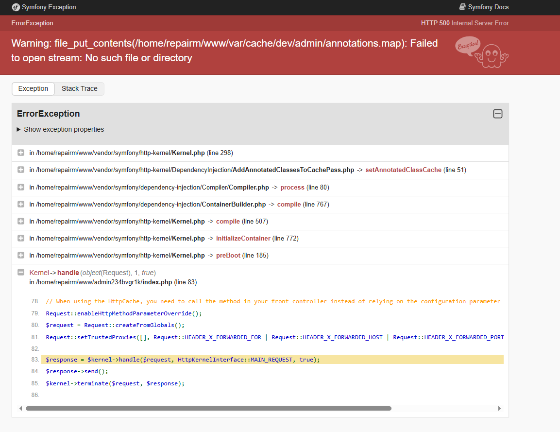

Curieux74 Posted August 20, 2025 Author Share Posted August 20, 2025 (edited) il y a 15 minutes, Eolia a dit : Activez le mode debug pour connaitre la raison de ces erreurs. https://help-center.prestashop.com/hc/fr/articles/9242063447698-Le-mode-debug Hello merci j'ai ça En version Texte au cas ou : Symfony Exception Symfony Docs ErrorException HTTP 500 Internal Server Error Warning: file_put_contents(/home/repairm/www/var/cache/dev/admin/annotations.map): Failed to open stream: No such file or directory ErrorException Show exception properties in /home/repairm/www/vendor/symfony/http-kernel/Kernel.php (line 298) in /home/repairm/www/vendor/symfony/http-kernel/DependencyInjection/AddAnnotatedClassesToCachePass.php -> setAnnotatedClassCache (line 51) in /home/repairm/www/vendor/symfony/dependency-injection/Compiler/Compiler.php -> process (line 80) in /home/repairm/www/vendor/symfony/dependency-injection/ContainerBuilder.php -> compile (line 767) in /home/repairm/www/vendor/symfony/http-kernel/Kernel.php -> compile (line 507) in /home/repairm/www/vendor/symfony/http-kernel/Kernel.php -> initializeContainer (line 772) in /home/repairm/www/vendor/symfony/http-kernel/Kernel.php -> preBoot (line 185) Kernel->handle(object(Request), 1, true) in /home/repairm/www/admin234bvgr1k/index.php (line 83) // When using the HttpCache, you need to call the method in your front controller instead of relying on the configuration parameterRequest::enableHttpMethodParameterOverride();$request = Request::createFromGlobals();Request::setTrustedProxies([], Request::HEADER_X_FORWARDED_FOR | Request::HEADER_X_FORWARDED_HOST | Request::HEADER_X_FORWARDED_PORT | Request::HEADER_X_FORWARDED_PROTO);$response = $kernel->handle($request, HttpKernelInterface::MAIN_REQUEST, true);$response->send();$kernel->terminate($request, $response); Edited August 20, 2025 by Curieux74 (see edit history) Link to comment Share on other sites More sharing options...
Eolia Posted August 20, 2025 Share Posted August 20, 2025 en FO vous avez surtout ce problème (Fatal error) Fatal error: Uncaught TypeError: CustomerFormatter::__construct(): Argument #1 ($translator) must be of type Symfony\Component\Translation\TranslatorInterface, PrestaShopBundle\Translation\TranslatorComponent given, called in /home/repairm/www/classes/controller/FrontController.php on line 1987 and defined in /home/repairm/www/override/classes/form/CustomerFormatter.php:22 Stack trace: #0 /home/repairm/www/classes/controller/FrontController.php(1987): CustomerFormatter->__construct(Object(PrestaShopBundle\Translation\TranslatorComponent), Object(Language)) #1 /home/repairm/www/classes/controller/FrontController.php(2009): FrontControllerCore->makeCustomerFormatter() #2 /home/repairm/www/controllers/front/OrderController.php(388): FrontControllerCore->makeCustomerForm() #3 /home/repairm/www/controllers/front/OrderController.php(141): OrderControllerCore->buildCheckoutProcess(Object(CheckoutSession), Object(PrestaShopBundle\Translation\TranslatorComponent)) #4 /home/repairm/www/controllers/front/OrderController.php(105): OrderControllerCore->bootstrap() #5 /home/repairm/www/classes/controller/Controller.php(319): OrderControllerCore->postProcess() #6 /home/repairm/www/classes/Dispatcher.php(487): ControllerCore->run() #7 /home/repairm/www/index.php(78): DispatcherCore->dispatch() #8 {main} thrown in /home/repairm/www/override/classes/form/CustomerFormatter.php on line 22 dans /home/repairm/www/override/classes/form/CustomerFormatter.php, donc override ajouté par un module non-conforme. Link to comment Share on other sites More sharing options...
Curieux74 Posted August 20, 2025 Author Share Posted August 20, 2025 il y a 2 minutes, Eolia a dit : en FO vous avez surtout ce problème (Fatal error) Fatal error: Uncaught TypeError: CustomerFormatter::__construct(): Argument #1 ($translator) must be of type Symfony\Component\Translation\TranslatorInterface, PrestaShopBundle\Translation\TranslatorComponent given, called in /home/repairm/www/classes/controller/FrontController.php on line 1987 and defined in /home/repairm/www/override/classes/form/CustomerFormatter.php:22 Stack trace: #0 /home/repairm/www/classes/controller/FrontController.php(1987): CustomerFormatter->__construct(Object(PrestaShopBundle\Translation\TranslatorComponent), Object(Language)) #1 /home/repairm/www/classes/controller/FrontController.php(2009): FrontControllerCore->makeCustomerFormatter() #2 /home/repairm/www/controllers/front/OrderController.php(388): FrontControllerCore->makeCustomerForm() #3 /home/repairm/www/controllers/front/OrderController.php(141): OrderControllerCore->buildCheckoutProcess(Object(CheckoutSession), Object(PrestaShopBundle\Translation\TranslatorComponent)) #4 /home/repairm/www/controllers/front/OrderController.php(105): OrderControllerCore->bootstrap() #5 /home/repairm/www/classes/controller/Controller.php(319): OrderControllerCore->postProcess() #6 /home/repairm/www/classes/Dispatcher.php(487): ControllerCore->run() #7 /home/repairm/www/index.php(78): DispatcherCore->dispatch() #8 {main} thrown in /home/repairm/www/override/classes/form/CustomerFormatter.php on line 22 dans /home/repairm/www/override/classes/form/CustomerFormatter.php, donc override ajouté par un module non-conforme. Re Quelle solution svp Sinon je vous et Mp Cordialement Stéphane, Link to comment Share on other sites More sharing options...
Eolia Posted August 20, 2025 Share Posted August 20, 2025 si vous ouvrez ce fichier (/home/repairm/www/override/classes/form/CustomerFormatter.php) vous aurez le nom du module responsable au début du fichier, donc vous pourrez le désactiver et contacter son auteur pour qu'il le corrige. Link to comment Share on other sites More sharing options...
