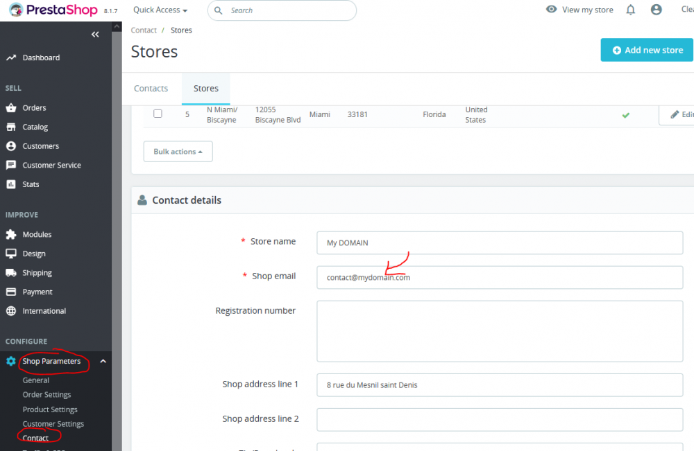

The
il y a 9 minutes, Marcofavaretto a dit :
Error: Please check your configuration
Expected response code 250 but got code "550", with message "550 5.1.0 p67DuN4geD5sdp67Du8wjC - Mittente non consentito / Sender not allowed ( mail from ) "
Even with email domain name mydomain.com, smtp username [email protected] and smtp password mypassword
The sender (ie in Shop parameters / Contact must be the same) sample with smtp user [email protected]
  • Like 1
16 hours ago, Prestashop Addict said:
The
Issue partially solved
