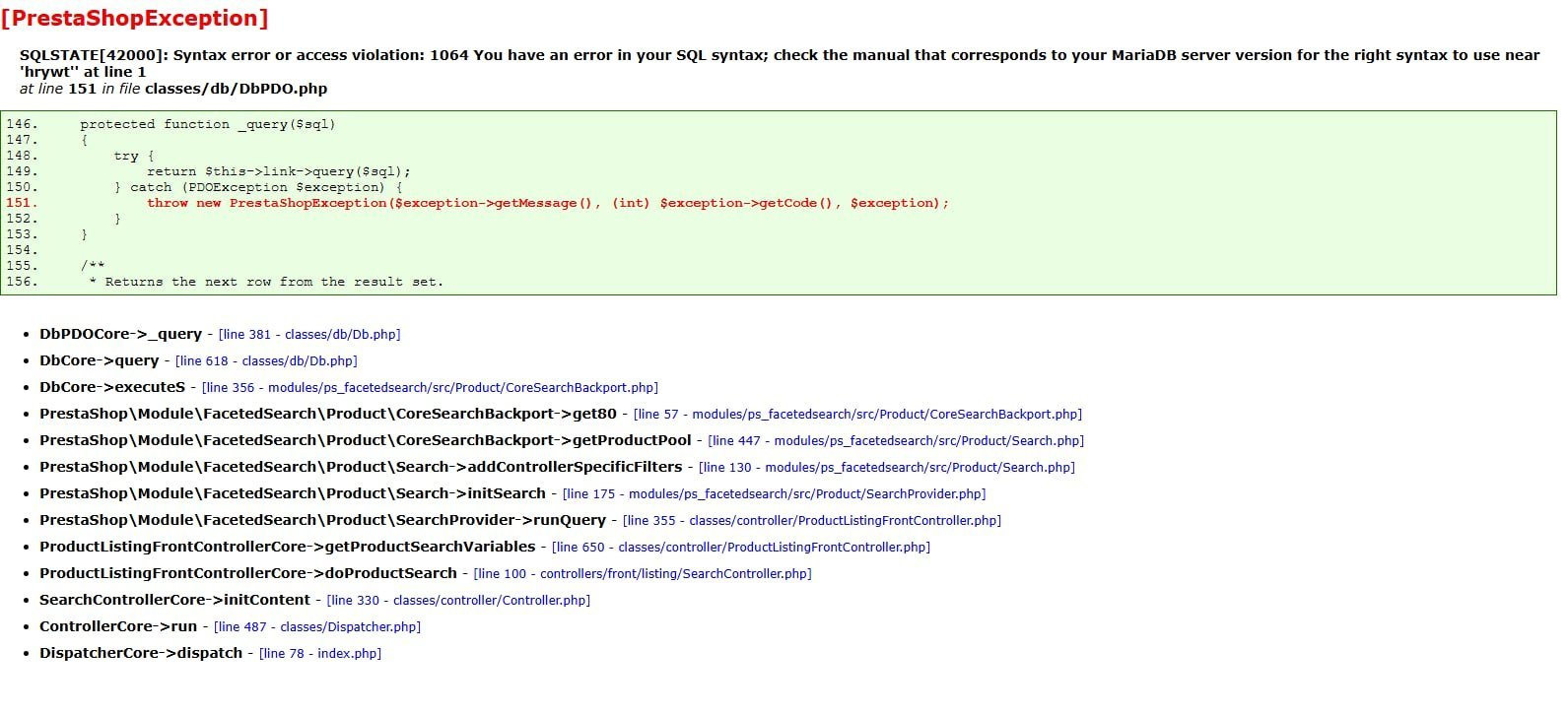

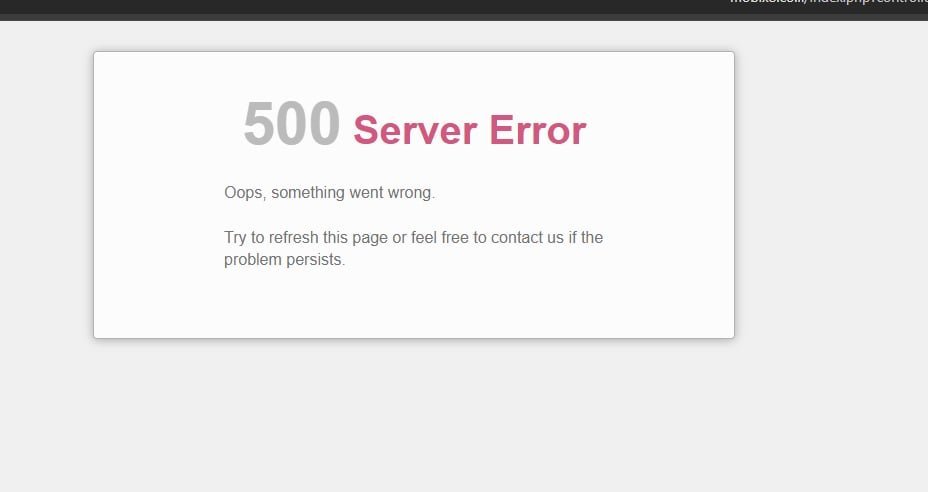

EagleTM Posted August 18, 2025 Share Posted August 18, 2025 Hello everyone, I have a PrestaShop system version 9.0. For some reason every search module I installed when searching for specific phrases has an "ERROR 500" error (no blocked phrases were ever defined in the system). It should be noted that the search does not include any symbols, only letters. Link to comment Share on other sites More sharing options...

Mehdi Bourechka Posted August 19, 2025 Share Posted August 19, 2025 On 8/18/2025 at 4:22 AM, EagleTM said: Hello everyone, I have a PrestaShop system version 9.0. For some reason every search module I installed when searching for specific phrases has an "ERROR 500" error (no blocked phrases were ever defined in the system). It should be noted that the search does not include any symbols, only letters. Enable debug mode and repeat the search The 500 error comes from an internal PHP error and debug mode will show exactly which module or file is causing it Link to comment Share on other sites More sharing options...
EagleTM Posted August 21, 2025 Author Share Posted August 21, 2025 I found the source of the problem, thanks For anyone who encounters this problem in the future. In Settings --->Search there are blocked words by default. Link to comment Share on other sites More sharing options...
