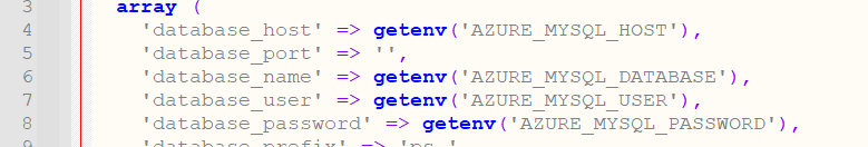

49 minutes ago, Paul C said:
Yes. The fact that mysqli calls works but Prestashop fails indicates that you need the pdo_mysql extension added to your php config.
If environment variables are working in the normal PHP script, then they will work on the PrestaShop configuration file as well. In that case, you can simply put the values i.e.
getenv('AZURE_MYSQL_HOST'), getenv('AZURE_MYSQL_USER') etc the Presashop configuration file i.e. app//config/parameters.php like

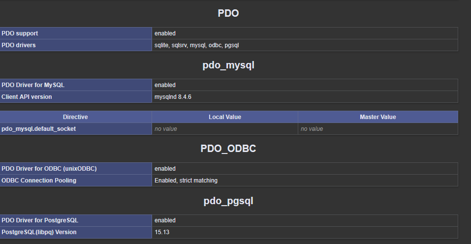

CHeck in the phpinfo() if the mysql_pdo extension is enabled on the server side ?
it looks like PDO is enabled, is this correct?

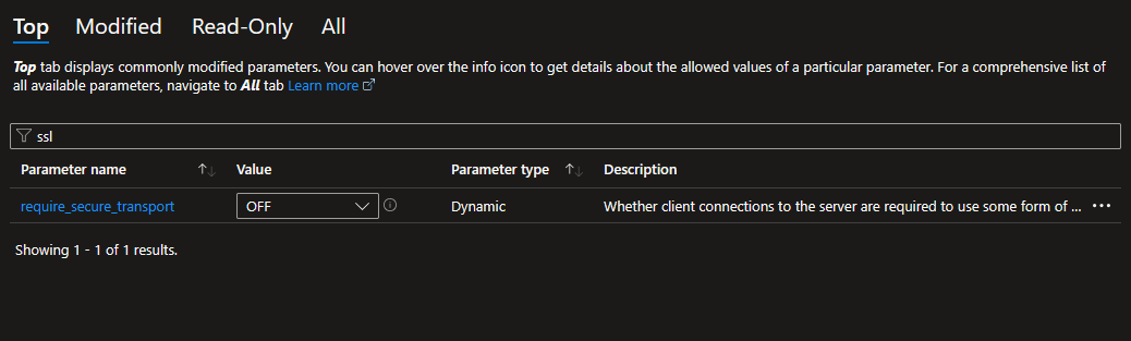

I was also able to use a sample php file to connect to the database and it worked, I had to remove SSL from the server configuration

I'm worried tho about having disabled SSL, how can I keep it enabled?

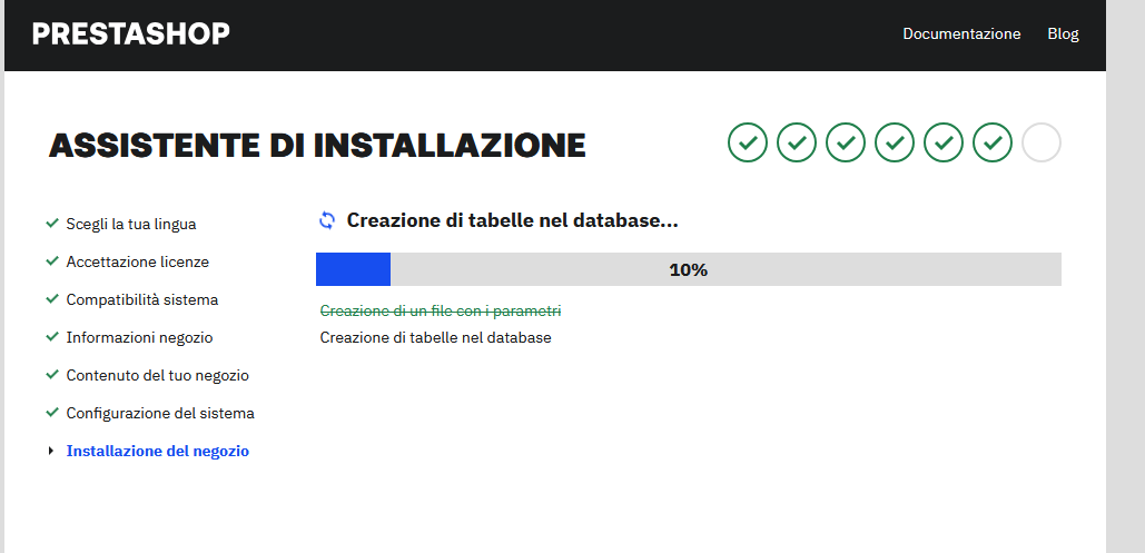

23 hours ago, rcitaliano said:
update... it failed the installation and it corrupted it :)
If you echo out those environment variables you're using in your test script, do the values exactly match what you're entering in the database fields during installation?
Can you share more details? What is corrupted?
If installation has started (As shared in the previous screenshot by you i.e. Creating tables with 10% progress), then it simply means the database connection is successful. There is something else.
Share the details of errors that are on screen OR from the error log file.
