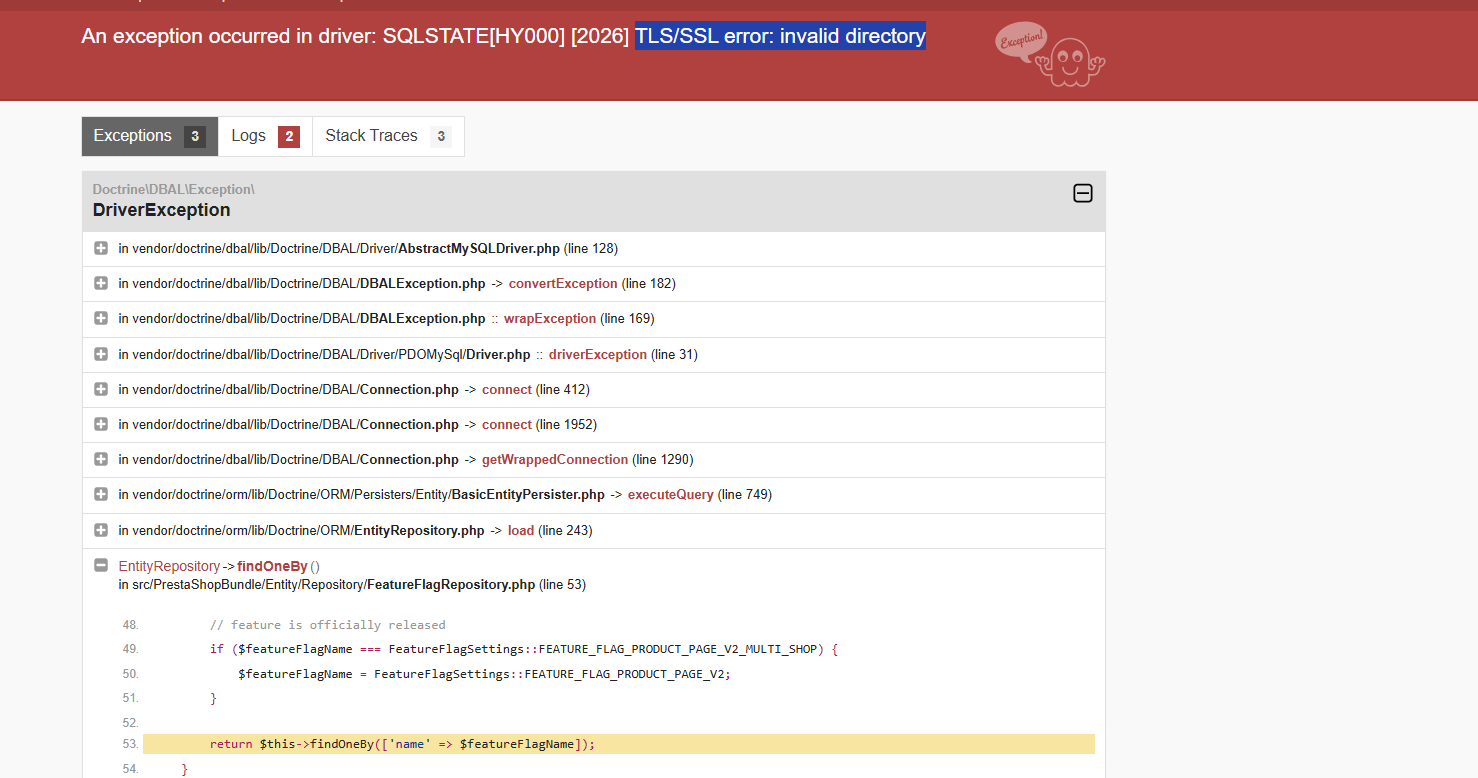

AK4 Posted June 30, 2025 Share Posted June 30, 2025 (edited) My Prestashop admin module has stopped working. This has been without setting changes and service provider confirmed no changes from their side. I initially got Oops 500 inernal server error. When running debug I get An exception occurred trying to figure out server_version. I have tried to set the DB version in doctrine.yml as suggested on forums. My db is MariaDB 11.4.7. I have tried a couple of setting and set version as mariadb-11.4.7 . I have also tried just as 8.0 (mysql version). However I am then getting another error : SQLSTATE[HY000] [2026] TLS/SSL error: invalid directory I am running Prestashop 8 Edited June 30, 2025 by AK4 (see edit history) Link to comment Share on other sites More sharing options...

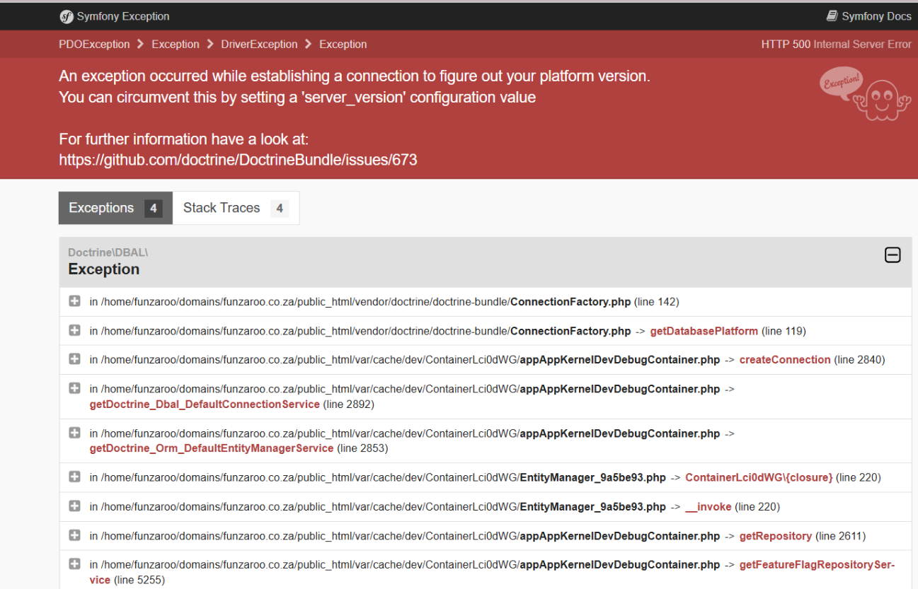

AK4 Posted June 30, 2025 Author Share Posted June 30, 2025 After adding the version: Link to comment Share on other sites More sharing options...
PrestaHeroes.com Posted June 30, 2025 Share Posted June 30, 2025 (edited) What could be happening? It's possible that your hosting upgraded mariadb, maybe this will help. reference: https://mariadb.com/docs/server/security/securing-mariadb/securing-mariadb-encryption/data-in-transit-encryption/securing-connections-for-client-and-server PrestaShop 8 uses Symfony/Doctrine to handle database connections. o With new MariaDB 11+ or some MySQL servers, Doctrine cannot detect your database version, so you see a "server_version" error. o When you try to fix that, you get a new error: SQLSTATE[HY000] [2026] TLS/SSL error: invalid directory. This means PrestaShop is trying to use SSL for the database, but your server or config is missing SSL info or files. How to fix it in PrestaShop 8: Edit your database config file: o The file to edit is: /config/packages/doctrine.yaml Add or update these settings under doctrine: dbal:(be careful with spaces/indentation): YAML files require exact spacing—use spaces, not tabs, and make sure each setting is lined up correctly under its parent. Incorrect indentation will cause errors or the settings to be ignored. For example, options: must be under dbal:, and 1007: false must be under options:. doctrine: dbal: driver: 'pdo_mysql' server_version: 'mariadb-11.4.7' # Or try 'mariadb-11.0' or just 'mariadb' options: 1007: false # disables SSL CA requirement (fixes TLS/SSL error) o The server_version line fixes the version detection error. o The options: 1007: false line disables the SSL CA requirement that causes the "invalid directory" error. Clear the PrestaShop cache: o Using the command line: php bin/console cache:clear o Or, manually delete everything inside: /var/cache/prod/ and /var/cache/dev/ Reload your admin page: o If you still get a "server_version" error, try changing the version to just mariadb-11.0 or mariadb but also contact your hosting company o If you still get an SSL error, double-check your spacing and that options: 1007: false is in place. contact your hosting company Edited June 30, 2025 by El Patron (see edit history) Link to comment Share on other sites More sharing options...
AK4 Posted July 1, 2025 Author Share Posted July 1, 2025 Thank you for the advise. The MariaDB setting definitely is working and applied. But even wtih 1007: false I still get the ssl error. I have checked spacing etc many times so very sure syntax is correct Link to comment Share on other sites More sharing options...
AK4 Posted July 1, 2025 Author Share Posted July 1, 2025 (edited) Service provider also not finding anything Edited July 1, 2025 by AK4 (see edit history) Link to comment Share on other sites More sharing options...
m2nis Posted August 24, 2025 Share Posted August 24, 2025 Hello, I faced exactly the same problem I think. My website was perfectly working, but impossible to access the back office. I can now access after applying this : 1013 -> 1016. Hope this will help. 1 Link to comment Share on other sites More sharing options...
ajin5522 Posted October 7, 2025 Share Posted October 7, 2025 This happens when Doctrine can’t detect your MariaDB version. In your doctrine.yml, add or update this line: server_version: "mariadb-10.6" Even though you’re running 11.4.x, Doctrine doesn’t yet support newer versions properly, so using 10.6 or 10.4 fixes the “server_version” exception. If you’re also getting the SQLSTATE[HY000] [2026] TLS/SSL error, it usually means the SSL cert paths in Prestashop’s config are invalid. You can disable SSL temporarily by editing your DB settings to remove or comment out SSL options, or set: PDO::MYSQL_ATTR_SSL_VERIFY_SERVER_CERT => false If it still fails after that, check for possible table corruption in your MariaDB database (sometimes after updates or restarts). You can use third-party tools like Stellar Repair for MySQL to scan and repair .frm and .ibd files. Link to comment Share on other sites More sharing options...
