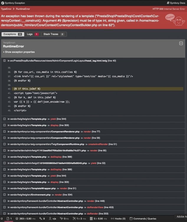

gigiscol Posted June 18, 2025 Share Posted June 18, 2025 Hello. I have updated Prestashop from 8 to 9, everything is working fine, the site looks good, but when you access the administrator (backend) it shows an error. An exception has been thrown during the rendering of a template ("PrestaShop\PrestaShop\Core\Context\CurrencyContext::__construct(): Argument #9 ($precision) must be of type int, string given, called in /public_html/src/Core/Context/CurrencyContextBuilder.php on line 62"). TypeError PrestaShop\PrestaShop\Core\Context\CurrencyContext::__construct(): Argument #9 ($precision) must be of type int, string given, called in /public_html/src/Core/Context/CurrencyContextBuilder.php on line 62 Anyone who can guide me to find the solution? Thank you PHP: 8.1 to 8.4 PS: 9.0.1 Link to comment Share on other sites More sharing options...
