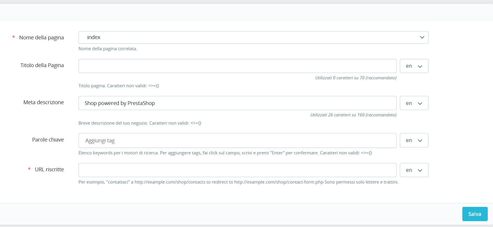

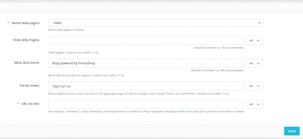

ale.pixel Posted June 4, 2025 Author Share Posted June 4, 2025 (edited) Hello El Patron, thanks for the answer! My website is a multistore and the steps are a little bit different from yours so I had to search for the "Set shop URL" section under Advanced Parameters - Multistore. I tried what you said until the url list of my pages under Traffic&SEO and I see that for the index page the rewrited url is empty. I saved it without editing but the trick didn't seem to work. I have also cleaned the cache as you suggested. I'm already using the Classic theme I have also tried the temporary workaround but I don't have that line on my FrontController.php. It might be different in PrestaShop 8.2.1 ? Just asking 🙂 I'm sadly stuck at the same point of before Edited June 4, 2025 by ale.pixel Forgot a detail (see edit history) Link to comment Share on other sites More sharing options...
PrestaHeroes.com Posted June 4, 2025 Share Posted June 4, 2025 In the image, you can see that for the “index” row the “Friendly URL” field is empty. You need to enter index (or another slug of your choice) here. Regenerate .htaccess and re-enable Friendly URLs • Still using the same shop context, navigate to Shop Parameters → Traffic & SEO. Because you have multistore enabled, these settings apply per shop. • Double-check that Domain, SSL domain, and Base URI exactly match what you set in the Multistore section (e.g. /it/ and /en/). • Scroll down to “Friendly URLs”: Disable Friendly URLs and click Save. Then enable Friendly URLs again and click Save. • This forces PrestaShop to rebuild the .htaccess file and recreate the URL rewriting rules for each language in that specific shop. Link to comment Share on other sites More sharing options...
