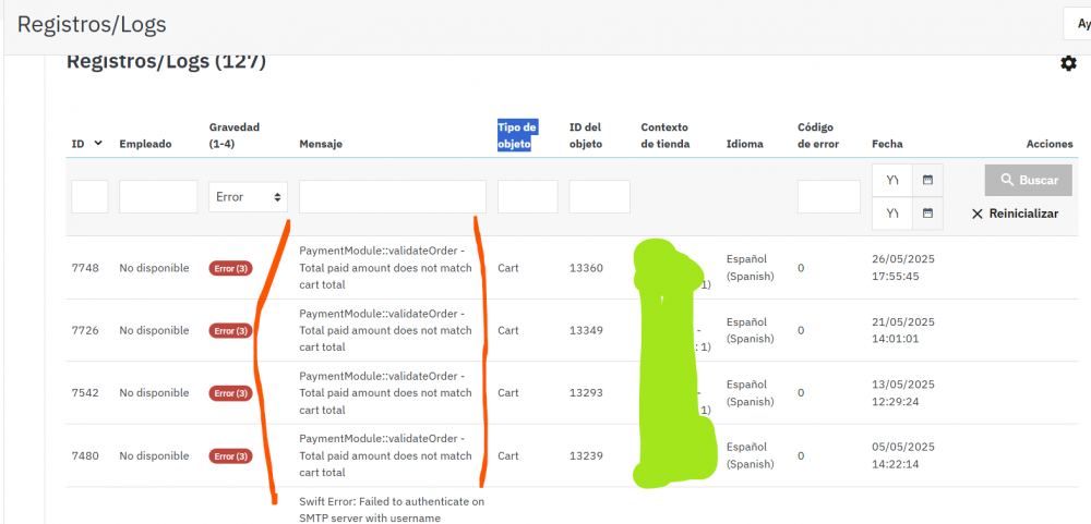

RONALDO54 Posted June 2 Share Posted June 2 Hello everyone. Reviewing the error log, I discovered this critical error occurred in the shopping cart in May: PaymentModule::validateOrder - Total paid amount does not match cart total Number of times this happened: 4 Order status: Payment error Object type: Cart Versión Prestashop: 8.1.5 Searching on Google I found nothing. Can anyone give me a hint as to where to look? Thanks. Link to comment Share on other sites More sharing options...

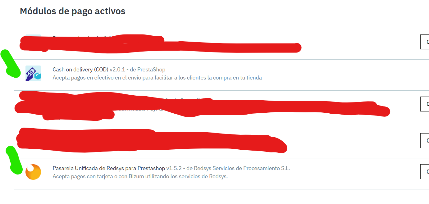

RONALDO54 Posted June 3 Author Share Posted June 3 Hello. Thanks for responding. The first error occurred with a bank transfer. The other three errors occurred with Cash on delivery. Bank transfer: Pasarela Unificada de Redsys Prestashop v1.5.2 - de Redsys Servicios de Procesamiento S.L. Cash on delivery (COD) v2.0.1 - de PrestaShop Link to comment Share on other sites More sharing options...
Webkul Solutions Posted June 3 Share Posted June 3 On 6/2/2025 at 8:23 PM, RONALDO54 said: Hello everyone. Reviewing the error log, I discovered this critical error occurred in the shopping cart in May: PaymentModule::validateOrder - Total paid amount does not match cart total Number of times this happened: 4 Order status: Payment error Object type: Cart Versión Prestashop: 8.1.5 Searching on Google I found nothing. Can anyone give me a hint as to where to look? Thanks. Hello, Please check the line code: https://github.com/PrestaShop/PrestaShop/blob/8.1.5/classes/PaymentModule.php#L330 The order status "Payment error" is set from here when the amount is different So please check both amounts here. Thanks, 1 Link to comment Share on other sites More sharing options...
