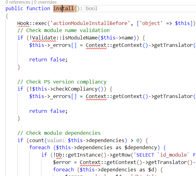

Knowband Plugins Posted May 31, 2025 Share Posted May 31, 2025 The module class has the install & uninstall functions. I think these function can also be used to reset he module. $module = Module::getInstanceByName($module_name); $module->uninstall() $module->install() Link to comment Share on other sites More sharing options...
