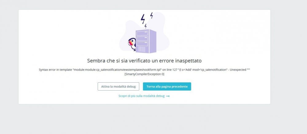

claudioverga Posted May 3, 2025 Share Posted May 3, 2025 ciao a tutti Ho appena installato PrestaShop 8.21 e ho installato un template. Quando apro un modulo del template, mi appare questo errore. per quale motivo mi da questo errore? saluti Link to comment Share on other sites More sharing options...
PrestaHeroes.com Posted May 3, 2025 Share Posted May 3, 2025 To fix it, edit this file: /modules/cp_salenotification/views/templates/hook/form.tpl And replaced this incorrect line on line 127: {l s='Add' mod='cp_salenotification'" With the corrected version: {l s='Add' mod='cp_salenotification'} Make sure the tag is properly closed and doesn't have unmatched quotation marks. After the fix: Clear the PrestaShop cache from Advanced Parameters > Performance > Clear Cache Or manually delete /var/cache/prod/ (or /dev/ if in dev mode) After making this change, the module loaded correctly and the error was resolved. Hope this helps someone facing the same issue! Link to comment Share on other sites More sharing options...
claudioverga Posted May 3, 2025 Author Share Posted May 3, 2025 grazie mille! cosa straordinaria è che sono riuscito a modificare la riga e adesso è tutto ok ... curiosità come hai fatto a verificare che il problema è stato risolto? hai lo stesso template? saluti Link to comment Share on other sites More sharing options...
