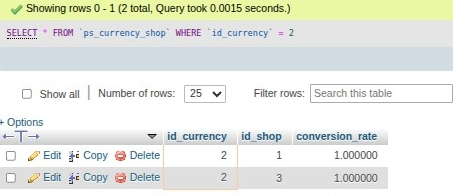

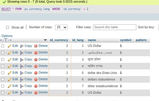

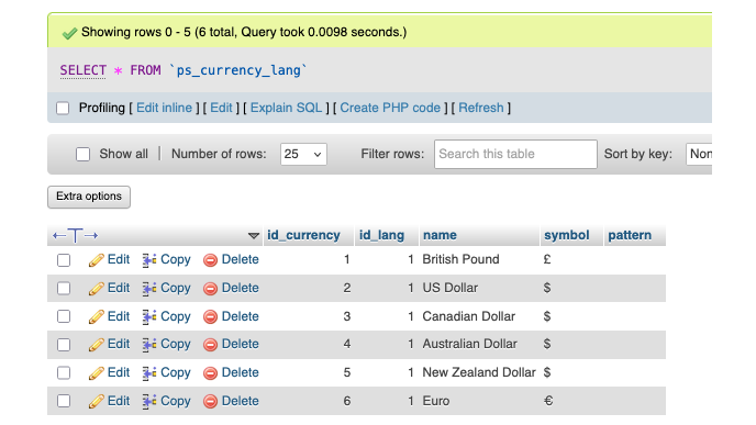

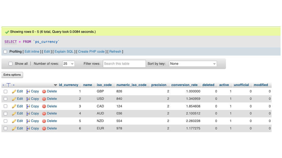

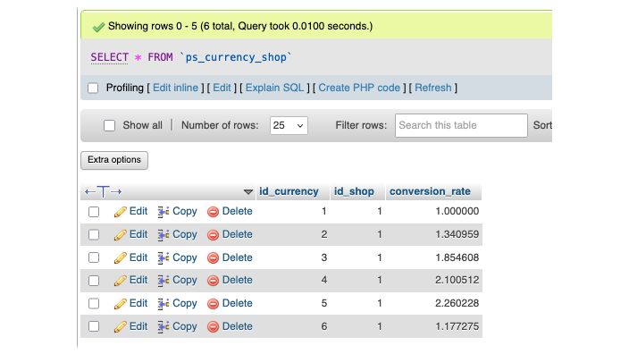

Millies Posted May 1, 2025 Author Share Posted May 1, 2025 I think that is already the case Attached three screen shots showing the same tables. Link to comment Share on other sites More sharing options...

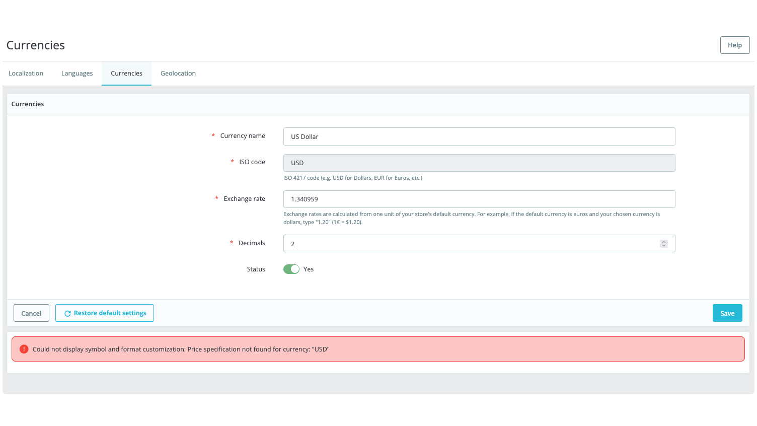

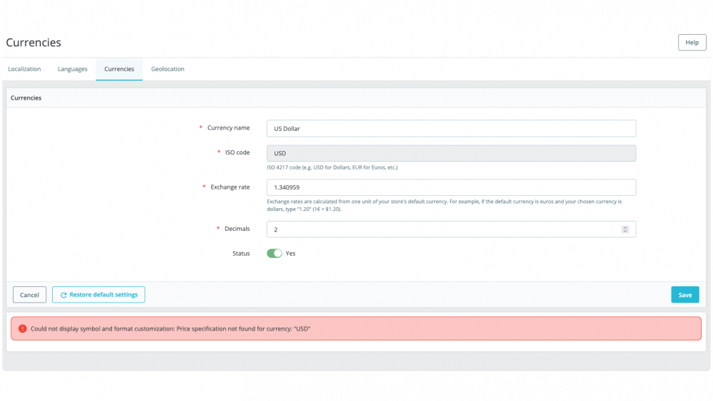

Millies Posted May 1, 2025 Author Share Posted May 1, 2025 Come up in a few places, will add more errors. Firstly shown on the currencies page. /index.php/improve/international/currencies/2/edit?_token=xxxxx Link to comment Share on other sites More sharing options...

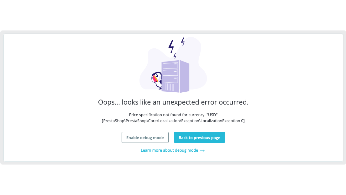

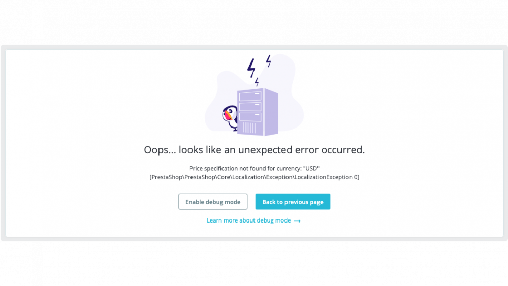

Millies Posted May 1, 2025 Author Share Posted May 1, 2025 When I disable debug mode and look at orders: /index.php/sell/orders/?_token=xx Link to comment Share on other sites More sharing options...
