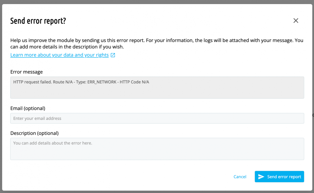

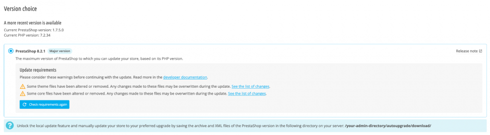

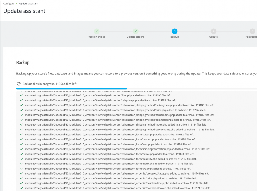

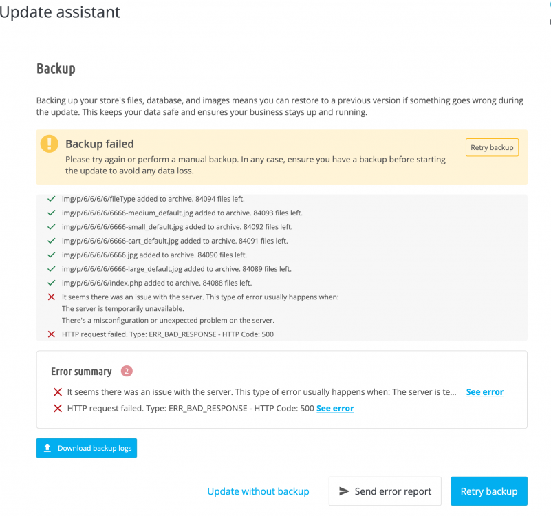

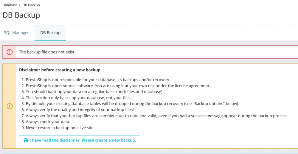

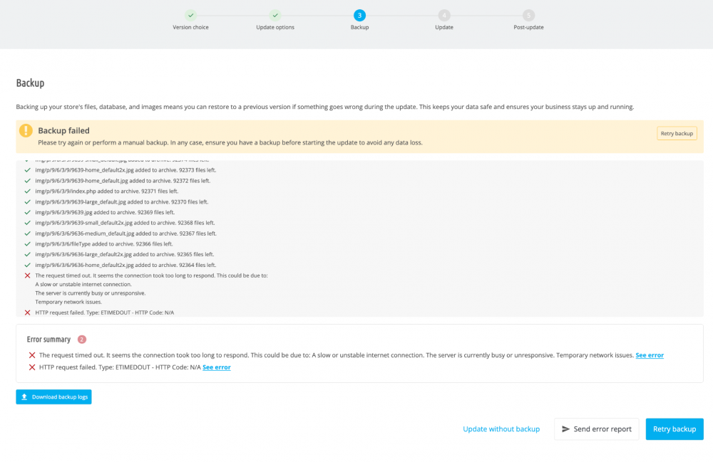

Dirt Surfer Posted April 28, 2025 Share Posted April 28, 2025 (edited) Hi there. I am trying to perform a store upgrade as I've been having trouble with the site lately. Something may be broken. For some reason, when I try to do a backup of the DB (Via DB Backup) I get an error "The backup file does not exist". I am not trying to restore from a previous, I just want to backup before performing the upgrade. I can't proceed I don't know how to progress from there, so I did a whole of host backup the other day for safety's sake and have downloaded for safekeeping. When I go over to Update Assistant, I select the one option available to me 8.2.1 and click through to backup from there. That all progresses for quite a while, then I get a couple of failures- see below. I am normally reluctant to progress the upgrade without backup, but perhaps too much is busted... What does the hive mind think? I'm kind of stuck. Suggestions and advice appreciated. Alan Edited April 29, 2025 by Dirt Surfer (see edit history) Link to comment Share on other sites More sharing options...

Webkul Solutions Posted April 29, 2025 Share Posted April 29, 2025 The issue you are experiencing could be related to the 'max_execution_time' in your php.ini file. By default, this value is set to 30 seconds. Which may not be sufficient for long processes. We recommend reaching out to your hosting provider to increase the 'max_execution_time'. They should be able to assist you with this adjustment quickly and easily. 1 Link to comment Share on other sites More sharing options...
El Patron Posted May 1, 2025 Share Posted May 1, 2025 webkul has great advice on max execution, I'll add that doing a 'manual' back up of db and files from hosting control panel is better method rather than using PS upgrade backup option. Link to comment Share on other sites More sharing options...
Dirt Surfer Posted May 1, 2025 Author Share Posted May 1, 2025 Hi again. Thanks WEBKUL, I increased to 'max_execution_time' and unfortuantely the error persevered. I tried to progress with the update (and sidestep of the prestashop backup process) but it was also thwarted. See LOG. The result was a very broken Prestashop. I had the host reinstate the entire hosting from .tar backup from a few days previously so I am back to where I was originally. ElPatron, it there a link you can share for performing a manual backup of DB from cPanel? 2025-04-30-123712-update.txt Link to comment Share on other sites More sharing options...
