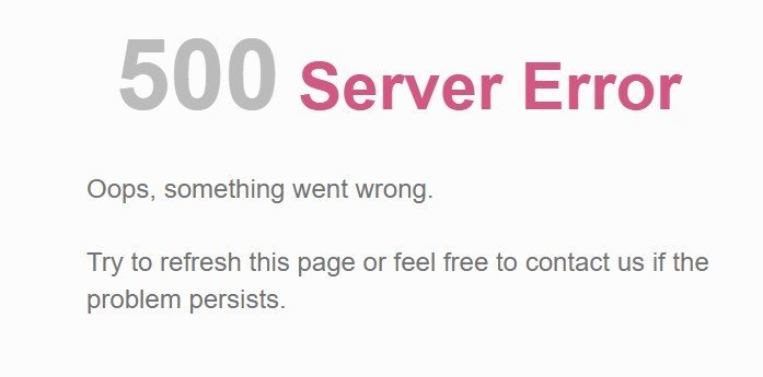

Abdurahman-Amat Posted April 1, 2025 Share Posted April 1, 2025 (edited) Hi there, I could finally upgrade our Shop from 8.1.6 to 8.2.1 with 1-click-Upgrade v 6.3 , but I could NOT be able to open the Shop due to a HTTP ERROR 500 (with and without Maintenance Mode). Yesterday I could not found other way to make it work and today I wanted to ty to use the Rollback function of the 1-click-Upgrade to go back to the previous functioning version 8.1.6 . Unfortuanatly, the Rollback was failed. Now the BackOffice https://ourDomain/shop/admin***/ and also the Shop itself are not reachable due to a 500 Server Error I tried to look at /usr/local/www/our_shop/var/logs *ERROR* v8.1.6 2025/04/01 - 09:02:40: SQLSTATE[42S02]: Base table or view not found: 1146 Table 'asprestashop.ps_configuration' doesn't exist at line 151 in file classes/db/DbPDO.php It seems something is / are missing. With the previous HTTP Error 500 i could at least login to the Backoffice, but now it is totally horrible. The Server ist responding for ping check and apache24 is running. Is there any way to overcome or solve this error? Thanks! Edited April 1, 2025 by Abdurahman-Amat (see edit history) Link to comment Share on other sites More sharing options...

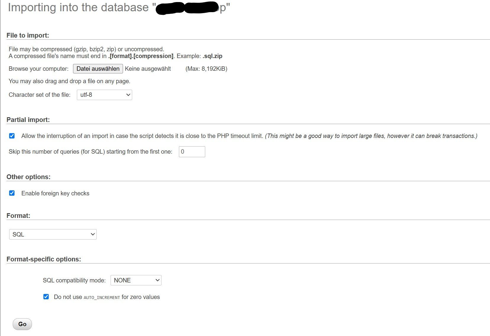

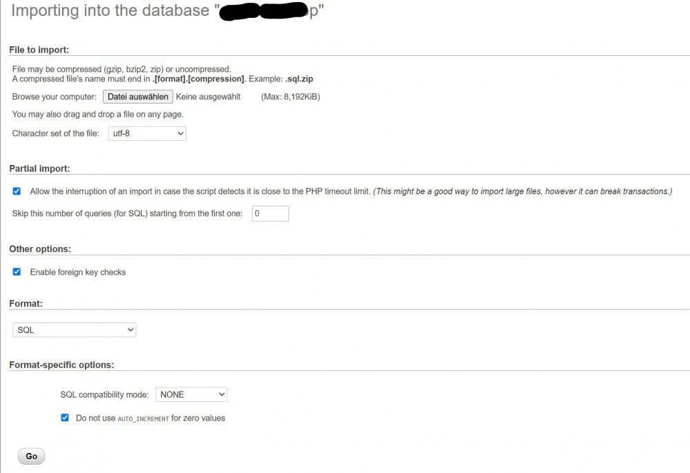

Knowband Plugins Posted April 1, 2025 Share Posted April 1, 2025 37 minutes ago, Abdurahman-Amat said: xxxx.sql . It is weird, i could not find the current database file. .sql file is a database file which you need to import via the PHPMyAdmin. Link to comment Share on other sites More sharing options...

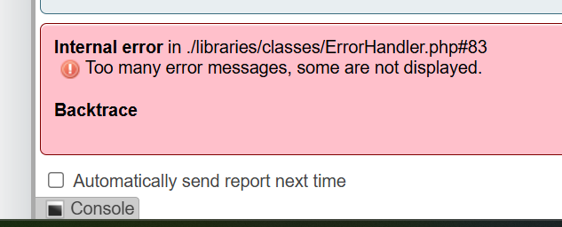

Abdurahman-Amat Posted April 1, 2025 Author Share Posted April 1, 2025 (edited) 2 hours ago, Knowband Plugins said: .sql file is a database file which you need to import via the PHPMyAdmin. When I open the login page of phpMyAdmin pannel of our shop, several Deprication Notices are being displayed. Deprecation Notice in ./libraries/classes/Url.php#246 http_build_query(): Passing null to parameter #2 ($numeric_prefix) of type string is deprecated Backtrace .... Deprecation Notice in ./vendor/twig/twig/src/Loader/FilesystemLoader.php#40 realpath(): Passing null to parameter #1 ($path) of type string is deprecated Backtrace ... Deprecation Notice in ./libraries/classes/Url.php#246 http_build_query(): Passing null to parameter #2 ($numeric_prefix) of type string is deprecated Backtrace ... Deprecation Notice in ./vendor/twig/twig/src/Node/Node.php#210 Return type of Twig\Node\Node::count() should either be compatible with Countable::count(): int, or the #[\ReturnTypeWillChange] attribute should be used to temporarily suppress the notice Backtrace ... Deprecation Notice in ./vendor/twig/twig/src/Node/Node.php#215 Return type of Twig\Node\Node::getIterator() should either be compatible with IteratorAggregate::getIterator(): Traversable, or the #[\ReturnTypeWillChange] attribute should be used to temporarily suppress the notice Backtrace ... I can login to it and there I am encountering Deprication Notices. At the left side panel I can at lease see the Database name and other entries, like ps_order, ps_order_details etc. and when I click any of them that Deprication Notice willbe poped up and annoying me. When I open "Import" Tab on phpMyAdmin Menu, I get again a lot of these Deprication Notices and at bottum the following is showen. For Gods sake, i can ignore them with "Ignore All" option. I am about to import that backed up Database sql file. Can I check if that backed up Database (mentioned above) is currect? I mean, is it possible to check that sql file before the Import that, for example, an order short before the Backup date Nov. 2024 ? I can look at our E-Mails etc., then I can then say that whether theis backed up database is currect or not. I have never done Database Import yet. I am worrying now, if I am ganna losing our Online shop and all the Database or not. That is a terrible feeling ... Please give me advice and tips about this. I am ganna perform this Import tomorrow. I give my best to get our shop back! Edited April 1, 2025 by Abdurahman-Amat (see edit history) Link to comment Share on other sites More sharing options...
