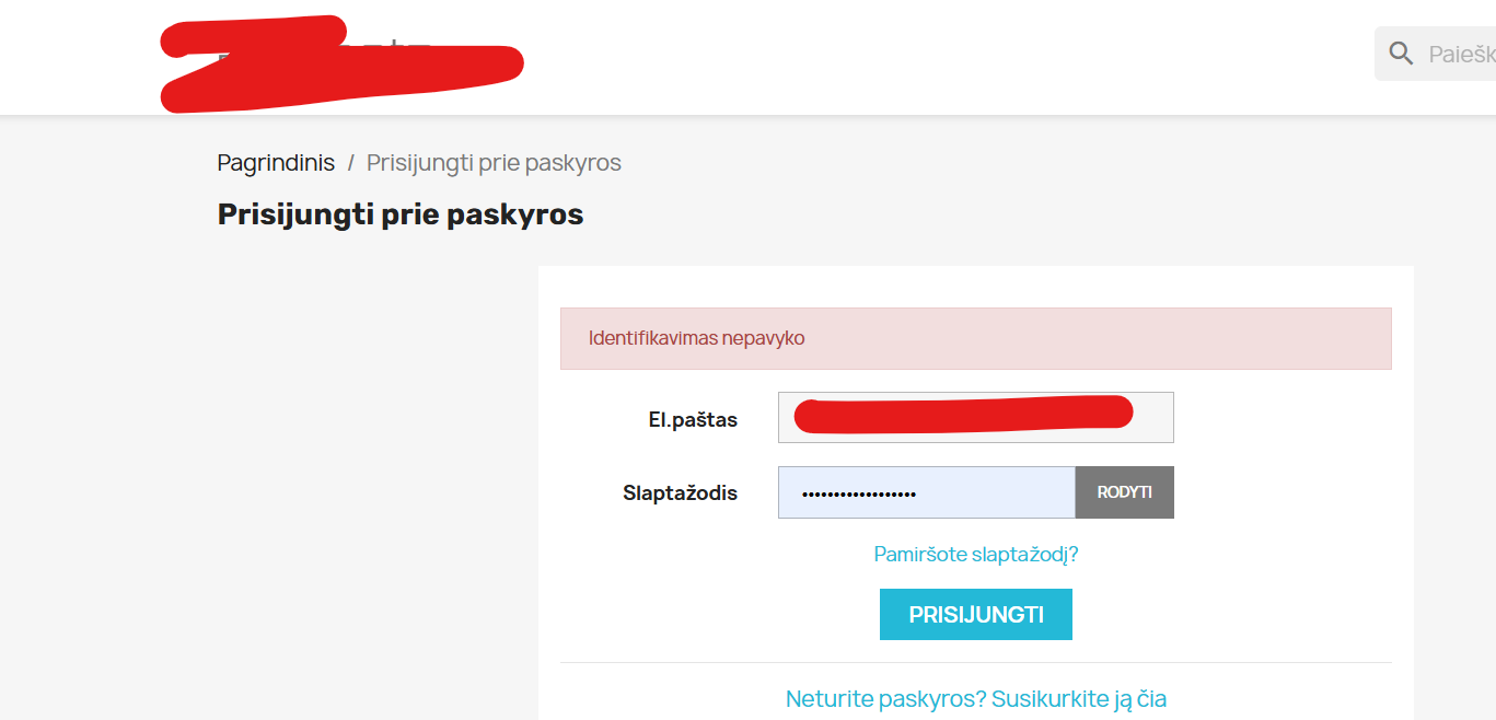

NoOne_Lt Posted February 9 Share Posted February 9 (edited) Hi community, encountering really strange issues with Presta. Though i am 99% sure it worked until some time. I was playing around with presta and at some point FEnd login started failing. While in the meantime ive done numerous changes i didn't bothered to look for fix, just done a reinstall. its on hosting. Googled a bit, but all authentication issues are quiet old... Tried another browsers and hard refreshes, nothing helps. I can set my user pass in BEnd to whatever i want, so pass should be correct. Unfortunately issue still persist i can not log in to FEnd with my admin, shop is in Online mode, Ive created Customer and it seems to be logging in fine, but i am not sure when that one will stop working. Ive tried to create another Team member and it also fails to log in. So looking for troubleshooting advice, thanks! BR, Igor Edited February 9 by NoOne_Lt (see edit history) Link to comment Share on other sites More sharing options...

NoOne_Lt Posted February 10 Author Share Posted February 10 Hi @Ewonta, unfortunately its just: "Authentication failed." above the login form, like normally, without additional output... Link to comment Share on other sites More sharing options...

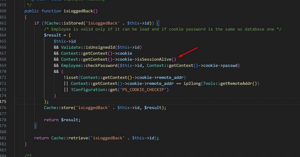

Ewonta Posted February 10 Share Posted February 10 It often happens that does not save sessions. For the sake of experiment, try to remove the session check when checking the employee's authorization. In the class Employee.php Remove the check for session availability (screenshot) Context::getContext()->cookie->isSessionAlive() This is an experiment and there is no need to change anything directly in the classes, in any case, it is correct to use overriding. Link to comment Share on other sites More sharing options...
NoOne_Lt Posted February 10 Author Share Posted February 10 Hi again @Ewonta, thank, ive tried this but it didnt help. But i got info that i am on incompatible PHP... Mine is 8.2.. So ill try to get 8.1 on hosting and test from there. Link to comment Share on other sites More sharing options...
NoOne_Lt Posted February 10 Author Share Posted February 10 @Ewonta They gave me 8.1.31, fresh installation and if i use my main email in FO i get this Authentification failed, without any other info Link to comment Share on other sites More sharing options...
