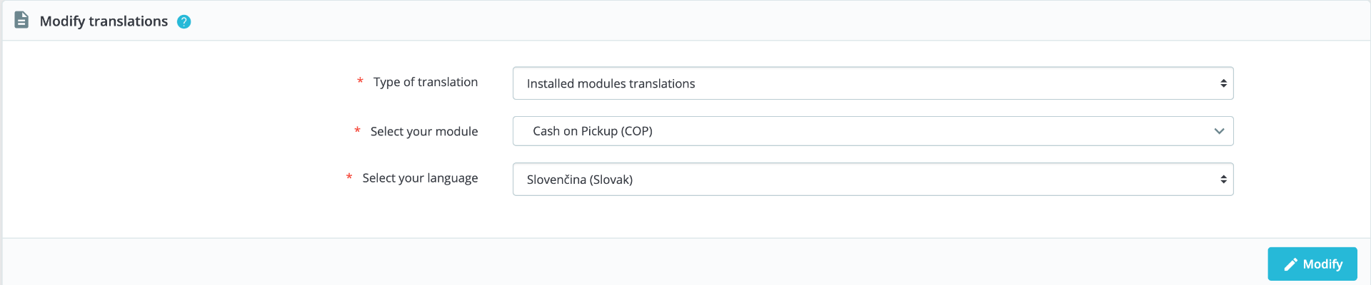

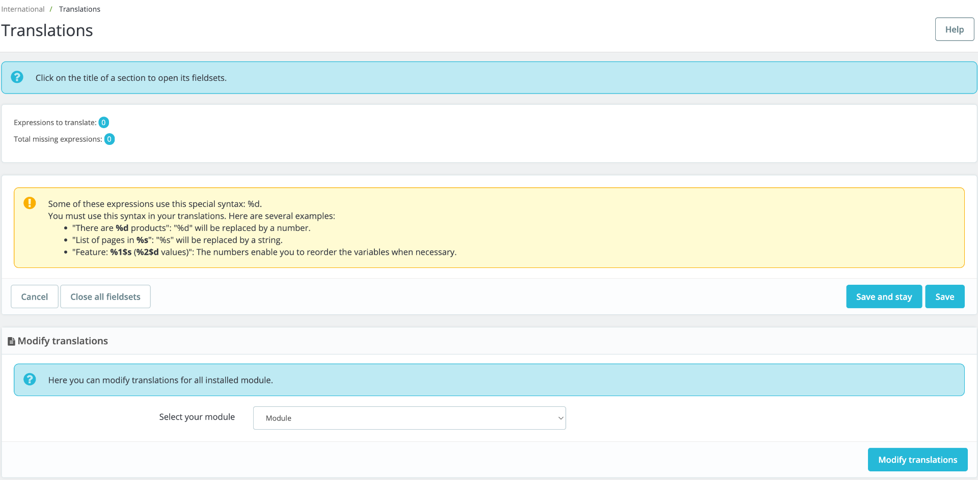

frkosk Posted February 5, 2025 Share Posted February 5, 2025 Hello everyone, I'm working on an issue in version 8.1.7. I copied the Cash on Delivery (COD) module and rewrote it as Cash on Pickup (COP). Everything works fine, but the module translations have not appeared in BO -> International –> Translations. When I select the module translation, I get a blank page—no errors, logs, nothing. In a code, I'm using the classic way like this: {l s='You pay for the merchandise upon pickup' mod='Modules.Cashonpickup.Shop'} Any ideas or suggestions? Thank you Link to comment Share on other sites More sharing options...

frkosk Posted February 5, 2025 Author Share Posted February 5, 2025 3 hours ago, pallavigodse said: Try to reinstall the module Try uninstalling and reinstalling the module: bash php bin/console cache:clear If the issue persists, enable debug mode (config/defines.inc.php) and check for hidden errors. Hi @pallavigodse, thank you for your response. I tried your suggestions but didn't get any error, and the issue is the same. Link to comment Share on other sites More sharing options...
