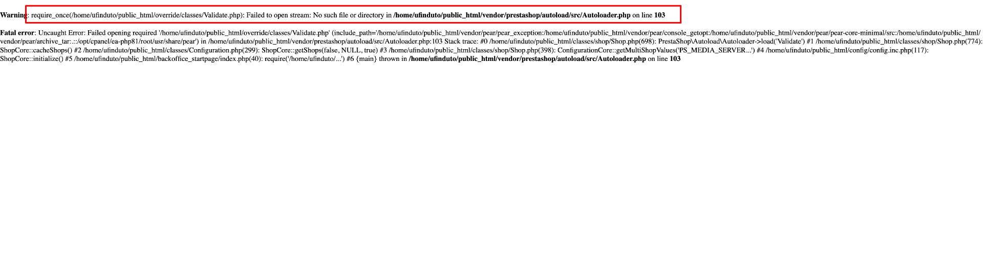

willump Posted February 5, 2025 Share Posted February 5, 2025 Hello, I get this error when I enter maintenance mode (some addons give me a 500 error, so I tried to understand what was causing it). Do you know a solution to this error? The error seems not to be linked to the addons but to the prestashop files Link to comment Share on other sites More sharing options...
Ewonta Posted February 6, 2025 Share Posted February 6, 2025 Hello. Check if the file exists override/classes/Validate.php Link to comment Share on other sites More sharing options...
willump Posted February 6, 2025 Author Share Posted February 6, 2025 1 hour ago, Ewonta said: Hello. Check if the file exists override/classes/Validate.php Hi @Ewonta, i have checked but there is any Validate.php in classes folder. how can i fix this? Link to comment Share on other sites More sharing options...
Ewonta Posted February 6, 2025 Share Posted February 6, 2025 You probably have a cache and it wants to find the file. Validate.php Just add the file Validate.php at the address /override/classes/Validate.php And try it Link to comment Share on other sites More sharing options...

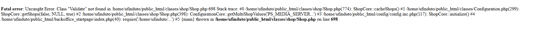

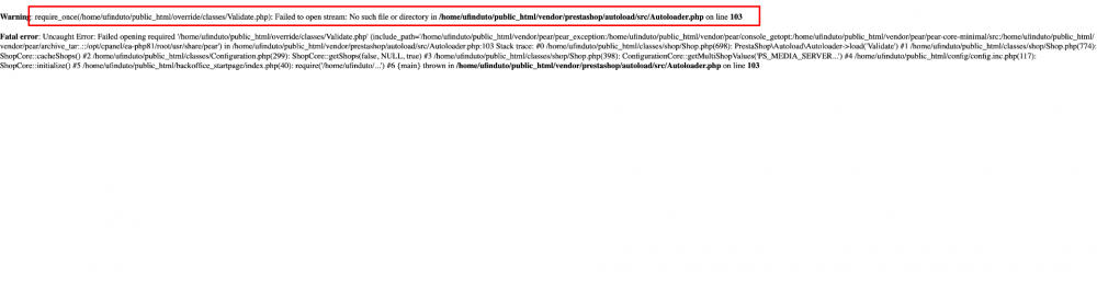

willump Posted February 6, 2025 Author Share Posted February 6, 2025 1 hour ago, Ewonta said: Have you cleared the cache? if i enter in debug mode, this is the error Link to comment Share on other sites More sharing options...
heyciao Posted February 6, 2025 Share Posted February 6, 2025 The validate file Validate.php you have downloaded from willump is not valid because it does not contain any validate class function. The system does not only need to find the validate.php in override/classes/ but also needs to find the Validate Class function written in it. So, if you get the fresh Prestashop installation you will notice a Validate.php file in the yourdomain/classes/Validate.php. If you do not see it, I think this is a problem. But from what you write, you do not see it in yourdomain/override/classes/Validate.php. Not having that file in that path is not something bad, I do not have it. But the error tells that probably you have a module that override the normal Validate.php with the proper override file in the override directory. Maybe you should copy the Validate.php you have in your classes path with FTP, put it in override/classes/ and see if something changes. And, you should find out which module is calling Validate.php in override, maybe disabling modules one by one or disabling all and enabling one by one. 1 Link to comment Share on other sites More sharing options...
willump Posted February 6, 2025 Author Share Posted February 6, 2025 1 hour ago, heyciao said: The validate file Validate.php you have downloaded from willump is not valid because it does not contain any validate class function. The system does not only need to find the validate.php in override/classes/ but also needs to find the Validate Class function written in it. So, if you get the fresh Prestashop installation you will notice a Validate.php file in the yourdomain/classes/Validate.php. If you do not see it, I think this is a problem. But from what you write, you do not see it in yourdomain/override/classes/Validate.php. Not having that file in that path is not something bad, I do not have it. But the error tells that probably you have a module that override the normal Validate.php with the proper override file in the override directory. Maybe you should copy the Validate.php you have in your classes path with FTP, put it in override/classes/ and see if something changes. And, you should find out which module is calling Validate.php in override, maybe disabling modules one by one or disabling all and enabling one by one. i have tried to copy Validate.php from classes to override/classes but the error persist. Is there a way to identify which addon is responsible for the error without disabling them? Link to comment Share on other sites More sharing options...
heyciao Posted February 6, 2025 Share Posted February 6, 2025 I have read you log error, I do not know if that is a module. How have you cleared the cache? 4 hours ago, willump said: if i enter in debug mode, this is the error Why this error is different from the first? In Shop.php cannot find the validate class. But also other php files are involved. It does not say Validate.php is missing, it is saying that the class Validate is not found. Do you have a complete error log? What is happening, if I go to the website i see the error? paste the url please. Link to comment Share on other sites More sharing options...

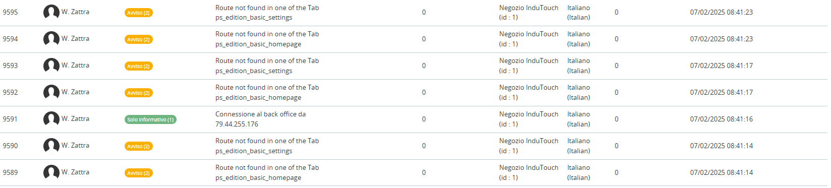

willump Posted February 7, 2025 Author Share Posted February 7, 2025 15 hours ago, heyciao said: I have read you log error, I do not know if that is a module. How have you cleared the cache? Why this error is different from the first? In Shop.php cannot find the validate class. But also other php files are involved. It does not say Validate.php is missing, it is saying that the class Validate is not found. Do you have a complete error log? What is happening, if I go to the website i see the error? paste the url please. I have cleared the cache, multiple times. The error shown before appears when i enter in debug mode. If i go into logs i found this. You could see the error only if you enable debug mode (what you see in the screenshot is all there is), but I can't leave the shop in this state because we have active Google Ads campaigns and are currently working on it. Link to comment Share on other sites More sharing options...
