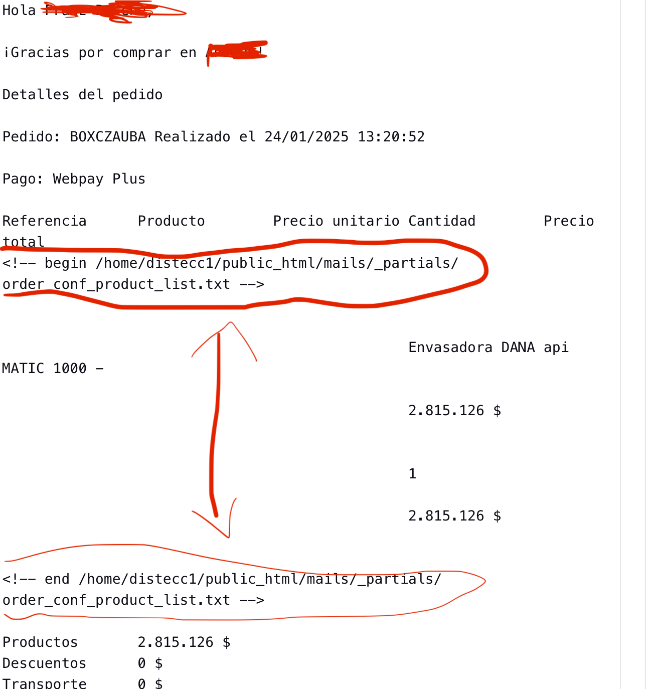

frandua Posted January 25, 2025 Share Posted January 25, 2025 Hello, I have noticed that when I place an order, the comments in the order confirmation email appear as in the attached photo. Do you know how to fix this problem? Thank you very much Link to comment Share on other sites More sharing options...
Ewonta Posted January 26, 2025 Share Posted January 26, 2025 Hello, Most likely, your store is running in debug mode, as this type of display is typical for debug mode, where the system shows the beginning and end of a file. You should try enabling the "Send email in HTML format" option. It’s likely that your emails are being sent in "Send email in text format" mode. Check if debugging is enabled. Tab: Advanced Parameters -> Performance -> Debug mode Check the email sending type.Tab: Advanced Parameters -> E-mail 1 1 Link to comment Share on other sites More sharing options...
