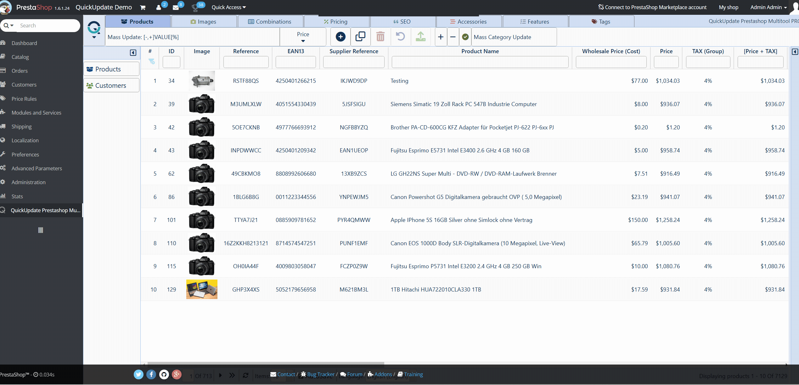

QuickUpdate.net Posted January 25, 2025 Share Posted January 25, 2025 (edited) "Found an answer myself. The table is ps_customer and the field I was looking for is is_guest." - didn't understand your specific use case initially because those are also "accounts" but guest ones. "I'm aware that the group assignment correction will most likely have to be done manually." - If you are not good with SQL, can be done from an interface with a mass update module like QuickUpdate (example below). Edited January 25, 2025 by QuickUpdate.net (see edit history) Link to comment Share on other sites More sharing options...

QuickUpdate.net Posted January 25, 2025 Share Posted January 25, 2025 (edited) That query is ok if you only want to update the default group, not for for reassigning other groups for the respective customer accounts. Also not everyone searching for a solution to the same problem as yours want to waste the time to learn SQL and might prefer a ready made alternative / GUI interface. Edited January 26, 2025 by QuickUpdate.net (see edit history) Link to comment Share on other sites More sharing options...
