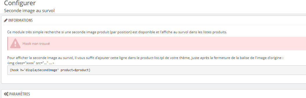

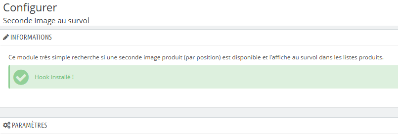

Eolia Posted January 20, 2025 Share Posted January 20, 2025 1 Link to comment Share on other sites More sharing options...
