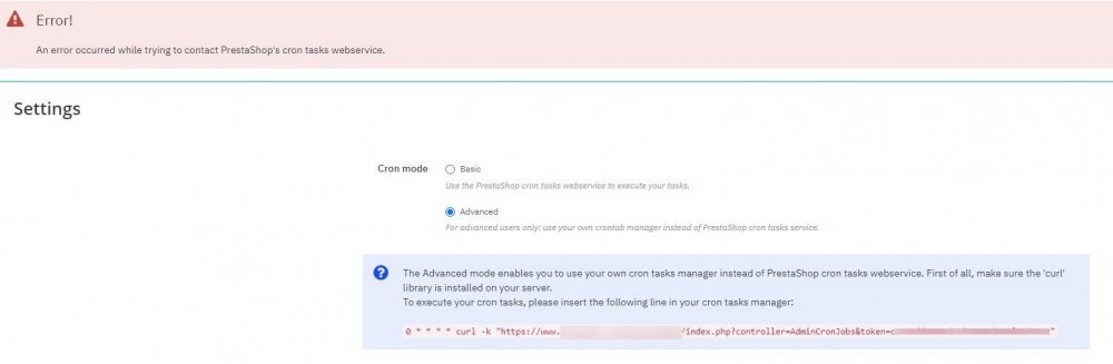

monak1983 Posted October 1, 2024 Author Share Posted October 1, 2024 Hi NordicDesigner, thanks a lot for your reply. I have installed Cron Task Manger but seems to bo compatible only with PS 1.6. I have installed and when I try to save configuration I have this error message: "An error occurred while trying to contact PrestaShop's cron tasks webservice." So I copy link and add to my server cron configuration. Is enough? Module is needed only to have correct link to put on my server cron job? Regards Marco Link to comment Share on other sites More sharing options...
NordicDesigner Posted October 2, 2024 Share Posted October 2, 2024 If you're getting that error with the Cron Tasks Manager and you’ve already copied the cron URL from the module, the module itself is not essential for the cron job to work. Its main purpose is to give you the correct link to use on your server. Here’s what you should do: If you have the cron URL (the one you copied from the module), you can proceed by adding it to your server's cron job configuration, as you've done. So in your case, adding the cron job manually on your server like this: */30 * * * * wget -qO- 'http://yourdomain.com/modules/cronjobs/cron.php?secure_key=YOUR_SECURE_KEY' should be enough for PrestaShop to run the necessary tasks. Just make sure you replace YOUR_SECURE_KEY with the actual key from your setup. Once you’ve added the cron job to your server, verify that it's running by checking your server logs or manually visiting the cron URL in your browser (you should see a success message or nothing at all). No need for the module to stay active: The module is mainly useful for generating the URL, so you don’t need it after configuring the cron job directly on your server. 1 Link to comment Share on other sites More sharing options...
