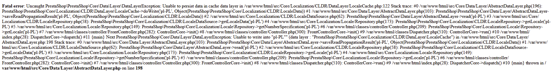

mtdkuser Posted April 2, 2024 Author Share Posted April 2, 2024 (edited) Hi @Paul C, Sorry for the late reply but I had a holiday. Well, the strangest thing in all of this is that before importing the database, the whole store works fine - even when I have mounted theme/plugin files I want to work on. Just after importing the dump of the production database, backoffice becomes inaccessible. The moment I go back to the previous database (the clean one, backed up right after installation), everything goes back to normal. For me, it looks quite like somewhere in the database there are stored values that do not match the values in the store's configuration files (?). Meanwhile, I tried to paste all the configuration files in the app/config directory from the production store to my local store - unfortunately, it didn't change anything. The image I use is: prestashop/prestashop:8.1.4-apache Of course, I tried using other images - it doesn't change anything at all. By the way, I noticed that you responded to my GitHub and StackOverflow threads, but I guess it doesn't make sense to have a parallel discussion about this problem on multiple platforms. EDIT: I noticed that when I try to access the admin panel on the local environment in the store with a "faulty" database, the CSRF token that appears in the URL is always the same as the token that is generated for me when I get to the backoffice in the production store - maybe the CSRF token is somehow related to my problem? EDIT2: I've also just noticed that when I manually delete the cache files from the var/cache/prod directory, I get a 404 error (Requested URL not found on this server) everywhere on my local site (even on the home page), except for the admin panel, of course - there's a 302 redirect error. The cache files in var/cache/prod are not being regenerated, but when I go back to a clean database, the store works again and the cache files are successfully regenerated. EDIT3: I decided to download all my store files and mount them in my docker-compose. Unfortunately, the store even in this way cannot be run locally... I am getting a "Unable to persist data in cache data layer" error. Of course, I also uploaded a dump of the production database (with reconfigured URLs) and deleted the contents of the /var/cache directory... I'm wondering if this is some kind of WSL2 configuration issue (file permissions?) that I'm running docker on. Edited April 10, 2024 by mtdkuser (see edit history) Link to comment Share on other sites More sharing options...
