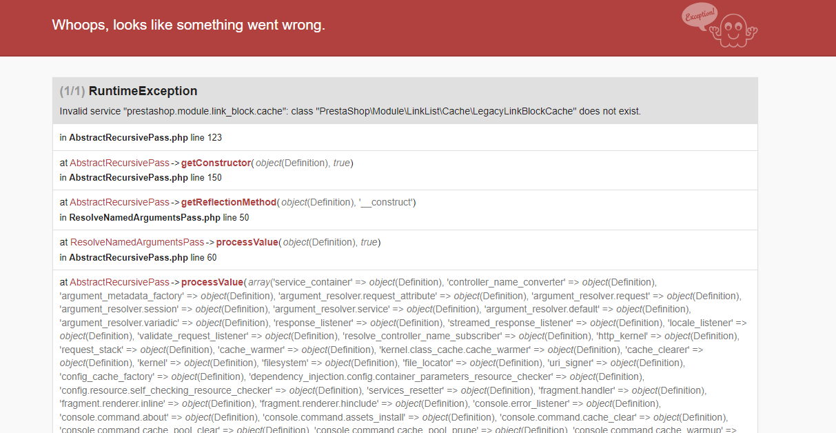

ilBofio Posted February 15, 2024 Share Posted February 15, 2024 (edited) Salve stamattina volevo fare una modifica a un modulo Ma quando vado verso la voce moduli/catalogo mi carica all'infinito la pagina Mentre invece se vado nella sezione moduli manager mi restituisce questo errore Quote Oops! An Error Occurred The server returned a "500 Internal Server Error". Something is broken. Please let us know what you were doing when this error occurred. We will fix it as soon as possible. Sorry for any inconvenience caused. Applicando invece il debug mi appare questo Edited February 15, 2024 by ilBofio (see edit history) Link to comment Share on other sites More sharing options...

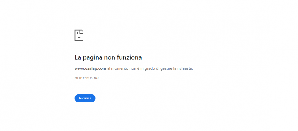

ilBofio Posted February 15, 2024 Author Share Posted February 15, 2024 46 minutes ago, ziobudda said: Ciao, prova a cancellare il contenuto di var/cache M. ho eliminato il contenuto di cache ed è questo il risultato quando tento di accedere al bo Link to comment Share on other sites More sharing options...
ilBofio Posted February 15, 2024 Author Share Posted February 15, 2024 54 minutes ago, ziobudda said: Ciao, prova a cancellare il contenuto di var/cache M. Non mi fa più entrare nel BO Link to comment Share on other sites More sharing options...

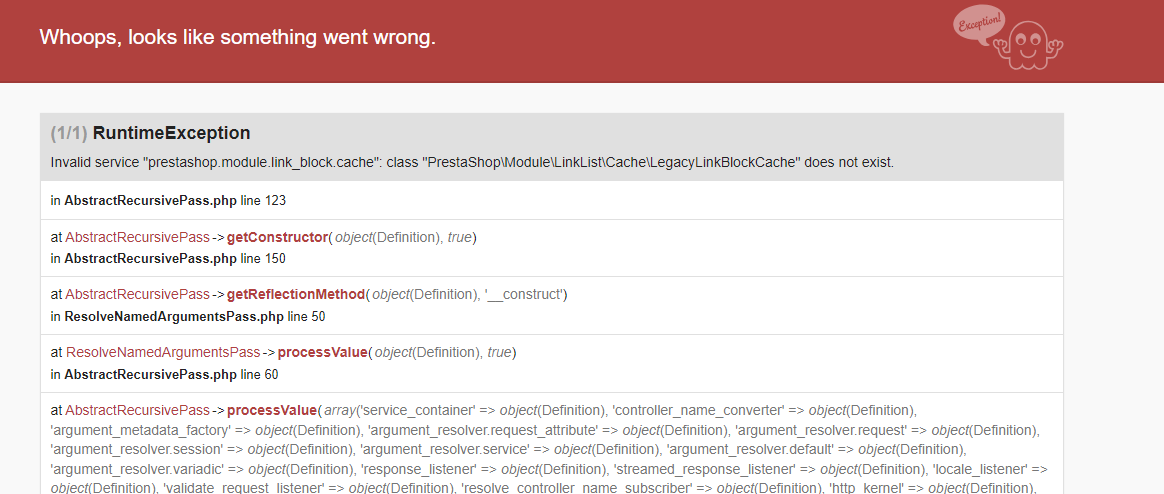

ziobudda Posted February 15, 2024 Share Posted February 15, 2024 Ciao, attiva il debug da file. If you can't acces you dashboard you can also enable it through FTP by accessing config/defines.inc.php and usually @line 29 you will find: define('_PS_MODE_DEV_', false); change it to: define('_PS_MODE_DEV_', true); Deve darti il motivo dell'errore 500. Link to comment Share on other sites More sharing options...
ilBofio Posted February 15, 2024 Author Share Posted February 15, 2024 48 minutes ago, ziobudda said: Ciao, attiva il debug da file. If you can't acces you dashboard you can also enable it through FTP by accessing config/defines.inc.php and usually @line 29 you will find: define('_PS_MODE_DEV_', false); change it to: define('_PS_MODE_DEV_', true); Deve darti il motivo dell'errore 500. Link to comment Share on other sites More sharing options...
ziobudda Posted February 15, 2024 Share Posted February 15, 2024 L'errore è nel modulo LinkList che si aspetta di trovare una classe che non trova. Qui sicuramente è avvenuto un aggiornamento "monco". Come se alcuni file fossero stati sostituiti ed altri no. Controlla di avere dentro alla directory del modulo questo file: src/Cache/LegacyLinkBlockCache.php M. Link to comment Share on other sites More sharing options...

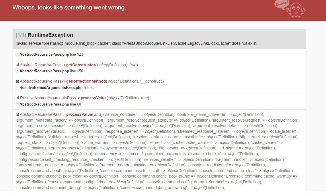

ilBofio Posted February 16, 2024 Author Share Posted February 16, 2024 21 hours ago, ziobudda said: Si, ma per sicurezza fatti una copia. E ricordati di cancellare il contenuto di var/cache dopo la cancellazione. M. Allora: Ho eliminato la cartella LinkList Sono entrato nel BO. Ho eliminato la cache, prod e dev, entro in module manager e mi da errore Oops! An Error Occurred The server returned a "500 Internal Server Error". Something is broken. Please let us know what you were doing when this error occurred. We will fix it as soon as possible. Sorry for any inconvenience caused. E' ritornato esattamente come prima, ma questa volta senza il modulo che gli dava fastidio.... Link to comment Share on other sites More sharing options...
ziobudda Posted February 16, 2024 Share Posted February 16, 2024 Hai ancora il debug attivo ? M. Link to comment Share on other sites More sharing options...

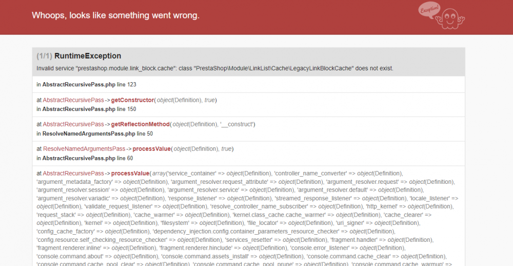

ilBofio Posted February 16, 2024 Author Share Posted February 16, 2024 6 minutes ago, ziobudda said: Hai ancora il debug attivo ? M. Link to comment Share on other sites More sharing options...
ziobudda Posted February 16, 2024 Share Posted February 16, 2024 Per il sistema c'è ancora quel modulo... Forse in qualche override. M. Link to comment Share on other sites More sharing options...
