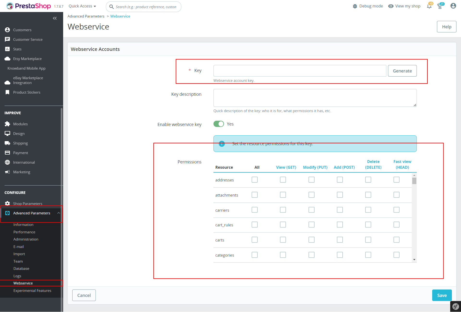

Knowband Plugins Posted November 29, 2023 Share Posted November 29, 2023 Hi, Yes, for using web services you need to pass parameters as well which I can't see here. ws_key params should be there and this key you can get this from the Advance Parameters -> Webservices page where you need to click on Add a web service API key and inside it you need to allow permissions that the web service can provide. Check the snap attached Link to comment Share on other sites More sharing options...

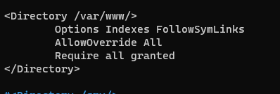

jesperth Posted January 7, 2024 Share Posted January 7, 2024 You need to allow override on the root folder. This is from an ubuntu server, your path may vary: Link to comment Share on other sites More sharing options...
