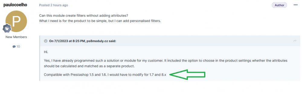

4presta Posted July 1, 2023 Share Posted July 1, 2023 (edited) Hi. Yes, I have already programmed such a solution or module for my customer. It included the option to choose in the product settings whether the attributes should be calculated and matched as a separate product. Compatible with Prestashop 1.5 and 1.6. I would have to modify for 1.7 and 8.x Edited July 1, 2023 by ps8moduly.cz (see edit history) Link to comment Share on other sites More sharing options...
paulocoelho Posted July 3, 2023 Author Share Posted July 3, 2023 Can this module create filters without adding attributes? What I need is for the product to be simple, but I can add personalised filters. On 7/1/2023 at 7:25 PM, ps8moduly.cz said: Hi. Yes, I have already programmed such a solution or module for my customer. It included the option to choose in the product settings whether the attributes should be calculated and matched as a separate product. Compatible with Prestashop 1.5 and 1.6. I would have to modify for 1.7 and 8.x Link to comment Share on other sites More sharing options...

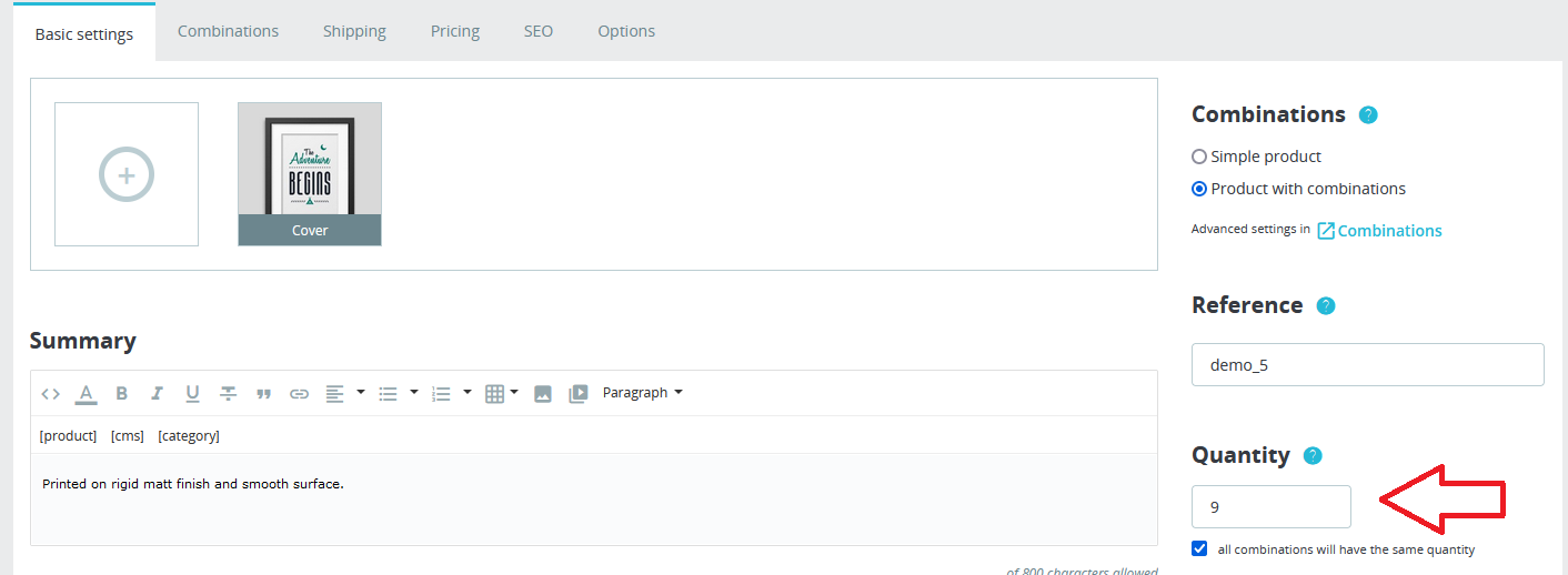

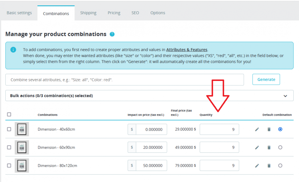

4presta Posted July 3, 2023 Share Posted July 3, 2023 (edited) What filters? The module according to settings will update the count for all combinations according to the main product. It works in the background, whenever the Prestashop function is called to change the number in stock available. This means that if someone buys a combination of, for example, red, the others, for example, green and blue, will have the same number. In this case, the total sum of the attributes will be the same as the number in the combination. In short, it's the same as you need. Combinations: 9 +9 +9 = 9 !!! Product: 9 = Combinations: 9 + 9 + 9 !!! Otherwise, it will be necessary to create separate products from the combinations. Edited July 3, 2023 by ps8moduly.cz (see edit history) Link to comment Share on other sites More sharing options...
4presta Posted July 3, 2023 Share Posted July 3, 2023 My module is intended for those who sell ash products and have them modified with combinations.Example: My company makes wooden toys, for example a train with a wagon. He has 9 unpainted trains with wagons in stock. Someone orders red wheels and a green machine and a yellow wagon. So 1 is subtracted from the warehouse for all combinations, because one "semi-finished" machine with a wagon leaves the warehouse. Link to comment Share on other sites More sharing options...
paulocoelho Posted July 3, 2023 Author Share Posted July 3, 2023 This will solve my problem if the API puts the stock in this "Quantity" field. How can i test it? Link to comment Share on other sites More sharing options...

4presta Posted July 7, 2023 Share Posted July 7, 2023 Hi, on monday the module will be available. https://ps8moduly.cz/moduly/28-aktualizujte-mnozstvi-kombinaci-podle-mnozstvi-produktu Link to comment Share on other sites More sharing options...
paulocoelho Posted July 10, 2023 Author Share Posted July 10, 2023 On 7/7/2023 at 9:56 AM, ps8moduly.cz said: Hi, on monday the module will be available. https://ps8moduly.cz/moduly/28-aktualizujte-mnozstvi-kombinaci-podle-mnozstvi-produktu It works, thanks. 1 Link to comment Share on other sites More sharing options...
