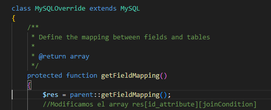

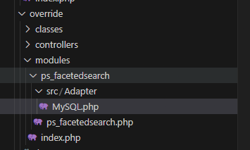

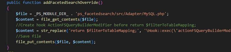

boki Posted June 19, 2023 Share Posted June 19, 2023 Hi! I need to modify the query from faceted search module , just add a where clause. i seen that i can modify it easy from ps_facetedsearch/src/Adapter/MySQL.php. I've tried to override this class from my module , but my new file is not copied. If i try to copy it manually, it does not works too. I try to modify the file when my module is installed ,but prestahop addons do not allow this... I seen that the hook actionProductSearchProviderRunQueryBefore can edit the query , but i don't see how to add my where clause. Do you have any idea? Thanks! Link to comment Share on other sites More sharing options...

fedesib Posted August 8, 2023 Share Posted August 8, 2023 Hi everyone, just an update: the hooks provided (actionProductSearchProviderRunQueryBefore and actionProductSearchProviderRunQueryAfter) are not exactly what I need, so I tried to write my own productSearchProvider and I succeeded at some point. But my goal was just a simple modification of the query inside the faceted search Adapter and I did not want to rewrite the whole productSearchProvider (that takes care of a lot of things!): since I did not find a proper way to extend faceted search productSearchProvider I gave up and I will do my modifications inside ps_facetedsearch/src/Adapter/MySQL.php, I know this is not good programming, but this is the only way I found to reach my goal without reinventing the wheel. If somebody knows how to properly extend faceted search productSearchProvider (if it is possible), please let me know! Thanks, Federica Link to comment Share on other sites More sharing options...
