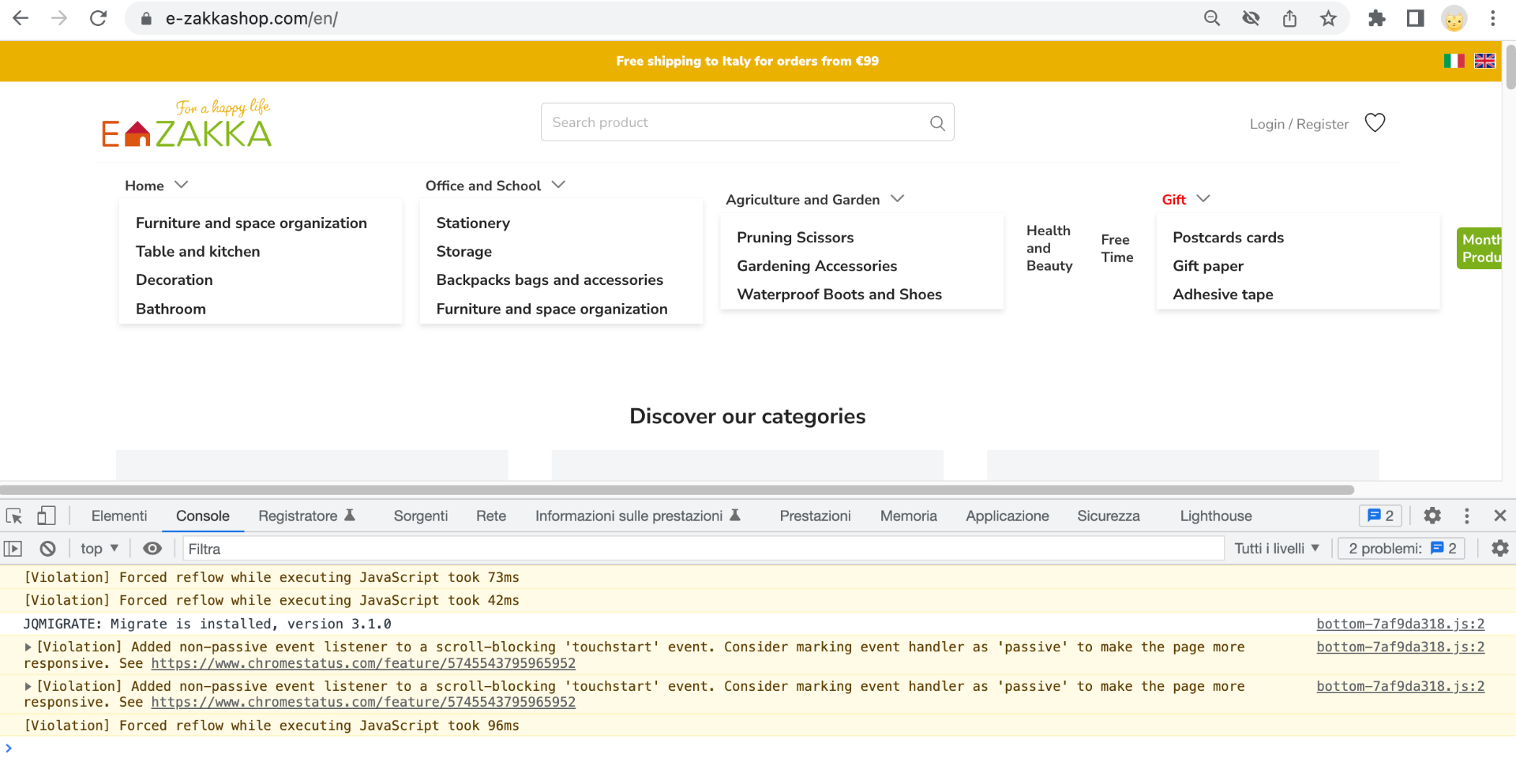

Gatto_Rosso Posted March 21, 2023 Author Share Posted March 21, 2023 Hello, thank you for your reply! Clearing cache did not solve the issue. I noticed other strange things: top menu is shown as in attached screenshot; it seems that some javascript files do not load. No changes to template were made. Everything was OK, and now 😓 Link to comment Share on other sites More sharing options...

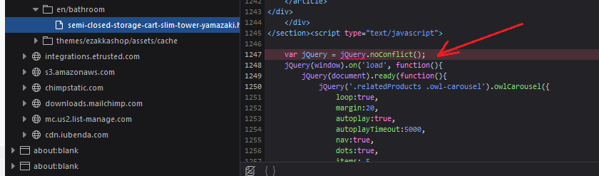

4presta Posted March 21, 2023 Share Posted March 21, 2023 Thank you. This is not a ps_shopingcart module problem. From the extract it is clear that somewhere in the code an http link to an external jquery is used, but the eshop uses https. Link to comment Share on other sites More sharing options...

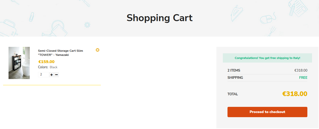

4presta Posted March 21, 2023 Share Posted March 21, 2023 It's not a cart, as I wrote. The product is added to the cart correctly. Cart: Here you can clearly see the error where invalid jquery is loaded in the template. Some of the modules or custom javascript additions to the TPL template refer to http instead of https. I would search in ets_* modules or trusted module. Link to comment Share on other sites More sharing options...
Gatto_Rosso Posted March 22, 2023 Author Share Posted March 22, 2023 Hello, thank you very much! Yes it is a misspelled call to jQuery. I have yet to find where it is… A search on all files of those add-ons did not discover the faulty http Link to comment Share on other sites More sharing options...
4presta Posted March 23, 2023 Share Posted March 23, 2023 (edited) Look in Design -> Positions. Find the modules that are attached to the displayHeader, displayBeforeBodyClosingTag hook. I think there will be an error in some TPL file of some module. Edited March 23, 2023 by ps8moduly.cz (see edit history) Link to comment Share on other sites More sharing options...

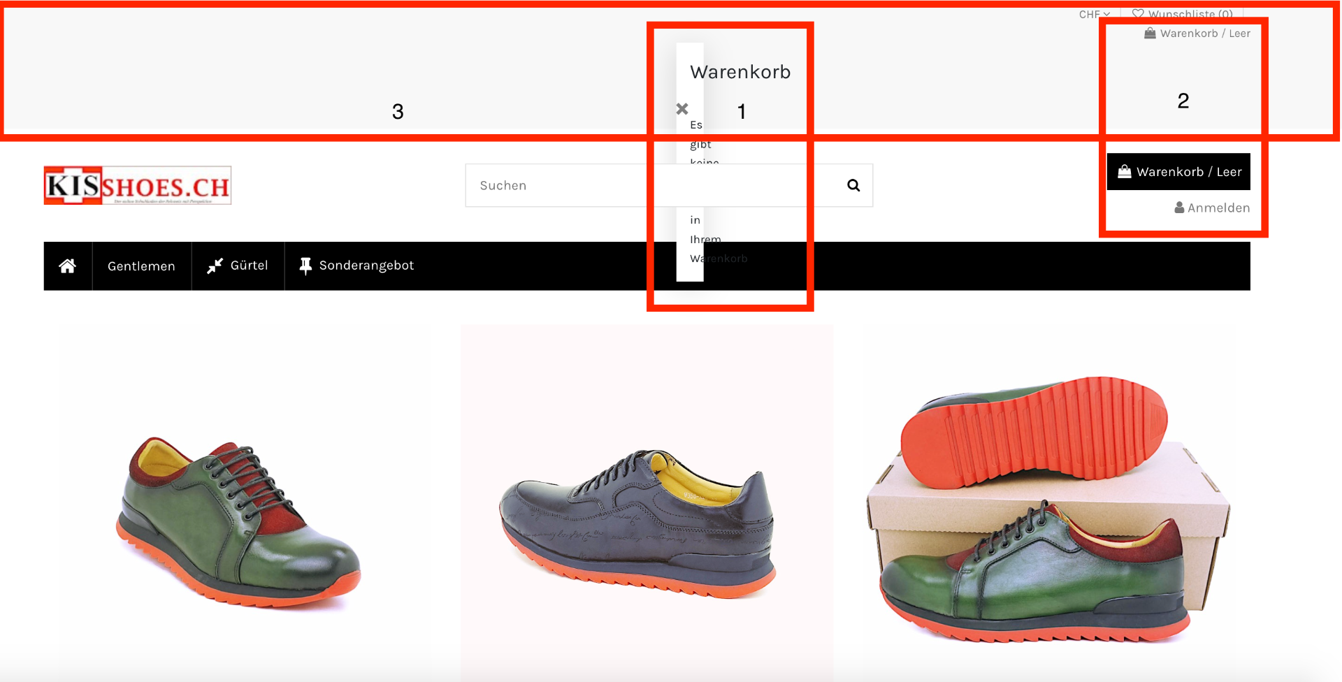

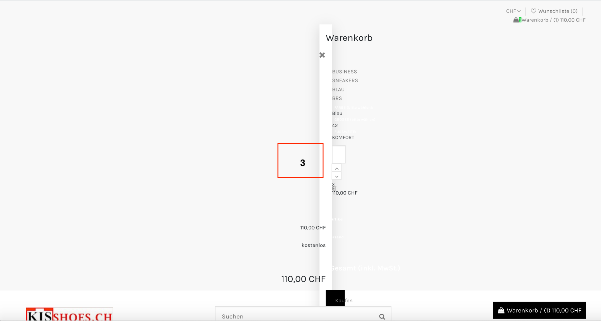

sbempire Posted April 4, 2023 Share Posted April 4, 2023 On 3/23/2023 at 8:01 AM, ps8moduly.cz said: Look in Design -> Positions. Find the modules that are attached to the displayHeader, displayBeforeBodyClosingTag hook. I think there will be an error in some TPL file of some module. Hello ps8moduly.cz, please do you have idea what could cause the shopping cart to misalign as shown in the attached screenshots. It happened after I deinstalled shopping and reinstalled it again. Looking forward to your thoughts. Thank you Link to comment Share on other sites More sharing options...
