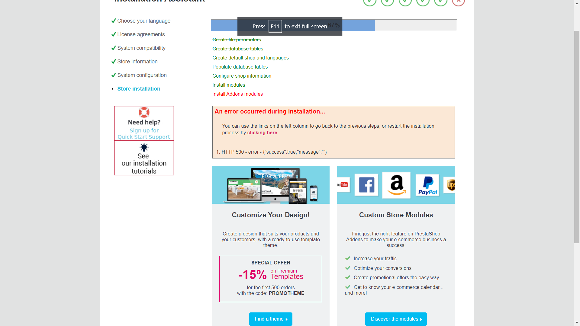

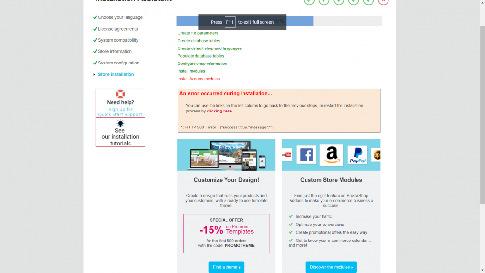

spc Posted February 7, 2023 Share Posted February 7, 2023 i get this every time i install prestashop it drives me crazy. have another site that I have the same version of php and the same prestashop and it works. Link to comment Share on other sites More sharing options...
endriu107 Posted February 7, 2023 Share Posted February 7, 2023 Turn on debug mode and try install again, you should see what module make issue in installation process and you can skip this module in next installation. Link to comment Share on other sites More sharing options...

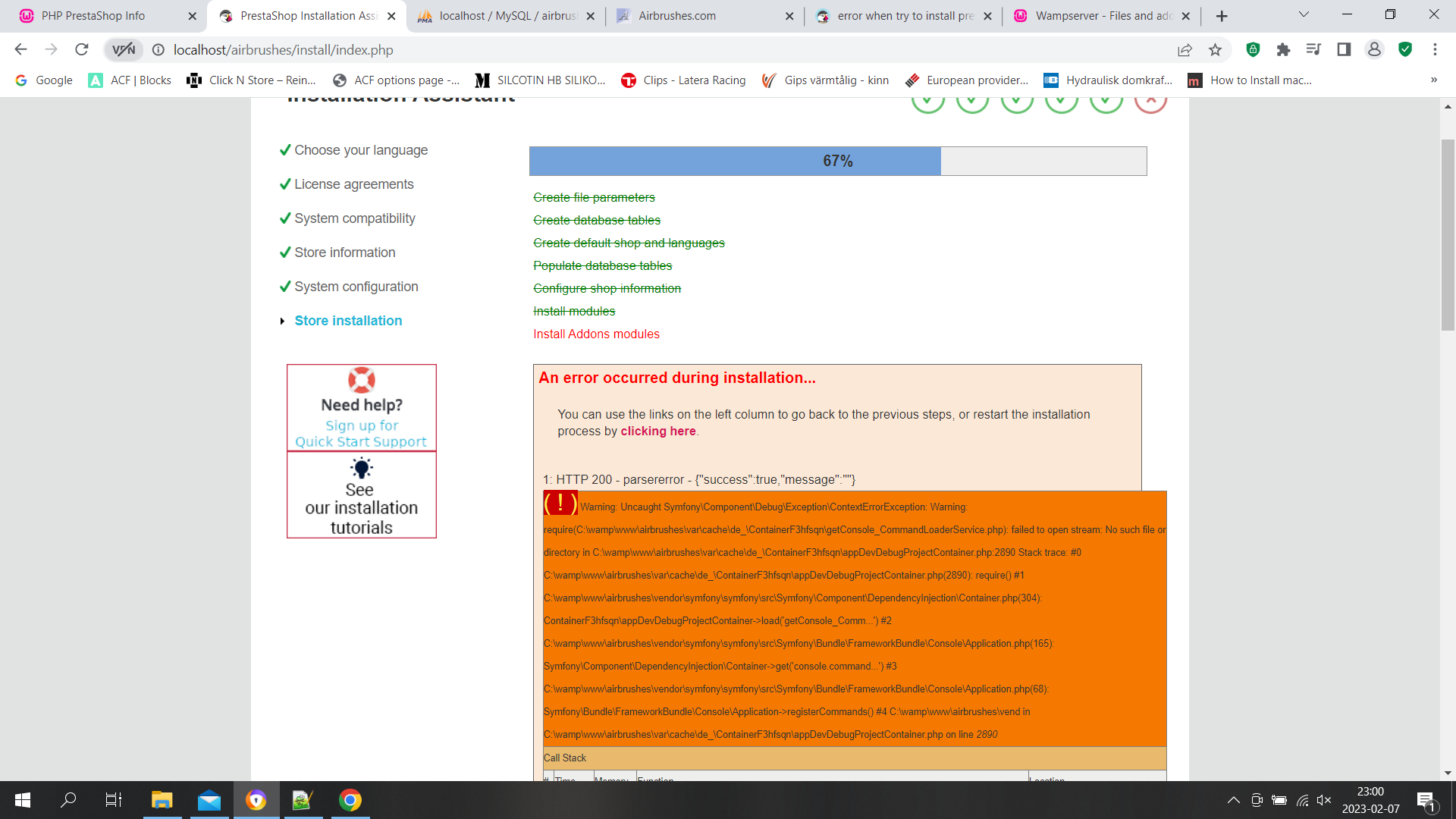

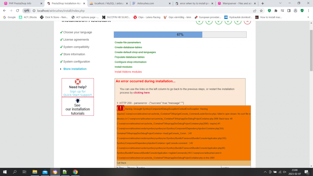

spc Posted February 7, 2023 Author Share Posted February 7, 2023 I set debug to true, and now i get this error: Warning: Uncaught Symfony\Component\Debug\Exception\ContextErrorException: Warning: require(C:\wamp\www\airbrushes\var\cache\de_\ContainerF5x7ytq\getConsole_CommandLoaderService.php): failed to open stream: No such file or directory in C:\wamp\www\airbrushes\var\cache\de_\ContainerF5x7ytq\appDevDebugProjectContainer.php:3053 Stack trace: #0 C:\wamp\www\airbrushes\var\cache\de_\ContainerF5x7ytq\appDevDebugProjectContainer.php(3053): require() #1 C:\wamp\www\airbrushes\vendor\symfony\symfony\src\Symfony\Component\DependencyInjection\Container.php(304): ContainerF5x7ytq\appDevDebugProjectContainer->load('getConsole_Comm...') #2 C:\wamp\www\airbrushes\vendor\symfony\symfony\src\Symfony\Bundle\FrameworkBundle\Console\Application.php(165): Symfony\Component\DependencyInjection\Container->get('console.command...') #3 C:\wamp\www\airbrushes\vendor\symfony\symfony\src\Symfony\Bundle\FrameworkBundle\Console\Application.php(68): Symfony\Bundle\FrameworkBundle\Console\Application->registerCommands() #4 C:\wamp\www\airbrushes\vend in C:\wamp\www\airbrushes\var\cache\de_\ContainerF5x7ytq\appDevDebugProjectContainer.php on line 3053 Fatal error: ContainerF5x7ytq\appDevDebugProjectContainer::load(): Failed opening required 'C:\wamp\www\airbrushes\var\cache\de_\ContainerF5x7ytq\getConsole_CommandLoaderService.php' (include_path='C:\wamp\www\airbrushes\vendor/pear/pear_exception;C:\wamp\www\airbrushes\vendor/pear/console_getopt;C:\wamp\www\airbrushes\vendor/pear/pear-core-minimal/src;C:\wamp\www\airbrushes\vendor/pear/archive_tar;.;C:\php\pear') in C:\wamp\www\airbrushes\var\cache\de_\ContainerF5x7ytq\appDevDebugProjectContainer.php on line 3053 Link to comment Share on other sites More sharing options...
endriu107 Posted February 7, 2023 Share Posted February 7, 2023 This is some cache related issue try delete all in C:\wamp\www\airbrushes\var\cache\ Link to comment Share on other sites More sharing options...
spc Posted February 7, 2023 Author Share Posted February 7, 2023 (edited) I have delete everything now in var\cache, try now again. There was something with the permission so i needed to reorder. im trying now again. uppdate: It was the same error... im going crazy When i check the inspect, then i can see : Failed to load resource: the server responded with a status of 414 () and this: Request-URI Too Long The requested URL's length exceeds the capacity limit for this server. Edited February 7, 2023 by spc (see edit history) Link to comment Share on other sites More sharing options...

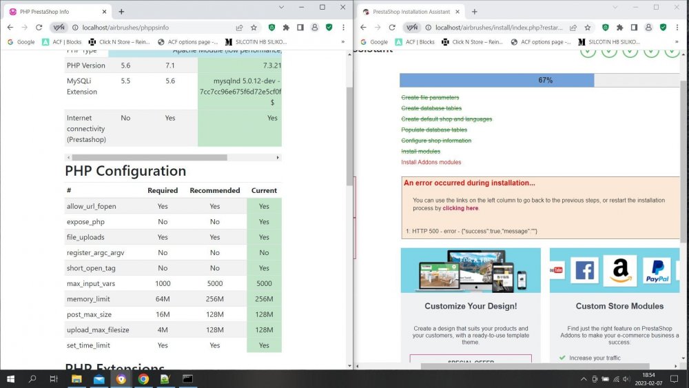

NPO Posted February 7, 2023 Share Posted February 7, 2023 possibly php version prob ? presta and php version ? Link to comment Share on other sites More sharing options...
spc Posted February 7, 2023 Author Share Posted February 7, 2023 php version 7.3.21 and prestashop_1.7.8.4 Link to comment Share on other sites More sharing options...
NPO Posted February 7, 2023 Share Posted February 7, 2023 mmmm, if all the usual php.ini changes have been made it should be fine... Link to comment Share on other sites More sharing options...
spc Posted February 7, 2023 Author Share Posted February 7, 2023 Just now, NPO said: mmmm, if all the usual php.ini changes have been made it should be fine... What do you mean. Link to comment Share on other sites More sharing options...
NPO Posted February 7, 2023 Share Posted February 7, 2023 changes to max execution time, max uploads, post size, memory limit, max input time, (some extensions may need to be activated) - they all need to the increased (if you have a default php installation). Link to comment Share on other sites More sharing options...
spc Posted February 7, 2023 Author Share Posted February 7, 2023 (edited) i have this: max_input_vars 5000 max_execution_time = 4000 memory_limit 256M post_max_size 256M upload_max_filesize 128M But still the same error: Warning: Uncaught Symfony\Component\Debug\Exception\ContextErrorException: Warning: require(C:\wamp\www\airbrushes\var\cache\de_\ContainerJ9taejp\getConsole_CommandLoaderService.php): failed to open stream: No such file or directory in C:\wamp\www\airbrushes\var\cache\de_\ContainerJ9taejp\appDevDebugProjectContainer.php:3053 Stack trace: #0 C:\wamp\www\airbrushes\var\cache\de_\ContainerJ9taejp\appDevDebugProjectContainer.php(3053): require() #1 C:\wamp\www\airbrushes\vendor\symfony\symfony\src\Symfony\Component\DependencyInjection\Container.php(304): ContainerJ9taejp\appDevDebugProjectContainer->load('getConsole_Comm...') #2 C:\wamp\www\airbrushes\vendor\symfony\symfony\src\Symfony\Bundle\FrameworkBundle\Console\Application.php(165): Symfony\Component\DependencyInjection\Container->get('console.command...') #3 C:\wamp\www\airbrushes\vendor\symfony\symfony\src\Symfony\Bundle\FrameworkBundle\Console\Application.php(68): Symfony\Bundle\FrameworkBundle\Console\Application->registerCommands() #4 C:\wamp\www\airbrushes\vend in C:\wamp\www\airbrushes\var\cache\de_\ContainerJ9taejp\appDevDebugProjectContainer.php on line 3053 Fatal error: ContainerJ9taejp\appDevDebugProjectContainer::load(): Failed opening required 'C:\wamp\www\airbrushes\var\cache\de_\ContainerJ9taejp\getConsole_CommandLoaderService.php' (include_path='C:\wamp\www\airbrushes\vendor/pear/pear_exception;C:\wamp\www\airbrushes\vendor/pear/console_getopt;C:\wamp\www\airbrushes\vendor/pear/pear-core-minimal/src;C:\wamp\www\airbrushes\vendor/pear/archive_tar;.;C:\php\pear') in C:\wamp\www\airbrushes\var\cache\de_\ContainerJ9taejp\appDevDebugProjectContainer.php on line 3053 Edited February 7, 2023 by spc (see edit history) Link to comment Share on other sites More sharing options...
NPO Posted February 7, 2023 Share Posted February 7, 2023 Memory limit could be better but it all looks fine..... do the apache log files give any hints? Link to comment Share on other sites More sharing options...

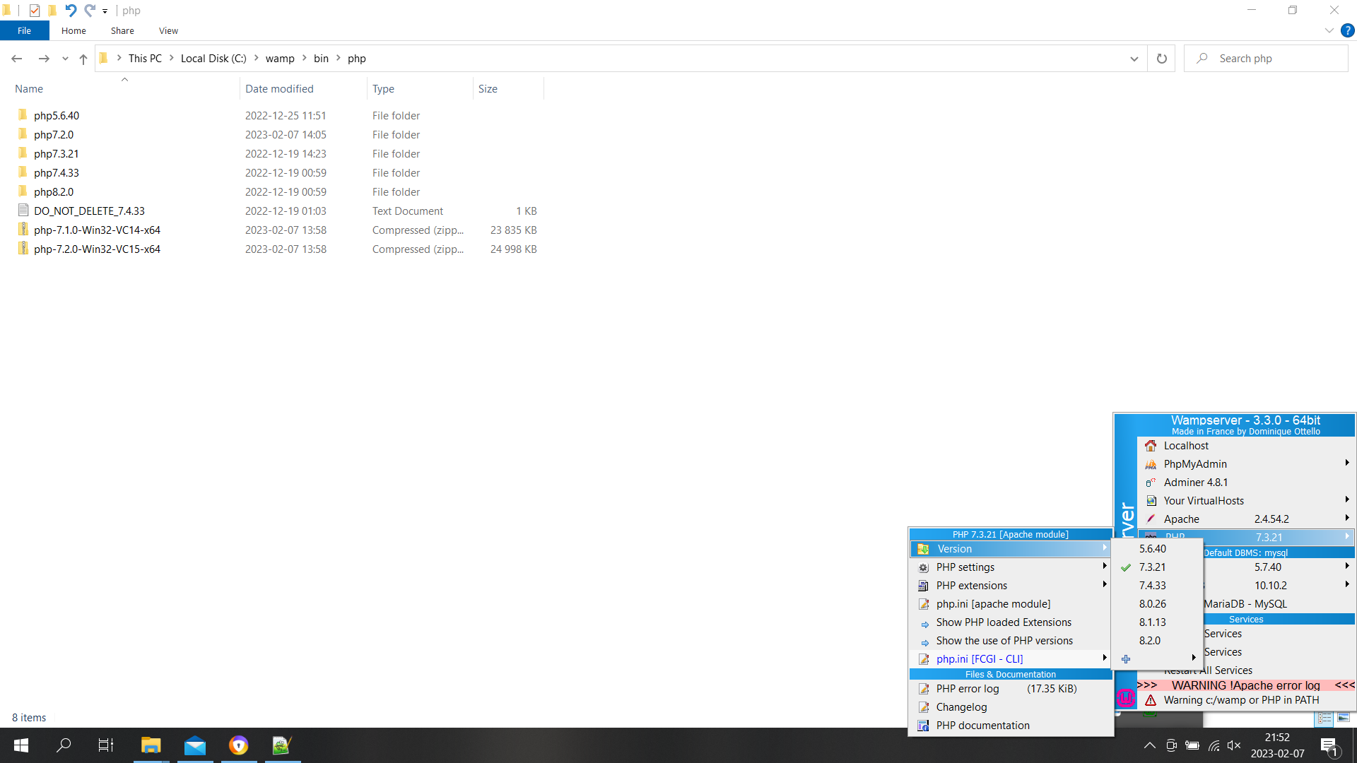

spc Posted February 7, 2023 Author Share Posted February 7, 2023 (edited) Im going to check that, that is strange is that i delete 2 php 8.0 and 8.1 but still i have the in the software. I dont understand why. Nothing in the error log. uppdate: I find this in php log: PHP Fatal error: Allowed memory size of 134217728 bytes exhausted (tried to allocate 1046506584 bytes) in C:\wamp\scripts\refresh.php on line 626 Edited February 7, 2023 by spc (see edit history) Link to comment Share on other sites More sharing options...
NPO Posted February 7, 2023 Share Posted February 7, 2023 are you using the 64 bit or the old 86 wamp version? With the new one you will need to add older versions of php (7.3 down) yourself and the php version change can be a problem (had that problem myself), I did a clean installation of wamp which solved the problem and a php problem. Link to comment Share on other sites More sharing options...
spc Posted February 7, 2023 Author Share Posted February 7, 2023 (edited) i use wampserver 3.3.0 64 bit, and this is a new installation, i dont whant to install it again, have to mutch on it. uppdate: Clear all logs, find php7.2, try again to install. And the same error shows up. Edited February 7, 2023 by spc (see edit history) Link to comment Share on other sites More sharing options...
