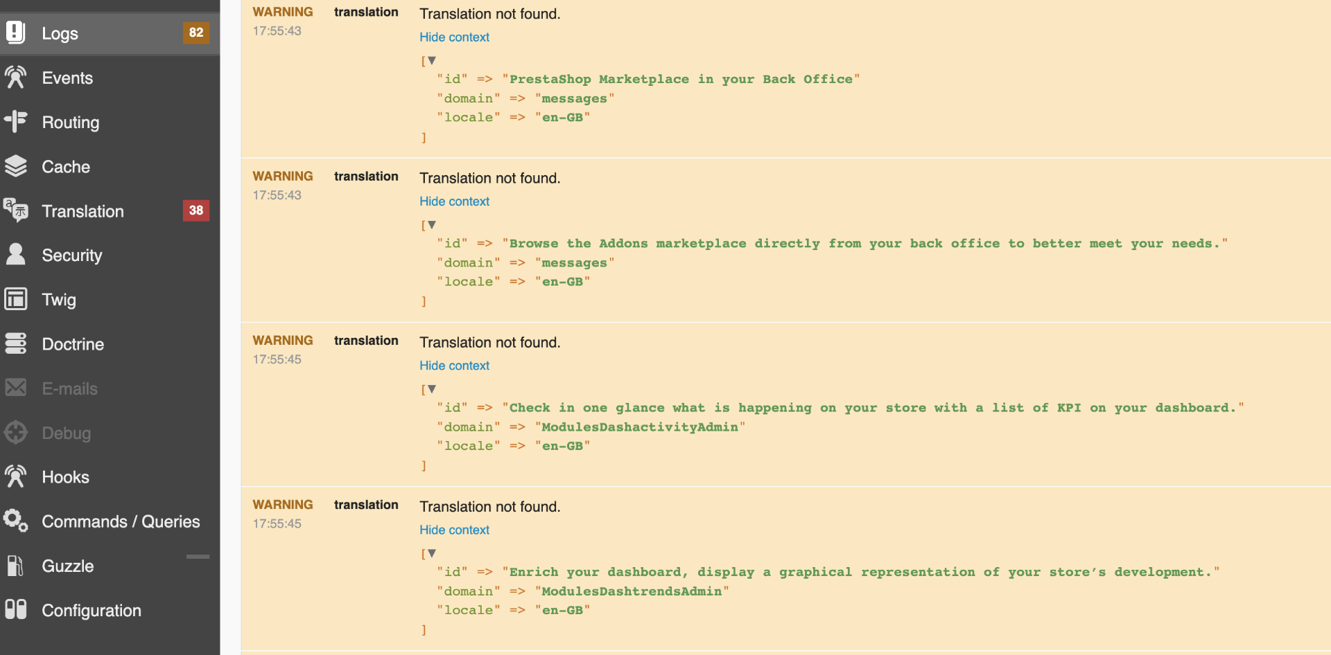

DogDayz Posted February 3, 2023 Author Share Posted February 3, 2023 I have turned on debug mode and I have attached a screenshot here. The only thing it seems to be having an issue with is the en-GB locale translations. I am in the UK so this is my chosen language. Any thoughts? Link to comment Share on other sites More sharing options...

Mediacom87 Posted February 4, 2023 Share Posted February 4, 2023 Hi, The alerts announced in the Debug only concern the absence of English translation, which is totally normal since English is the native development language in the solution, so the software uses the original texts without the need for translation, the translation system, in the case of English, is only used to customize certain texts. For slowness concerns, at no time do you specify the exact configuration of the Performance page of your installation. You can refer to my article to find out how to configure this page: https://www.mediacom87.fr/en/how-to-configure-the-performance-page-of-prestashop-17/ If you want to have more information about your server configuration, you can also use my free module : https://www.prestatoolbox.com/free-prestashop-modules/116-server-configuration.html After all that, you can also share your site's URL so that people can see how your site's data is loading. Link to comment Share on other sites More sharing options...
