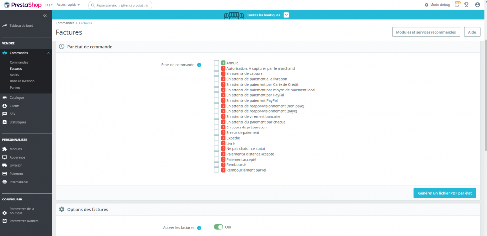

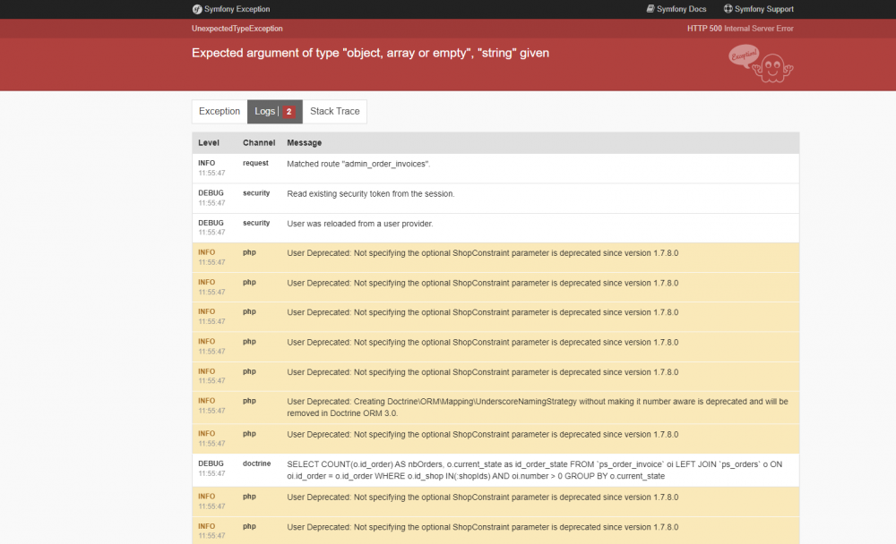

nouha88 Posted November 25, 2022 Share Posted November 25, 2022 Hello, I have an issue. After upgrading Prestashop to 1.7.8.7, once I open Invoices, it works fine at first. Then suddenly I have this error: Expected argument of type "object, array or empty", "string" given. I'm confused. I've tried to follow some of the solutions found on this forum and GitHub but it's weird, it's that it could at this very moment work well but suddenly then I get the error mentioned. Did that happen to anyone of you? What should I do? Thank you. Link to comment Share on other sites More sharing options...
nouha88 Posted January 9, 2023 Author Share Posted January 9, 2023 Nevermind. I've found a solution. In case someone gets the same problem, here is it : https://github.com/Matt75/fixconfigurationlang It will definitely fix the issue. 1 Link to comment Share on other sites More sharing options...
