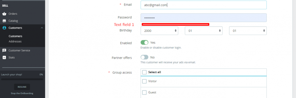

Roshan Bhavsar Posted September 20, 2022 Share Posted September 20, 2022 I want to add 2 new text fields below pasword field into the backoffice of the prestashop 1.7.8.7 Please guide me to add the text fields in admin -> customers -> select Customer -> add 2 new fields in customer edit form. also the data should be saed into the database. Please look for the attached image. Link to comment Share on other sites More sharing options...

Roshan Bhavsar Posted September 21, 2022 Author Share Posted September 21, 2022 Thanks. Now I have added a new field into the form, also added a new field into the ps_customer, but now I want to store that value into the database. So, please guide me to store that value into the database. Which files I need to modify. Thanks. Link to comment Share on other sites More sharing options...
4presta Posted September 21, 2022 Share Posted September 21, 2022 (edited) Hi. Ok, you need to put your code from the module here. I don't know the name of the field you created, I don't know the name of the column in the database table, etc. Then I'll give you the working code. There are also hooks to load and save data from the form. hookActionAfterUpdateCustomerFormHandler hookActionAfterCreateCustomerFormHandler and custom function Edited September 21, 2022 by 4you.software (see edit history) Link to comment Share on other sites More sharing options...
4presta Posted September 21, 2022 Share Posted September 21, 2022 sample: public function hookActionCustomerFormBuilderModifier(array $params) { /* your exists code */ $customerId = $params['id']; $params['data']['my_field_name_1'] = $this->getCustomerCustomFieldsData($customerId)[0]; $params['data']['my_field_name_2'] = $this->getCustomerCustomFieldsData($customerId)[1]; $formBuilder->setData($params['data']); } public function hookActionAfterUpdateCustomerFormHandler(array $params) { $this->updateCustomerCustomFields($params); } public function hookActionAfterCreateCustomerFormHandler(array $params) { $this->getCustomerCustomFieldsData($params); } private function getCustomerCustomFieldsData(array $params) { $customerId = $params['id']; if (!$customerId){return;} $customerFormData = $params['form_data']; $getSavedData = Db::getInstance()->getRow('SELECT my_field1, my_field2 FROM '._DB_PREFIX_.'customer WHERE id_customer = '.$customerId); $myTextField1 = $getSavedData['my_field1']; $myTextField2 = $getSavedData['my_field2']; return array($myTextField1, $myTextField2); } private function updateCustomerCustomFields(array $params) { $customerId = $params['id']; if (!$customerId){return;} $customerFormData = $params['form_data']; $myTextField1 = $customerFormData['my_field_name_1']; $myTextField2 = $customerFormData['my_field_name_2']; Db::getInstance()->execute("UPDATE "._DB_PREFIX_."customer SET my_field1 = '".$myTextField1."', my_field2 = '".$myTextField2."' WHERE id_customer = ".$customerId); } Link to comment Share on other sites More sharing options...
