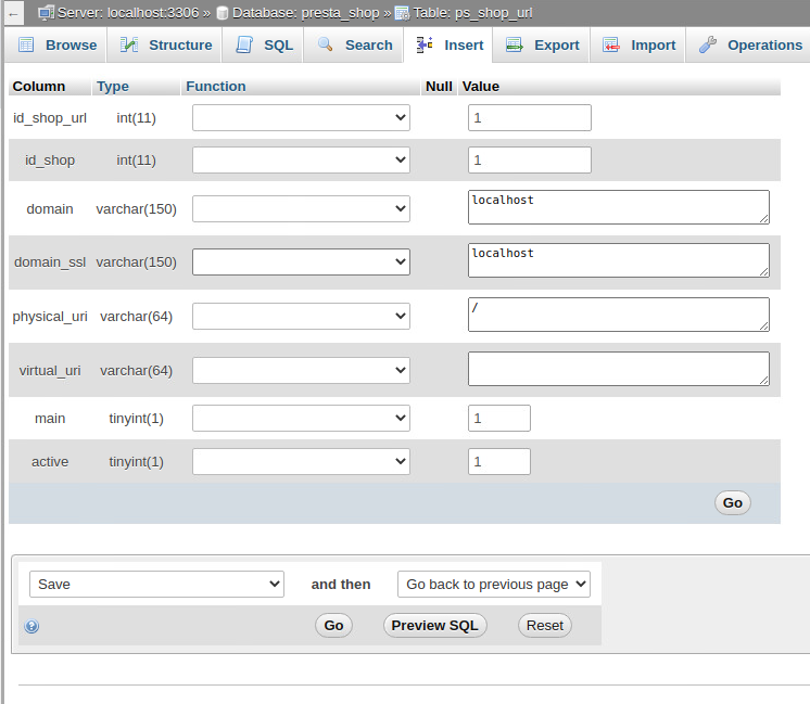

falken76 Posted August 18, 2022 Author Share Posted August 18, 2022 I installed Phpmyadmin because apparently I have to set my url in the database under this table: ps_shop_url I installed phpmyadmin on the same ubuntu linux vm. phpmyadmin only shows two databases that I believe belong to it. I don't see anywhere that you can connect to another database. Is this a convoluted process where I have to export a database and import it into phpmyadmin to make changes then export it and import back into the vm?! If I go to mysql and type SHOW DATABASES; it will show the two databases that show up in phpmyadmin, but there are 3 that are also listed in mysql that don't show up in phpmyadmin, one of which is presta_shop Do I have to do something special to see all the other databases? I'm connected to the same SQL Link to comment Share on other sites More sharing options...
falken76 Posted August 18, 2022 Author Share Posted August 18, 2022 I was able to figure out the permissions to see the database, now I don't know what field to put the correct URL in and if I need to select anything in the drop down menues. Do I put the domain in domain and domain_ssl? If so do I just replace localhost with the url and do I need to select anything in the drop down menues? Link to comment Share on other sites More sharing options...
4presta Posted August 18, 2022 Share Posted August 18, 2022 (edited) Hi, yes, just rename localhost to a domain name without http or https, for example mydomain.com. After that, you need to recreate it in the SEO & Url settings in the administration. htaccess. Turn off url rewriting and save, turn on url rewriting and save. And as the last thing, you need to recompile the template and delete the cache (on ftp it is the folder ./var/cache/prod and ./var/cache/dev) https://classydevs.com/move-prestashop-from-localhost-to-server/ Edited August 18, 2022 by 4you.software (see edit history) Link to comment Share on other sites More sharing options...

falken76 Posted August 19, 2022 Author Share Posted August 19, 2022 Thank you for the help 4you.software. I wasn't able to get that version of prestashop working, but with your instructions I understood how to change the parameters on my working vm where my website was originally setup. It saved me a ton of time because I don't have to re-list everything on a new prestashop, and the site is functioning. Link to comment Share on other sites More sharing options...
