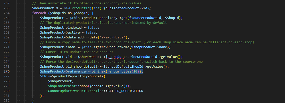

Andrei H Posted June 8, 2025 Share Posted June 8, 2025 Hello, In PrestaShop 8 you can edit the following file: src/Adapter/Product/Update/ProductDuplicator.php And on line 275 add a new empty line (do not delete the old one, just insert a new line - see screenshot below). The code placed on the new line should be something similar to: $shopProduct->reference = bin2hex(random_bytes(10)); The above will generate a random string of 10 characters, thus making sure the reference will not collide with the old one. Link to comment Share on other sites More sharing options...

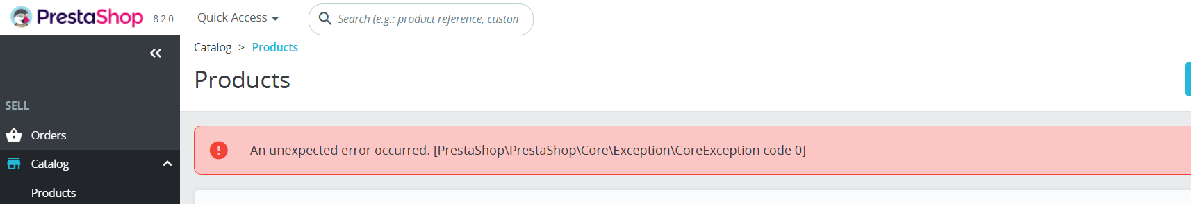

dario68 Posted June 8, 2025 Share Posted June 8, 2025 Andrei thank you so much. Your solution works fine without UNIQUE in the 'reference' column in ps_product table but if the 'reference' column has UNIQUE index when trying to Duplicate product I receive this error: An unexpected error occurred. [PrestaShop\PrestaShop\Core\Exception\CoreException code 0] Link to comment Share on other sites More sharing options...

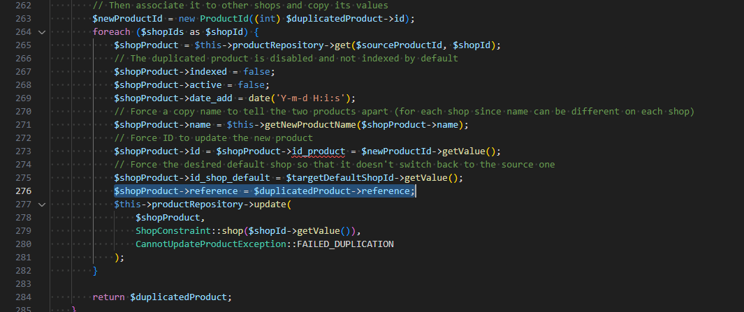

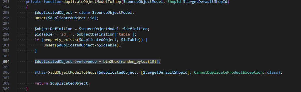

Andrei H Posted June 8, 2025 Share Posted June 8, 2025 (edited) Hello, Thank you for pointing that out. I haven't tested with the UNIQUE constraint, because I thought it should work, but it looks like the product was saved once more before that line. Here is the correct solution: On the line 275 above, add the following: $shopProduct->reference = $duplicatedProduct->reference; Also, on line 304 - old line 303, insert a new line and add the following: $duplicatedObject->reference = bin2hex(random_bytes(10)); With these two changes, things should be working as expected. I added two screenshots that also highlight where the code should be placed. Edited June 8, 2025 by Andrei H (see edit history) Link to comment Share on other sites More sharing options...
dario68 Posted June 8, 2025 Share Posted June 8, 2025 Thank you very very much Andrei Now it works perfectly! 1 Link to comment Share on other sites More sharing options...
