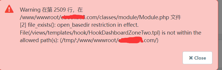

Puriom Posted February 14, 2022 Share Posted February 14, 2022 Hello! My about 10th PS installation among last years, first time such a message in completely fresh install: Quote Warning on line 2509 in file /var/www/vhosts/MY X SITE.link/classes/module/Module.php [2] file_exists(): open_basedir restriction in effect. File(/views/templates/hook/HookDashboardZoneTwo.tpl) is not within the allowed path(s): (/var/www/vhosts/MY X SITE.link/:/tmp/) It came after a fatal error when installing "PrestaShop Account" module, which gave a fatal error (500) and I had to rename modules/ps_accounts. That brought back the backoffice but with the above issue. I have Php v7.4.27 I added Lets Encrypt just to be able to see the site (is there any other way?) and the only other modules I have are the few basics (p.e. 1click, etc). I used Plesk automatic installation and I updated it with 1-click update. (I found this but I cannot use it.https://github.com/PrestaShop/PrestaShop/issues/26783 These are my 2504-2512 lines } if (!isset($this->current_subtemplate[$template . '_' . $cache_id . '_' . $compile_id])) { if (false === strpos($template, 'module:') && !file_exists(_PS_ROOT_DIR_ . '/' . $template) && !file_exists($template) ) { $template = $this->getTemplatePath($template); } How it should be?) Thank you for any Kind help Link to comment Share on other sites More sharing options...

MarioCM Posted March 3, 2022 Share Posted March 3, 2022 I have the same warning on 1.7.8.3 (php 7.4) I have tried a new clean installation and the same warning happens to me with the debugging mode activated. 🤔 It seems as if it does not redirect well in the hosting subdomain. Any ideas?🙄 Link to comment Share on other sites More sharing options...
Puriom Posted March 3, 2022 Author Share Posted March 3, 2022 14 minutes ago, MarioCM said: I have the same warning on 1.7.8.3 (php 7.4) I have tried a new clean installation and the same warning happens to me with the debugging mode activated. 🤔 It seems as if it does not redirect well in the hosting subdomain. Any ideas?🙄 Hello. Via FTP of File Manager find this file: MY X SITE.link/classes/module/Module.php on line 2509, replace the lines there with what you see below (as written in the link above - which worked for me): protected function getCurrentSubTemplate($template, $cache_id = null, $compile_id = null) { if ($compile_id === null) { $compile_id = $this->getDefaultCompileId(); } if (!isset($this->current_subtemplate[$template . '_' . $cache_id . '_' . $compile_id])) { if (false === strpos($template, 'module:') && !file_exists(_PS_ROOT_DIR_ . '/' . $template) && !file_exists(_PS_ROOT_DIR_ . $template) ) { $template = $this->getTemplatePath($template); } $this->current_subtemplate[$template . '_' . $cache_id . '_' . $compile_id] = $this->context->smarty->createTemplate( $template, $cache_id, $compile_id, $this->smarty ); } return $this->current_subtemplate[$template . '_' . $cache_id . '_' . $compile_id]; }` 2 2 Link to comment Share on other sites More sharing options...
MarioCM Posted March 4, 2022 Share Posted March 4, 2022 OOk, thanks! Works fine for me too 🤗 Link to comment Share on other sites More sharing options...

user8139 Posted November 17, 2022 Share Posted November 17, 2022 I'll change line 2509 to ! file_exists(_PS_ROOT_DIR_ . $template) The problem remains unresolved Please help me, thank you Link to comment Share on other sites More sharing options...
