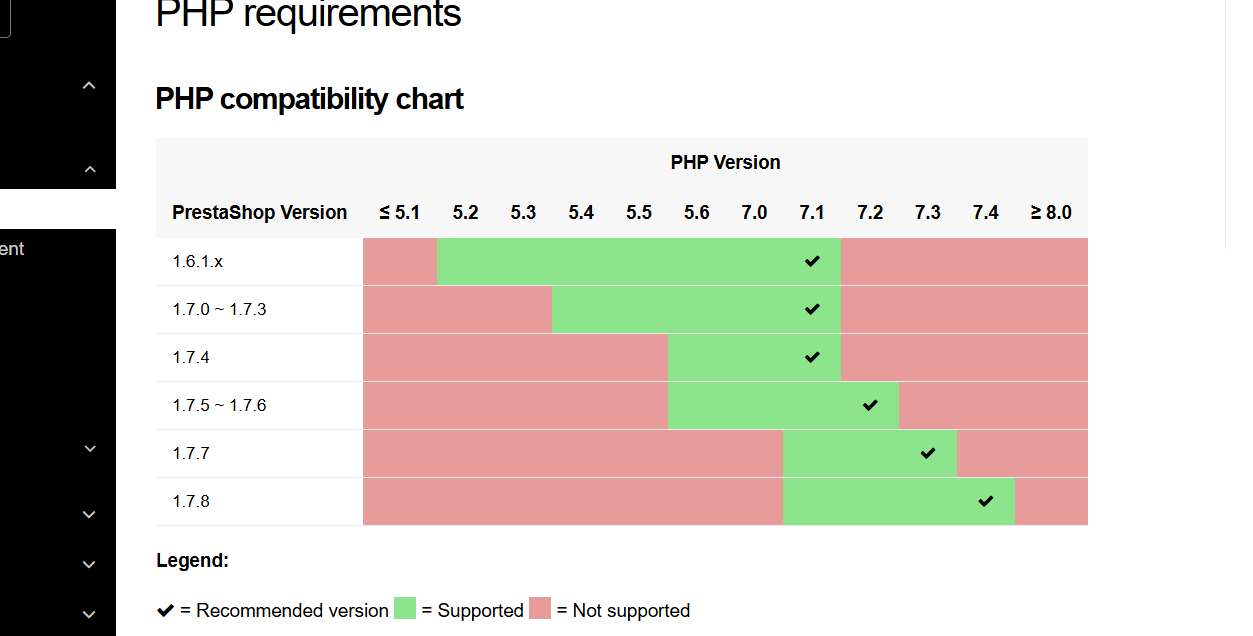

Sarasys Posted June 3, 2021 Share Posted June 3, 2021 Hi, friends Is anyone here using version 7.2 PHP on Prestashop 1.6.1.24? For some reason I needed to upgrade my PHP version from 7.1 to 7.2 and there was no problem although I know this version of PrestaShop supports PHP version 7.1. Do you think this will be a problem for my store later? Link to comment Share on other sites More sharing options...

A Bit of Home Posted May 9, 2024 Share Posted May 9, 2024 I have run into a problem running PHP 7.2 on my PS 1.6.1.24 store. Trying to access the CMS pages from admin for editing returns a HTTP 500 error. No problem on PHP 7.1. I wanted to upgrade the PHP version so I can install PS v8 in a subdomain to develop as a replacement for the old store. Sadly PS v8 is not supported on PHP 7.1 so I am kind of stuck as to what to do. Link to comment Share on other sites More sharing options...
Satu Keihonen Posted May 14, 2024 Share Posted May 14, 2024 On 5/9/2024 at 3:08 PM, A Bit of Home said: I have run into a problem running PHP 7.2 on my PS 1.6.1.24 store. Trying to access the CMS pages from admin for editing returns a HTTP 500 error. No problem on PHP 7.1. I wanted to upgrade the PHP version so I can install PS v8 in a subdomain to develop as a replacement for the old store. Sadly PS v8 is not supported on PHP 7.1 so I am kind of stuck as to what to do. I tried to upgrade my PS 1.6.1.24 to 1.7.8.11 and the Softaculous says: "PHP version is less than the required 7.2.0 Do you wish to enable PHP 7.2.34 ? (Might cause issues with your existing installations)." And with that enabled, the backoffice login disappeared totally! Had to get back with 1.6.1.24 with PHP 7.1 - that works fine. Just wondering how on earth am I able to upgrade my PS in order to have the chance to build up the new store alongside with the old one... Link to comment Share on other sites More sharing options...
KB_new Posted February 25, 2025 Share Posted February 25, 2025 (edited) On 5/14/2024 at 6:32 PM, Satu Keihonen said: I tried to upgrade my PS 1.6.1.24 to 1.7.8.11 and the Softaculous says: "PHP version is less than the required 7.2.0 Do you wish to enable PHP 7.2.34 ? (Might cause issues with your existing installations)." And with that enabled, the backoffice login disappeared totally! Had to get back with 1.6.1.24 with PHP 7.1 - that works fine. Just wondering how on earth am I able to upgrade my PS in order to have the chance to build up the new store alongside with the old one... Hi @A Bit of Home I have the same situation. how did you solve your problem? Regards Edited February 25, 2025 by KB_new (see edit history) Link to comment Share on other sites More sharing options...
Knowband Plugins Posted February 25, 2025 Share Posted February 25, 2025 Don't directly upgrade the store PS1.6 to PS1.7.8. Do it the parts. First: Using PHP5.6, Upgrade to PS1.7.6 Then change the PHP version to 7.2 and upgrade from 1.7.6 to 1.7.8 Link to comment Share on other sites More sharing options...
