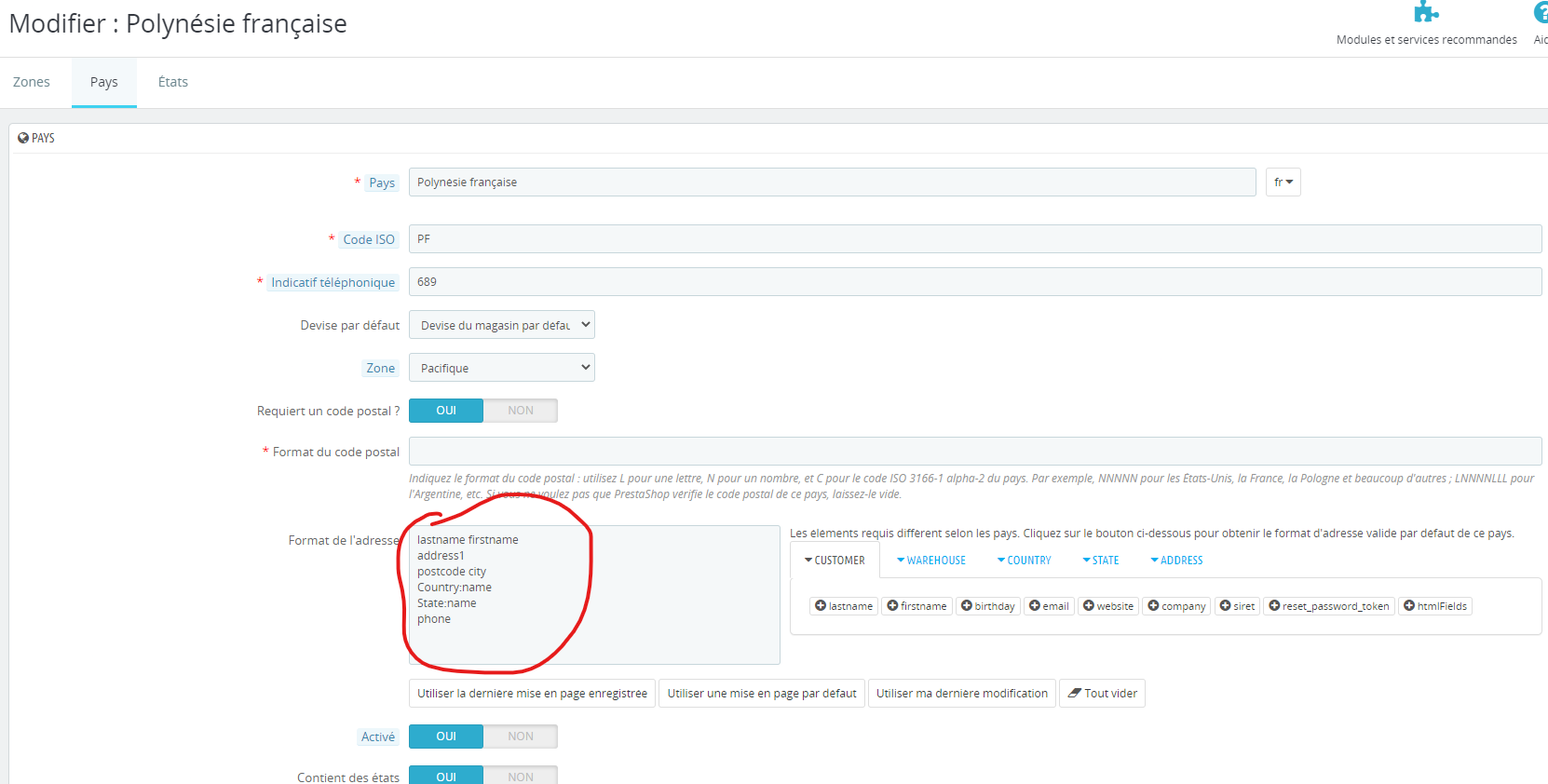

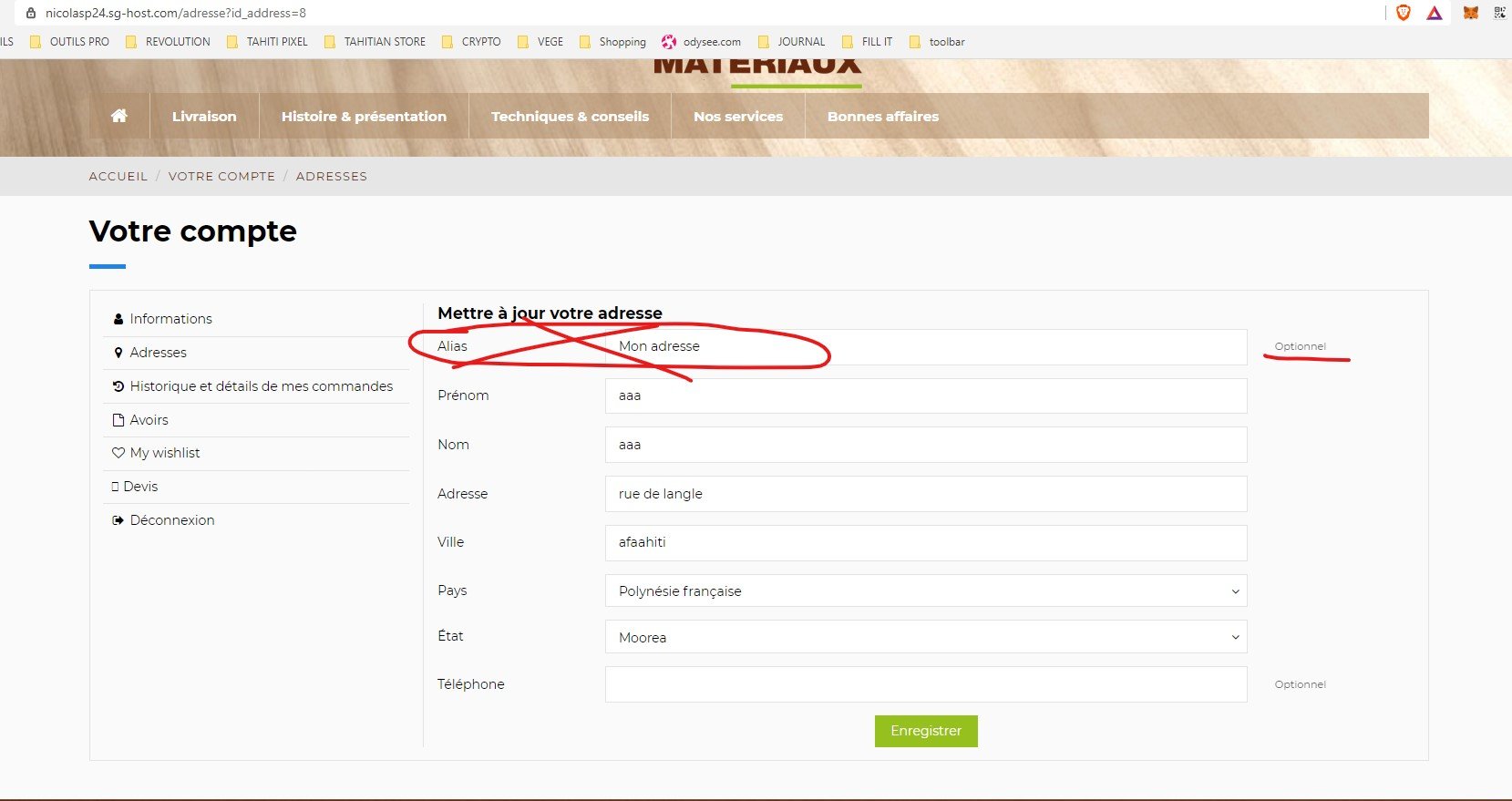

toimata Posted May 21, 2021 Share Posted May 21, 2021 Hello, How can i remove "alias" field (wich is optional) on the front customer address form ? i can't find it on the location / country pay in backoffice page Thanks cheers, Link to comment Share on other sites More sharing options...

toimata Posted May 27, 2021 Author Share Posted May 27, 2021 Hi, Thanks a lot for your answer. Isn't there a simple way to do it from backoffice ? Why this field is not visible in the country settings with other fields ? Link to comment Share on other sites More sharing options...
w3bsolutions Posted May 27, 2021 Share Posted May 27, 2021 You can do it from the back office installing this module to add custom CSS: https://www.sunnytoo.com/download/10901/ and then in the module configuration paste the code I gave you above. This is more of a technical field so the customer can give a name to each address in order to distinguish them better (for example "Home", "Work", etc), it is not address-related field, that is why it is not in the country configuration. Link to comment Share on other sites More sharing options...

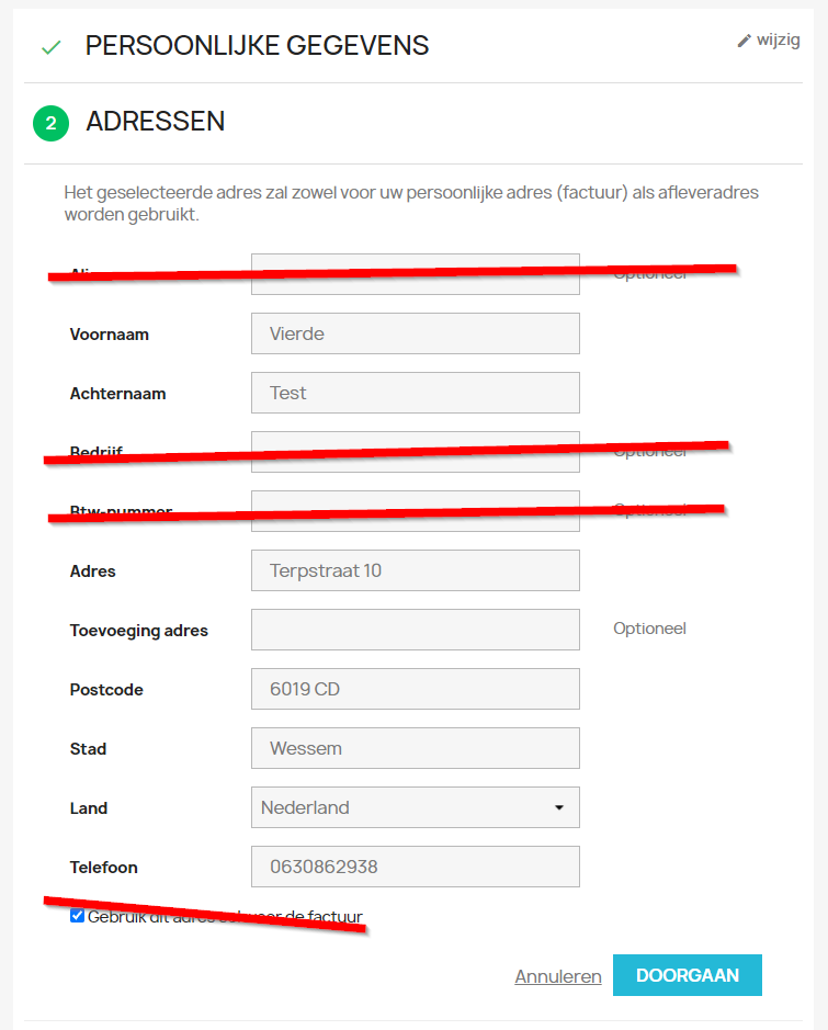

ConH Posted November 1, 2021 Share Posted November 1, 2021 (edited) On 5/26/2021 at 1:19 AM, w3bsolutions said: As long as its the first field in the form (which it is, unless you specifically change it), you can just hide it via CSS: .address-form .form-group:first-of-type { display: none; } Sorry to steal this topic, but I am after the same thing. I did install the CSS module like you suggested and added the code to the first "Custom CSS Code" field. Nothing seems to happen though. Also I would like to hide the company an VAT fields. How do I go about that? Found that one already, but: Equally the tickbox for "use this address for the invoice too" needs to go. Edited November 1, 2021 by ConH (see edit history) Link to comment Share on other sites More sharing options...
