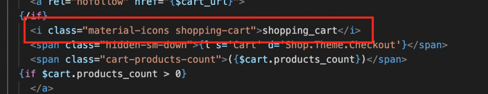

gmasso Posted July 21, 2020 Share Posted July 21, 2020 Hi! I want to replace the default icon that comes with the shopping cart module in the classic theme with an icon of my own. My guess is that I should modify something in the ps_shoppingcart.tpl file, but I don't really understand how images work in .tpl files. I attach a screenshot of the icon I want to replace and another with the line of code where I guess the icon is being set. Link to comment Share on other sites More sharing options...
Knowband Plugins Posted July 22, 2020 Share Posted July 22, 2020 These are the CSS Icons. You can either directly replace highlighted HTML with the img src tag & add own img link in the src tag. Using the highlighted method, You can only use the icons which are predefined. Your theme is using the material icons. The list of material icons can be found on the URL below.https://material.io/resources/icons/?style=baseline You need to replace the "shopping-cart" (As you mentioned on the highlighted section), with the text defined in the above URL for icons. Like replace "shopping-cart" with "shopping_bag" to replace the icons as shown in the screenshot below.https://prnt.sc/tmdooi Link to comment Share on other sites More sharing options...

Andriano Posted August 1, 2020 Share Posted August 1, 2020 Replace <i></i> by <img src="folder/myicon.png" alt=""> in tpl. To disable the tag <i></i> don't delet it, just comment it with tag <!-- -->(See html doc firefox). Don't forgot to put the complete url of your icon image(example "http://mywebsite/folder/icon.png"). You can put a custom image with FTP transfer and you can create custom folder. Link to comment Share on other sites More sharing options...

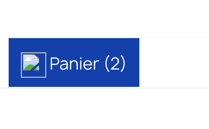

artistik Posted June 10, 2024 Share Posted June 10, 2024 hello I try again and didn't work but seems better I don't know what s going on . Maybe it is because i modify on child theme and not on parent theme? I try to clear my cache and i have this appears after in private nav Here is code i modify : $cart.products_count] d='Shop.Theme.Checkout'}" href="{$cart_url}"> {/if} <img src="https://152..../themes/child_classic/modules/ps_shoppingcart/shopping-cart.png alt="shopping-cart" width="25" height="25"> <span class="hidden-sm-down">{l s='Cart' d='Shop.Theme.Checkout'}</span> can someone tell me more Link to comment Share on other sites More sharing options...
Andrei H Posted June 13, 2024 Share Posted June 13, 2024 Hi @artistik, Sorry for the delay. You usually get that broken icon when the browser cannot find the image at the specified location. If you manually open the link from the src attribute, does that display the image? Link to comment Share on other sites More sharing options...
