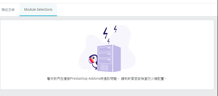

Kenneth Chan Posted June 13, 2020 Share Posted June 13, 2020 When I go to "Payment Method" of the admin panel. It show error when call recommend url. It is a 503 error in my server. but It seem not able to connect to add-on server of Prestshop. the url will be called /admin389jj7ozu/index.php/modules/addons/modules/recommended?tabClassName=AdminPayment&_token=xxx if I see the log. It show "Data from PrestaShop Addons is invalid, and cannot fallback on cache." Link to comment Share on other sites More sharing options...
Matt75 Posted June 13, 2020 Share Posted June 13, 2020 Hi, Can you provide additional information about your issue ? PrestaShop version (BO > Advanced Parameters > Information) PHP version (BO > Advanced Parameters > Information) MBO module version (BO > Modules > Module Manager > Search ps_mbo) Screenshot or video capture of the issue Additional errors logs in your FTP (PrestaShop directory > var/logs) Thanks Link to comment Share on other sites More sharing options...

Kenneth Chan Posted June 13, 2020 Author Share Posted June 13, 2020 1 hour ago, Matt75 said: I need additional information to check if module need a patch or not. Screenshot or video capture of the issue Additional errors logs in your FTP (PrestaShop directory > var/logs) Thanks I finally found the reason. ExternalContentProvider set the timeout is 0.6 second. but It is not enough. Link to comment Share on other sites More sharing options...
