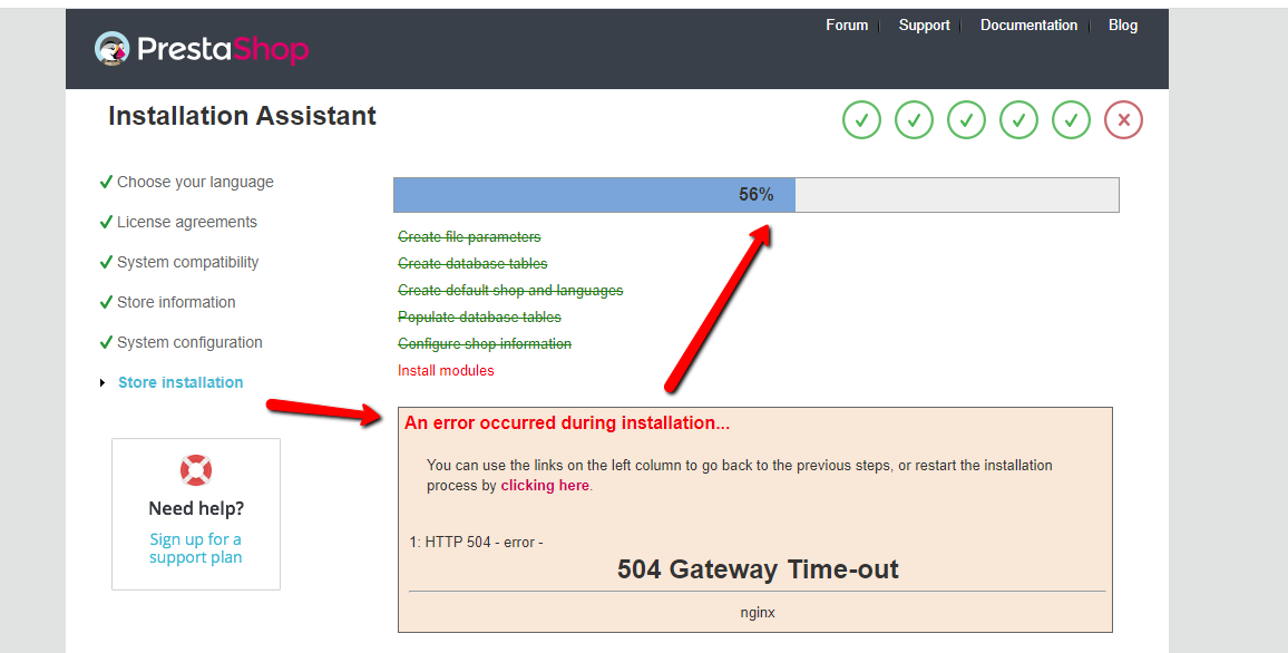

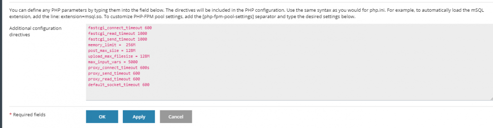

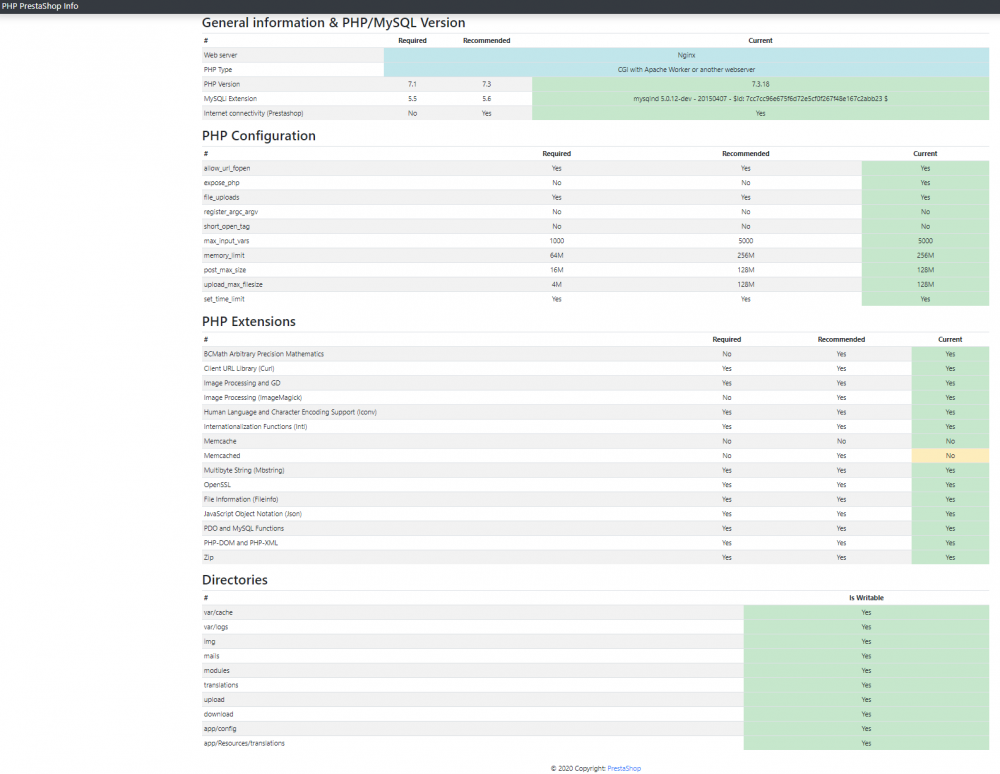

kibiribi Posted May 24, 2020 Share Posted May 24, 2020 I've got a dedicated server configuration test script told me - it's ok - see atached screenshot Nginx options were increased, but the last step of installation stopped with with error: 1: "HTTP 504 - error - 504 Gateway Time-out" Could you help any workaround how to finish installation? 😞 ----------- fastcgi_connect_timeout 600 fastcgi_read_timeout 1000 fastcgi_send_timeout 1000 memory_limit = 256M post_max_size = 128M upload_max_filesize = 128M max_input_vars = 5000 proxy_connect_timeout 600s proxy_send_timeout 600 proxy_read_timeout 600 default_socket_timeout 600 -------------- Link to comment Share on other sites More sharing options...
kibiribi Posted May 24, 2020 Author Share Posted May 24, 2020 I tried to set max_input_vars = 1000 - it didn't help me. On the module installation step after 2 min 50 sec. installation was stopped itself with 504 error. "504 Gateway Time-out " Link to comment Share on other sites More sharing options...
kibiribi Posted May 24, 2020 Author Share Posted May 24, 2020 it's not possible to finish installation on the same server for ver. 1.7.6.4 all the same error = 504 time-out Link to comment Share on other sites More sharing options...
kibiribi Posted May 24, 2020 Author Share Posted May 24, 2020 On the same server I was able to install version 1.7.6.1 without problem. Could anybody indicates what's important changes were done in new versions according to installation process? Link to comment Share on other sites More sharing options...

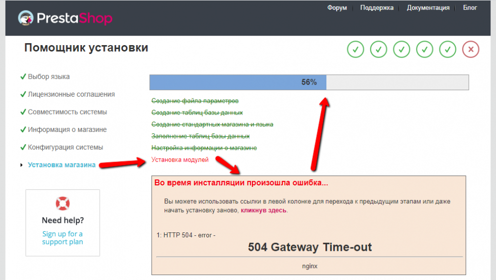

kibiribi Posted May 24, 2020 Author Share Posted May 24, 2020 for ver.1.7.6.5. tried to install with English language - error the same - it stopped on Modules installation step. Link to comment Share on other sites More sharing options...
Guest Posted May 24, 2020 Share Posted May 24, 2020 Do you know how to install new versions of Prestashop? Only prestashop.zip and index.php for FTP upload Clear the browser cache. Link to comment Share on other sites More sharing options...
kibiribi Posted May 24, 2020 Author Share Posted May 24, 2020 5 minutes ago, Guest said: Read changelog https://www.prestashop.com/en/previous-versions Thanks for advice! I read it but it didn't help me: ---------------- 1.7.6.5 - Installer: - Bug fix: - #18491: Installation under CLI doesn't take BASE_URI and Apache rewrite in consideration (by @PierreRambaud) - #18451: Use scandir instead of readdir to get sorted entities (by @PierreRambaud) 1.7.6.4 nothing about installer 1.7.6.3 - Installer: - Bug fix: - #14620: Init properly the Kernel on major *manual* upgrades (by @Quetzacoalt91) - #14739: Keep Composer.lock file in release (by @jolelievre) 1.7.6.2 nothing about installer Link to comment Share on other sites More sharing options...
kibiribi Posted May 24, 2020 Author Share Posted May 24, 2020 1 minute ago, Guest said: Do you know how to install new versions of Prestashop? Only prestashop.zip and index.php for FTP upload Clear the browser cache. Sure, I did the same - 2 files in folder - zip and index. Unpacking goes smoothly. All according to Manual. I've changed just for test max_execution_time = 3600. But after every installation process was stopped on 2:50 - this is parameter does not affect installations 😞 Link to comment Share on other sites More sharing options...
kibiribi Posted May 24, 2020 Author Share Posted May 24, 2020 23 minutes ago, Guest said: Clear the browser cache. Honestly... I would never have thought of clearing the cache :-) Installation finished without problem ! Thanks again for your advice! It's not clear for me which way caching method stops installation? :-( The request is closed. Link to comment Share on other sites More sharing options...
